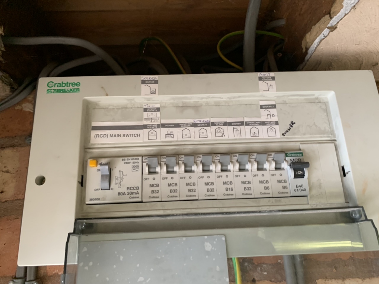

This is the current board, does it need upgrading to 18th edition? Only box of mine I’ve seen without an actual main switch
There is confusion and uncertainty as regards interpretation of the new legislation. Some might well claim that that CU needs 'upgrading', not the least because it has only one RCD. The RCD (far left serves as a 'main switch' - and there;'s nothing wrong with that, per se.

RCD as a main switch is a hazard because it will cut out the lights in the event of a fault on another circuit.
It may be easier to mitigate that risk (and a good idea anyway) to put a couple of emergency lights on the stairs and in the kitchen.
Indeed - but that's a consequence of their being only one RCD, covering all circuits, not because it's being used as the 'main switch', per se - the problem would be the same if there were a main switch as well as one RCD covering all circuits.
Very much so. As I say so often, no matter how many RCDs one spreads one's circuits over (or, as the 'ultimate', having all RCBOs), that will provide no protection against being plunged into darkness by a power cut (and, as I always say, for me power cuts are far more common than RCD trips!).

The problem with an EICR (electrical installation condition report) it is up to the inspector if he gives a C1, C2, C3, or F1, most houses will gets loads of C3 items, this points out what would need to be done to make the home fully comply, but there is no requirement to get them fixed, with a C1 you would not want to ignore, it means the house is dangerous, F1 is further investigation, can't think off hand why it would be issued, maybe a locked door?
So the main bone of contention is the C2. It says this should be issued if the item is 'potentially dangerous' well all 230 volt electric is potentially dangerous, so we use sights like the electrical safety council and their best practice guide 4 issue 5 to guide us as to what should be considered as potentially dangerous.
The second is what should an electrician consider in his inspection, he is not trained in fire prevention and safety yet many electrical items can cause fire, the building regulations define electrical installation as all fixed electrical items, which is fair enough, but looking at the extreme, if you were letting out a stone cottage on a hill side in Wales with no electric just oil lamps etc, as built 200 years ago, an electrician could not fail it because there is nothing electric, but it may be considered as uninhabitable, but it would not be the electrician who gives it that label, so how can lack of mains powered smoke detectors be part of electricians remit?
However not to point out dangers is also wrong, but not looking at danger, looking at what should gain a C2 in an EICR and what is down to some one else. So back to start, some one has to have taken the exam and has to take the responsibility for the home being habitable, and likely that will be a letting agent, so see what they say first.
Some insist that the consumer unit complies with new build standards under 18th edition. But this is not the law, it's what that letting agent wants.

I agree with what @JohnW2 says, but did not really want to get into what should and should not be tested by the electrician. But just to point out at the moment there is a lot of disagreement as to what gets a C2.
The CU you show is likely to be considered as unacceptable, personally if it has not been tripping out on regular basics then it is clearly OK, but again any electrician testing does not know if it does or does not trip often.
Fitting an Isolator, SPD and all RCBO's would mean the tripping problem is no longer there, but a RCBO will cost £30 each, so £270 to swap all, at that one has to ask is it worth in, as still left with a plastic box?
It is pointless anyone saying that CU is OK, if you need to use letting agents that will not accept it. There is no reason why when you ask some one to do an EICR you ask before they start will they consider a plastic consumer unit with a single RCD as being acceptable. On table 53.2 of BS7671:2008 BS EN 61008-1 is listed as suitable for isolation, emergency switching and functional switching so I see no problem using one as the isolator.
The only thing in that picture which 'could' result in an unsatsifactory outcome is how that later crabtree MCB has been fitted, I'm not totally familar with crabtree but I'm pretty sure those ranges arn't compatable, I'd like to see how its been fitted.
Plastic board gets a C3 if on escape route/under stairs etc, otherwise noted by no code allocated
A single RCD covering all circuits gets a C3 at worst, often just noted with no code
Of course there could be many other faults which are not in the picture and/or cannot be conveyed with a picture
Not many people are constrained to use any particular letting agent, so if landlords were sensible (and knowledgeable) enough to stop using ones who had 'unreasonable' requirements, then the behaviour of letting agents might change.
Indeed. You or I, or many of the others reading this, could quiz an electrician before asking him/her to undertake an EICR, in relation to some of those things that we feared some might code as C2 when we personally didn't feel that they should - and then select our inspector accordingly. However, few of the general public (including landlords) would have enough knowledge to do that.
.. On table 53.2 of BS7671:2008 BS EN 61008-1 is listed as suitable for isolation, emergency switching and functional switching so I see no problem using one as the isolator.
Indeed - so I don't think anyone could (should) give a C2 because the only means of whole installation isolatioon was an RCD. However, OwainDIYer's point was not about that but, rather, related to the fact that some people (I thought including you) would say that having a single RCD protecting the entire installation (inevitable if an RCD is being used as the incomer) was 'non-compliant'.
