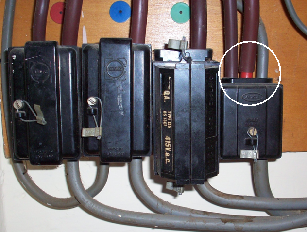

Why? The grey outer is not made to be insulation, rather it was mechanical protection, so the grey needed to be stripped back clear of the insulation/voltage carrying conductor.
Current guidelines say that unsheathed conductors exposed outside an enclosure are a C2.
On something like a meter or a henly block, there often isn't really enough room to strip the sheath back "clear of the conductor" while still making sure it is definitively "inside" the enclosure. Also I can see the DNOs and suppliers finding it desirable to be able to visually inspect without having to remove covers.
.... Also I can see the DNOs and suppliers finding it desirable to be able to visually inspect without having to remove covers.
...particularly if there is some incorrectly-coloured insulation to 'inspect', as in this neutral block at the origin of my installation (the 'sin' now obscured with grey silicone by a subsequent mater-changer) :) ...
