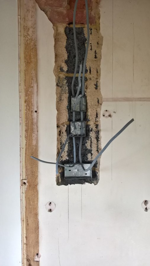

Guys,
I thought it would be helpful to send you a picture of my first fix. I appreciate that the double socket may not be required. Presumably, the other two can connect into the FCU shown in the picture?

You can use what you have, it's just totally over the top for a 3A boiler and an immersion heater which will seldom be used.

is a switched fuse spur the same as a fused connection unit? If yes, as per picture, I have two of them along with a double socket.
