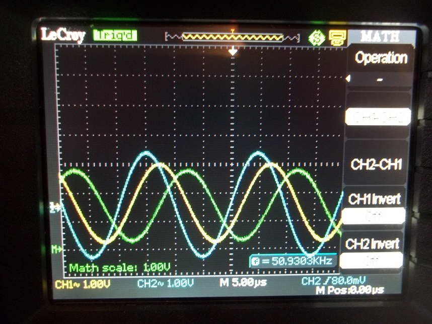

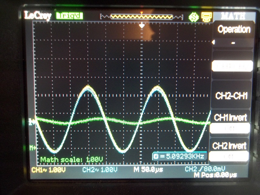

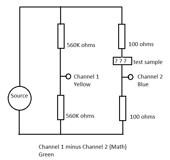

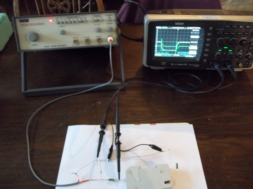

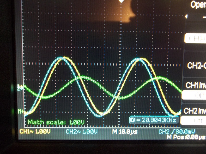

Some tests on the impedance of a Wylex B20 MCB using a Wheatstone Bridge circuit
Circuit
If the impedance of the sample is zero ohms then the bridge balances and the voltage at Channel 2 is the same as the voltage at Channel 1
If the sample has a simple impedance ( resistive ) then Channel 1 will be greater than Channel 2 but without phase shift.
If the sample has a complex impedance then there will be phase shifts as well as voltage differences.
The tests were without any load current through the MCB.
If the impedance is zero then the green trace ( Channel 1 minus Channel 2 ) will be a flat line.
At 50 Hz the green trace shows a very small difference which can be explained by the tolerances of the resistor values used in this set up and the resistive impedance of the MCB's coil ( magnetic trip ) and heating element ( thermal trip ).
At 5 kHz sine wave
At 20 kHz sine wave
At 50 kHz sine wave
and square waves got complicated
so I didn't bother to go further.
Enough to suggest that the MCB is an active impedance to high frequency components in the wave form of the mains supply current passing through the MCB
