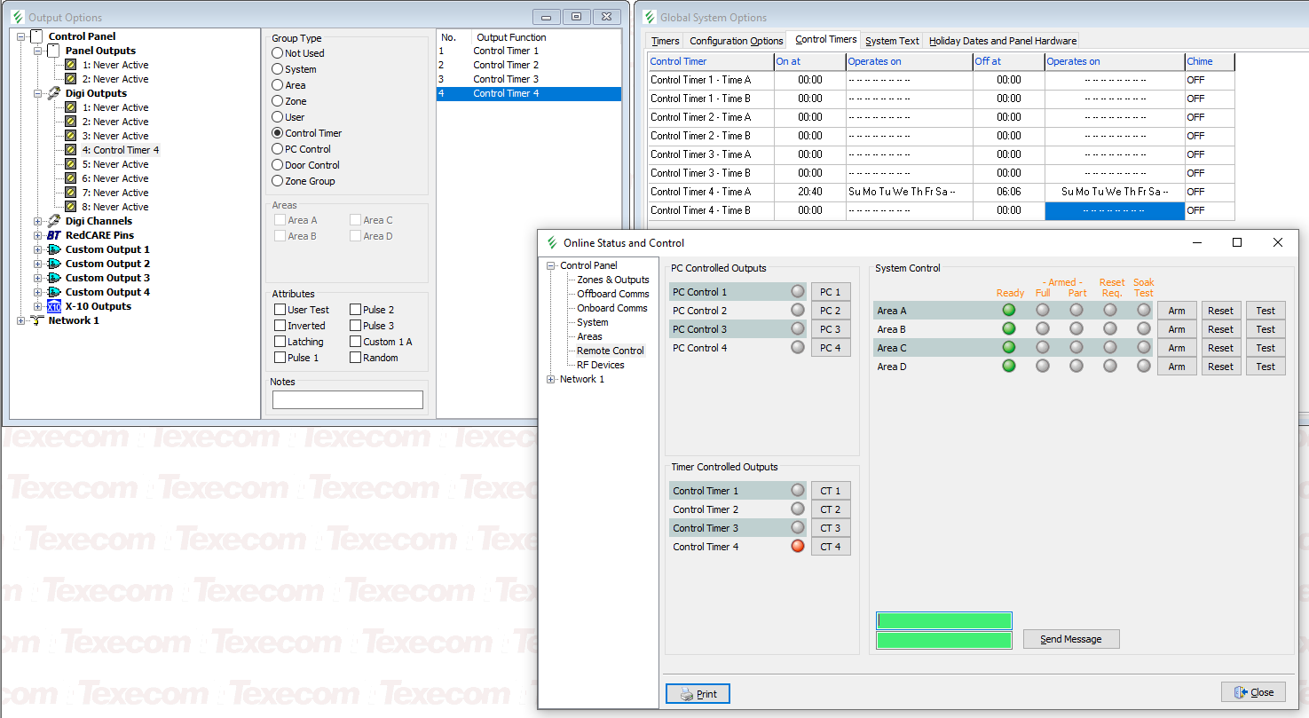

Ok heres the thing. ive made Notes. No matter what programing i do, Digi terminal will not switch off at any time... digi terminal is constant +12v , not inverted. (manual states switched 0v. PG 34 premiere elite manual)
it only switches to 0v when i invert.. which the inverting works gents.. once inverted black probe on digi 4 and red probe on 12v and a reading of 12.8v.
Update,
Penny may have dropped FFS .. ive wired the Odyssey LED 0v wire to digi 4, (i was in the process of doing when i was last testing).. can i ask.. do the outputs "Invert" rather than switch off and on?
so when i have a reading of 12v at digi terminal its off, when it has 0v its on?

it seems to be doing as it should now its wired.( ive set a couple more parameters to test) maybe i over confused the whole matter with my multi meter, i must admit it was starting to really gripe at me.. well fingers crossed..

In wintex you should be able to see the output switching states when the condition is met.
The led strip needs to see 12V.
At default the back light is wired one end to 12V other to 0V.
when you swap for the output on one of the legs you must make the 12V end 12V for it to come on and so on.
yes mate.. i understand completly.. ive removed the 0v leg from the led strip.. Joined with a terminal block to a spare core back to the panel , then terminated to Digi4.
found the switching states you mentiond.. shows a REd dot when active, also found a manual switch.. works like a dream.
Click CT4, is that what that is...

And i asked the question.. do the outputs invert, rather than "off and on" ..
ive tested this and it is the case, so when the digi terminal is on its -V and when its off its +V . vice versa when inverted Obviously
this is what was throwing me with the tester.
i assumed it should be off but instead i was getting +V hence me thinking there was an issue.. i fully understand now, in hindsight i should of just connected the damn LED up..

You can make them work round which way you want, inverting the output makes it work in the opposite direction.
Its a quick way to test its wired up correctly, ie invert the output does it do what you expect, oput it back does it do what you expect.
Then you only have to worry about the programming.
