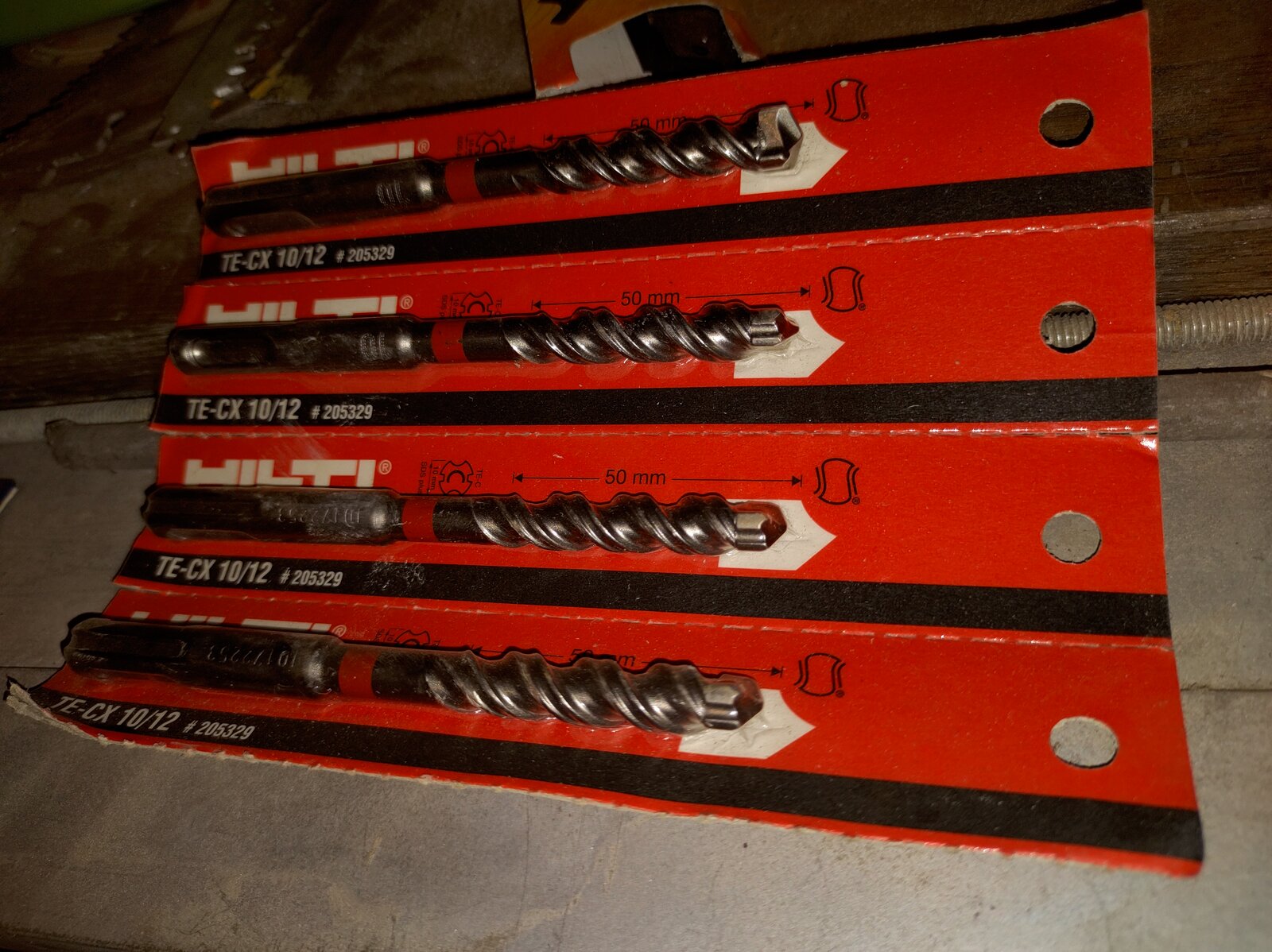

That's interesting, I've been looking at the makita nemesis 4 flute bits which seem to have a good reputation. @JobAndKnock was talking specifically about Hilti sds bits (sds max?) going through rebar, I imagine the carbide tips are of the highest quality and form a single piece welded onto the end of the drill.
Blup
Blup
I have two sets of the Nemesis bits (SDS+) and have been very happy with them. I have never tried the Hilti ones though.
The tips are indeed one piece, see
You can sometimes pick-up Hilti SDS bits on eBay. They are good, but I'm not certain they are worth the money at Hilti official prices
Looking at my Heller Tri-Jet 3-flute bits, they are also a one piece tip. All the 3- and 4-flute bits I've tried to date drill faster than 2-flute bits.
I've got some Hilti bits, I was slightly disappointed with them when drilling Accrington's - despite not forcing them they were prone to overheating - I'd pull it out and there'd be no tip left - just a melted stump - maybe they're better suited to concrete.
I'd talk to the Hilti rep about whether or not those were designed for concrete alone (I know some of the SDS Max bits are materials specific).

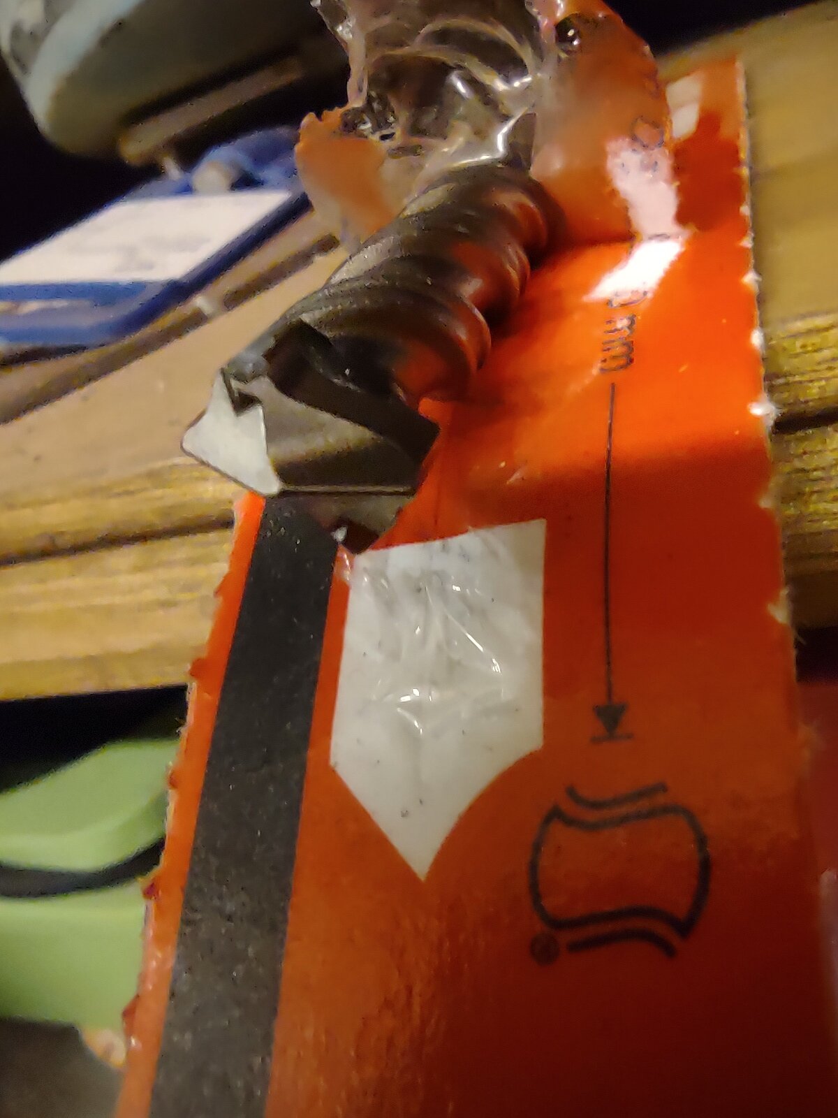

Last time I did Noris I used a 2-flute Bosch Professional bit, and I did have to keep pulling the bit out to clear it. Maybe the material density affects the useability of the multi flute bits? The one in the sevond photo certainly doesn't look anything like the last Hilti 2-flutes I had, or the 4-flutes I mentioned earlier
