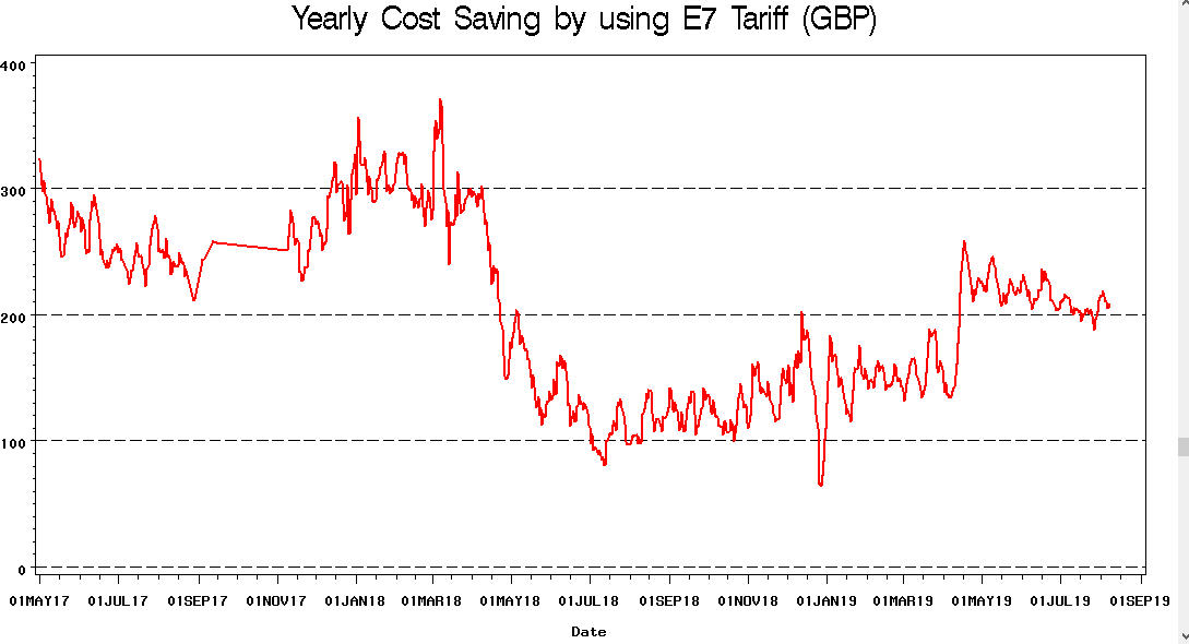

As I've said a number of times recently, the benefit of E7 (which I have, even though I do not have storage heaters) is sinking fast. For many years up until a year or two ago, the day:night cost ratio was fairly constant at about 2.5:1 but things have changed rapidly in recent times, and one is now lucky to get 1.5:1.
The following shows the situation here. The modest improvement in April of this year was due to a change of supplier. As you can see, E7 is still worthwhile for me, but less so than in the past, and I suspect that the benefit is going to continue to reduce (and may even 'reverse {cheaper electricity during daylight hours!} if large-scale EV take-up ever happens) ..
Kind Regards, John
