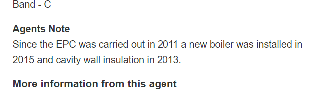

For even more stupidity, look at the agents note on this property for sale: http://www.rightmove.co.uk/property-for-sale/property-41515974.html
