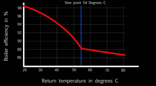

My room stat will call for heat until it's set temperature is reached. Reducing the water temperature in the radiators will mean the heating will be on for longer so no net saving. Am I missing something here. Are the laws of thermodynamics different for some systems?
Resistant perhaps but still succumb to acidic condensate Hence on average 10-12 year life expectancy for alloy heat exchangersIn that case, you shouldn't run the boiler at low temperature. Doing so can cause the flue gases to condense, and because they are acidic, they can corrode your heat exchanger. On newer boilers, the heat exchangers are made from metals which are resistant to the acidic condensate.
Yep aluminium heat exchangers are renowned for blocking up condense traps and pipe workResistant perhaps but still succumb to acidic condensate Hence on average 10-12 year life expectancy for alloy heat exchangers

The advice is to reduce HW temperature of combi boilers. Nothing to do with CH temp.May be this would be better suited to the gas and heating forum but I thought I'd stick it here instead. Can someone explain how turning down the circulation water temperature on my system will save me money. My room stat will call for heat until it's set temperature is reached. Reducing the water temperature in the radiators will mean the heating will be on for longer so no net saving. Am I missing something here. Are the laws of thermodynamics different for some systems?
