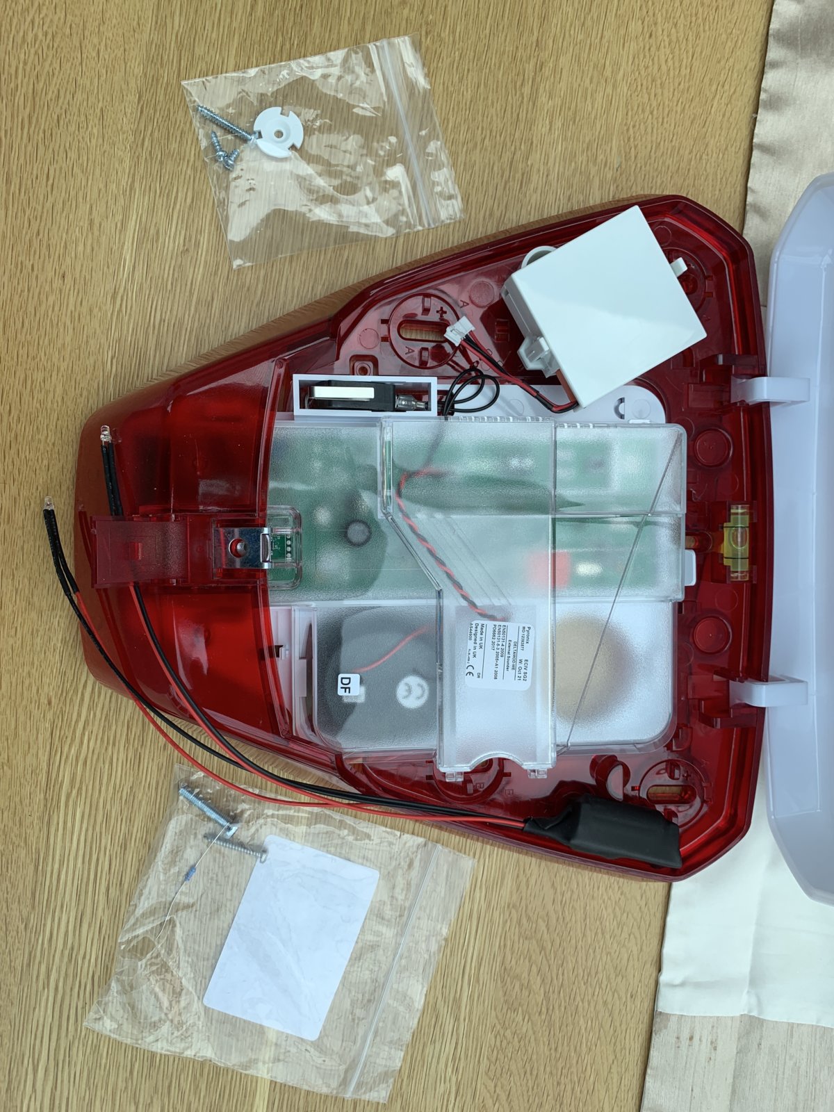

Hi
Hopefully the final stupid question
please see image below - I haven’t drilled any holes yet or put the battery in to the main board - but is this how it should look?
should the main board be screwed in somehow? And is it aligned correctly?

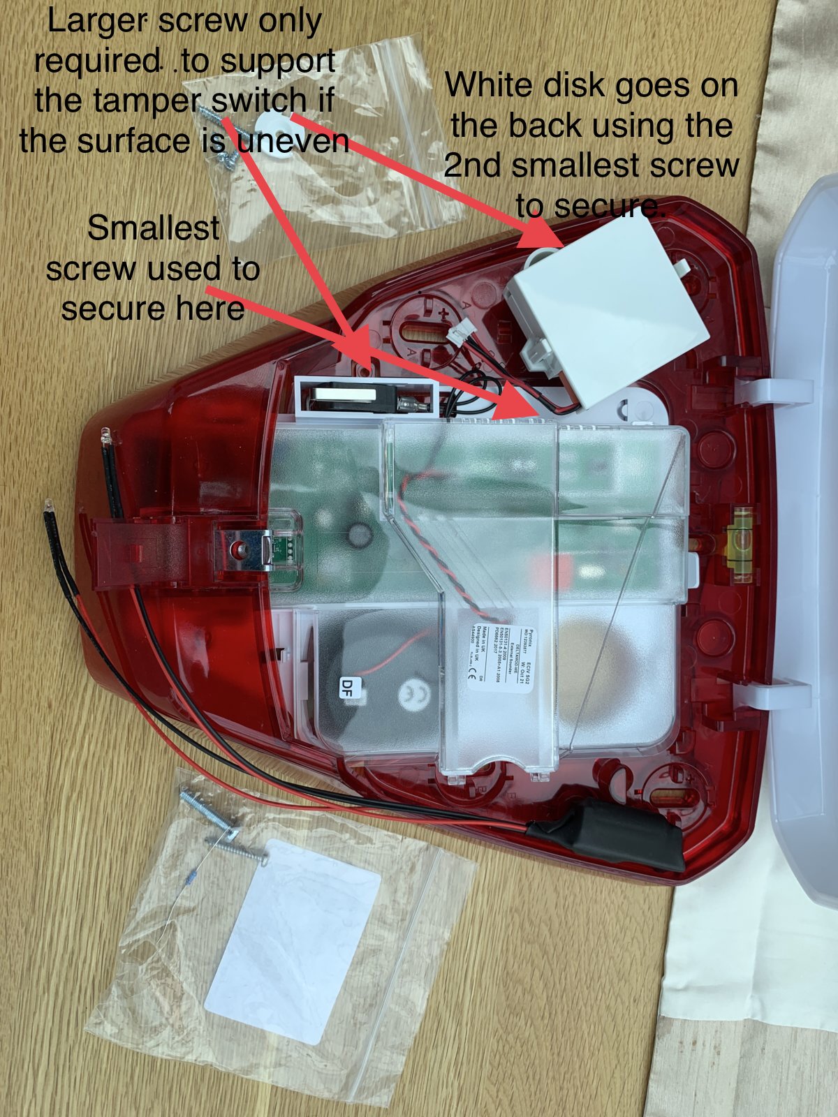

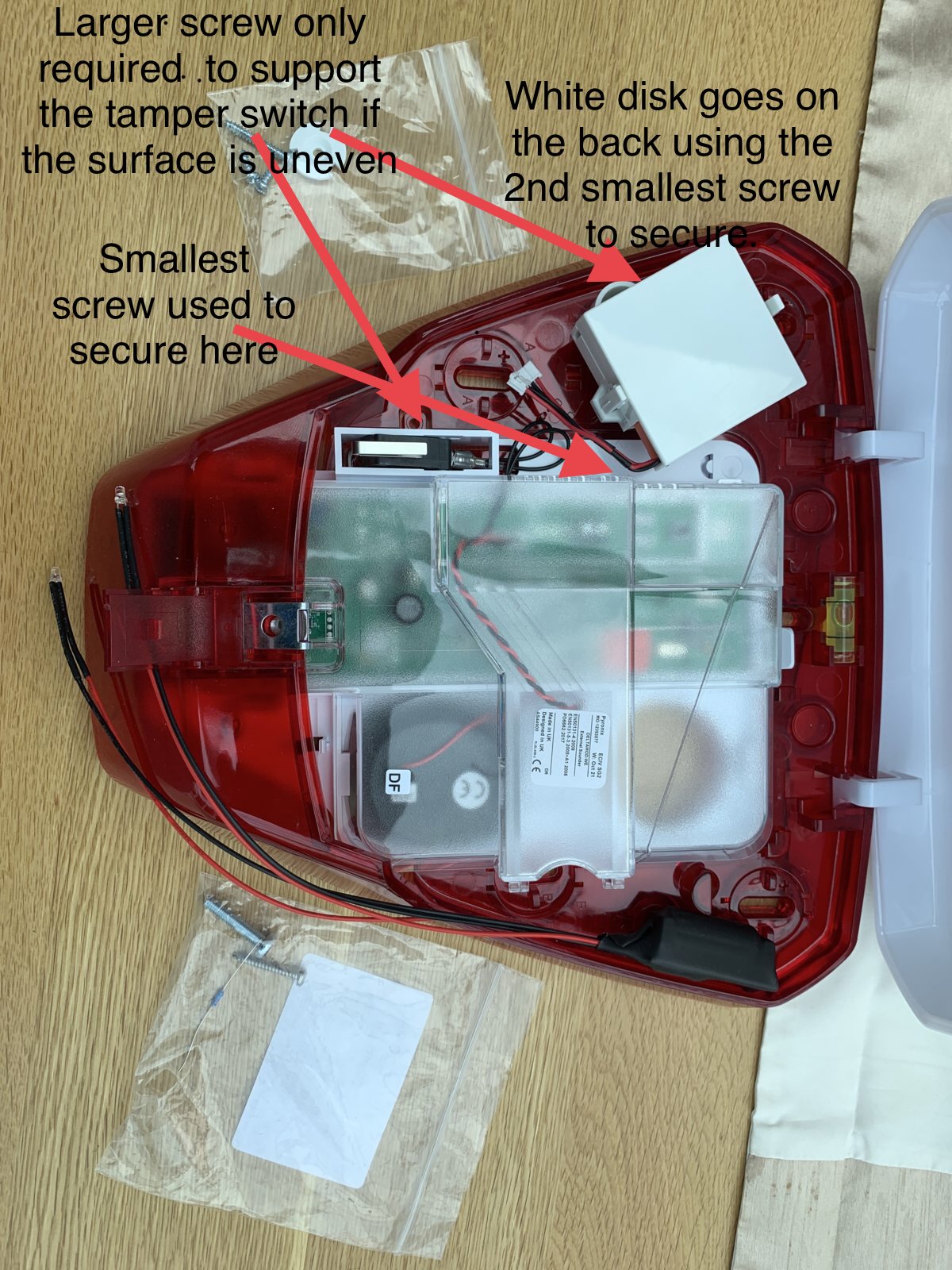

as per the pics I had some screws in the back - I assume the long on is used to lock the bell box but I meant to be using the smaller ones anywhere?
This unit has the ‘comfort LED’s’ built in so you do not need the external led lights. They are normally required for the dummy box only.

Got it. Thanks. Will give it a go. In terms of ordering
1. Drill holes
2. Insert PCB module
3. Put in smallest screw to secure
4. Put in battery
5. Put in second smallest screw to secure
6. Learn the system with the bell box secure outside? Or do I do this before I secure it?
7. Put on cover and secure with screw
Is that right?

Looks good to me mate. Maybe learn it before fitting if you are not familiar with the process but it is very easy.
Ah okay if I learn it first will the tamper set it off?
I guess if I’m engineering mode it won’t right?
I’ve done it! And it works! Thank you all so much!
The bell was deffo the hardest part - do I have to change any settings once it’s all learnt etc? Signal is excellent so no issues there either!
And they drain the main battery ! Best to fit the dummy led unit or better wire the bell to a 12v supply
