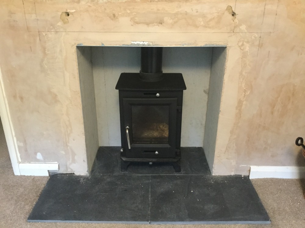

Hello,
I have recently had a stove installed by a HETAS approved installer.
I was concerned about the finish, which has led me to question the safety of the work. I have now discovered that it is unsafe, HETAS have said we cannot use the stove.
I am talking to Citizens Advice and compiling a letter of complaint RE the work, could do with some insight RE the following:
They did not fit a new lintel as part of the works. This despite me discussing this with the installer twice before the installation. They did enlarge the opening significantly and at the time of installation told me that a lintel was not required as the existing structure was in place to support the opening.
I am hoping that you can offer comment on the lack of new lintel, is this a planning infraction, poor practice, or is it acceptable if there is an existing old lintel in place?
Also if the existing lintel is OK in principle, how could I check to make sure that its sound?
Cheers,
Justin
Just because they enlarged the opening without fitting a new lintel doesn't necessarily mean it is unsafe. In many cases fireplaces originally had much larger openings for e.g. ranges. These were often a brick arch with an arched steel brace. Later on they are often bricked up to a smaller opening for domestic fireplaces. Opening up such an opening would not require a new lintel as the original support would still be in place.
@mrrusty Thanks for letting me know. What do I need to look for to ascertain if an old lintel is in place?

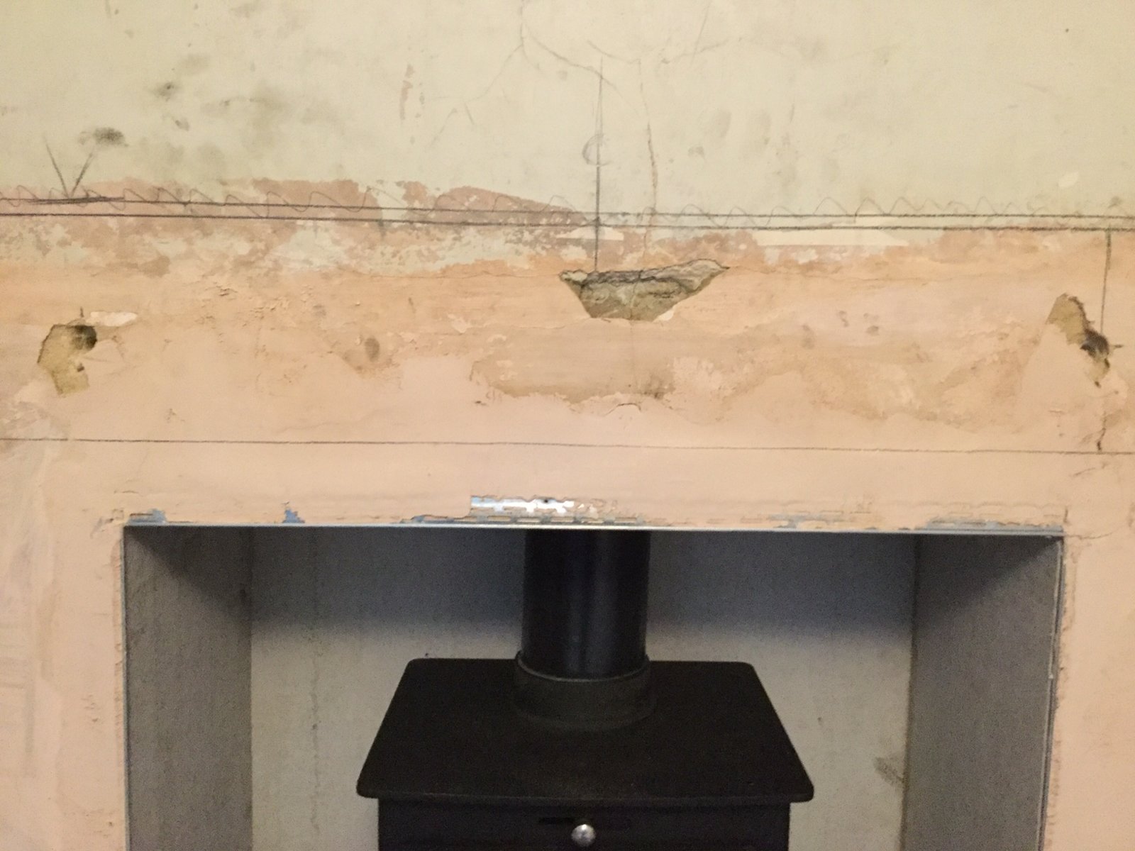

The plaster was not removed from the wall (see attached). When I removed the paper before instal I spotted a hairline crack in the plaster which runs down from the ceiling. This could well mean nothing the house is 50 years old.
During install I ran my hands over the structure above the cement board it sloped upwards. I assumed that this was part of the structure of the flu and that the lintel was above it.

Hard to tell with that top cement board and the plaster in place- it is possible that the installer peered up the chimney before it was fitted and could see a brick arch or lintel further up. Given the rest of the job it is possible they didn't do any of that......since you're in dispute with the installer you might want to leave it alone until any independent inspections have been carried out. Even if there is no lintel at all in there on that span it is unlikely to collapse- if anything did move it would be one brick or 2 so you can safely leave it until inspected

methinks you are worrying about a lintel too much. If that plaster is sounding hollow it's going to have to come off anyway. Why not just drop the plaster off the breast and see what you have. The lintel/arch is only holding up a few courses of bricks anyway - not the whole chimney! The forces will be corballed out into the sides of the chimney breast.

Your cracks as described aren't alarming but they do point towards not much supporting the front face of the chimney- knocking off the plaster will be the easiest way of seeing what is what, if HETAS are washing their hands of that part of the job then your existing photographs (might want to do some new ones with evidence of date on them- todays newspaper :) ) will adequately show how the structure was left by the installer.
One note- knock the plaster off carefully, if the brickwork is lime mortar then it'll be very loose (from years of heat from the fireplace)

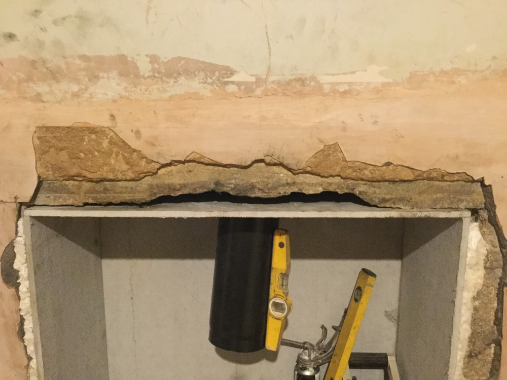

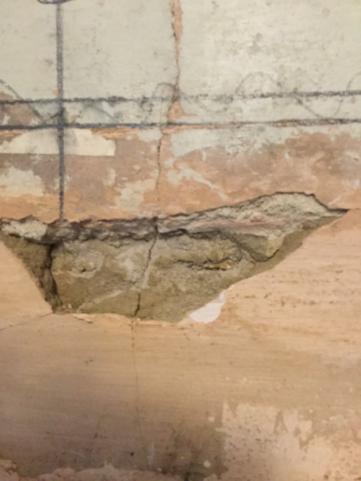

Have gently prised off some plaster and the crack continues through what I guess must be the lintel, see attached.
Have not taken too much off as we have to live with this until it's fixed/inspected whatever.
I would like to think it's best practice to replace something like this?

Your crack in the plaster- given what you said earlier about it all sounding hollow etc then now is the time (while the place is a mess anyway) to knock it all off and find out exactly what's under there. If you weren't doing all the work anyway you could fill & paint it (or paper, whatever floats your boat tho paper above that woodburner might not work out so well)- not a panic-worthy crack that :).
Your oak beam- I'm not an expert but geraldthehamster's answer says clearance from flue. If your new timber has an exposed timber face inside the chimney then it needs to be at least 3 times the flue diameter away from the flue (so 5" flue = 15" clearance). Unless that chimney is massive you're not going to achieve that- plan B would be a non-inflammable (concrete or steel) lintel with an oak slip glued on the front, plan C would be clad the inside-chimney face of the timber with some proper thermal board
