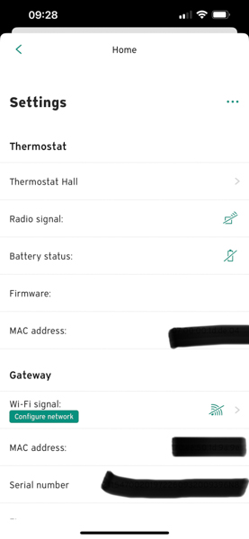

Last night the Vaillant App stopped working - cannot reach heating gateway - so wifi error.
Reset and re-added the Gateway to the wifi - confirmed I can see the gateway on the network (I can see it's IP talking to the router) so connected to the internet for sure.
As part of this process it also did a firmware update - no choice it just did it and I let it complete and reboot. Re-added to the wifi
The Problem:

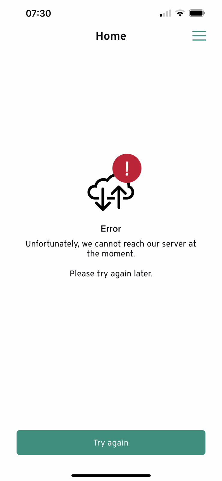

Now getting different Error:
Unfortunately, we cannot reach our server at the moment. Please try again Later.

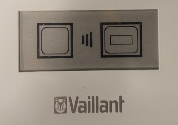

Thermostat also showing no connection to heating gateway display.
On the Application it shows the Thermostat not being connected, I've removed/replace batteries and brought it next to the heating gateway and restarted and it still does not connect.
The app also shows Gateway has No wifi signal (even though it is connected to wifi - I can see it on the router).

Are the vSmart servers having issues?
or
Is the heating Gateway broken?

I think they are updating servers, mine is all over the place today on a wired connection.

My wireless thermostat has now lost connection to the heating gateway. It will not connect. I have replaced the batteries (the old one's were fine), but it will not pair. I cannot re-add the thermostat in the app as the application isn't working - on starting the erelax/vsmart app it starts at setup - which I go through the process by pressing heating gateway button untill it glows, add the gateway as an accessory. It starts the process then fails with Operation couldn't be completed Workflow.BlockError error 5) which I think is because there is not thermostat connected..
Vaillant tech support do not work on Sundays. Any suggestions appreciated - getting cold. :(
