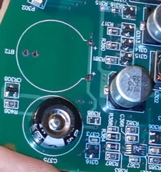

A teardown video for a 1652C here (not the best! ;) ):
@13:18 there's a super cap apparent on the top PCB, next to an unpopulated battery connection.

He did - but there's nothing wrong with great minds thinking alike, and I'm grateful to both of you for your interest and assistance. However, in turn, I've already seen that video (and at least one other like it). Unfortunately, that is a 1652C and I remember from the past that, although the general concepts of the innards of a 1652C are similar to my 1652, the details are very different.
I must say, I did not note/remember (from either the video or vague memories of my real-life dissection of my previous 1652) your observation that ...
... @13:18 there's a super cap apparent on the top PCB, next to an unpopulated battery connection. ....
However, even in terms of the video, I'm not sure exactly what you are referring to as the 'super cap' or the 'unpopulated battery connection' - can you perhaps somehow 'point me towards' what you are talking about?
An unpopulated 'BT2' :)

An unpopulated 'BT2' :) ... Though as you say, this is the 1652'C' - good luck! :)
Ah, right -not sure how I missed that.
However, as expected, I have now found the innards of my previous 1652, and there is nothing remotely like that!
After well over 12 hours with the battery pack in, the 'new' one is still showing the Err 1, so I'm shortly going to open it up, at which point I will discover what is inside this one. Watch this space!
