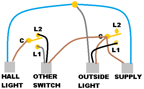

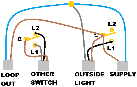

Looking at the photos it's hard to see which browns are included in the bundle.
Without knowing the wiring in the other switch my interpretation
But this does not explain loss of supply to other lights.
This
Could be the other possibility but without more clarity on the browns I can't be sure.
Earth wires not shown for clarity.
Going on what has been posted already, I plumped for your second option. But TBF, I have not seen inside the second hall switch
