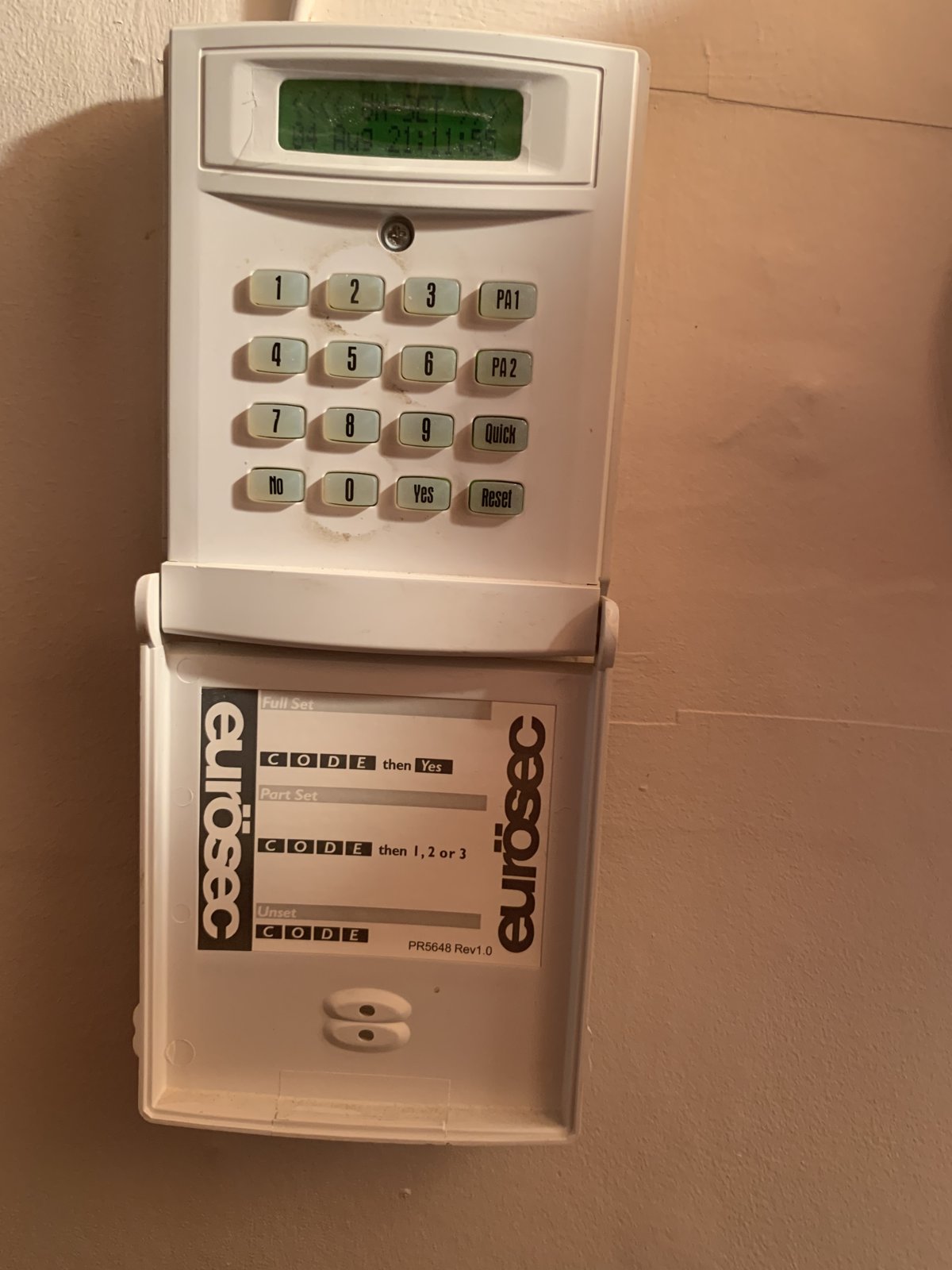

Hi. I’m having issues with my home alarm. It’s a Euro sec PR5648, I may have part set the downstairs without knowing as the alarm only triggers once I go upstairs, the lights on 2 of the 3 sensors downstairs are flashing but 1 is not, I changed the battery with no joy so I’m assuming I’ve part set it. The other issue is I would like to remove the 10yr old engineer code as I keep getting alerts to service with them on setting the alarm as I change the battery’s myself etc so would rather remove their codes as the factory setting codes do not work. Please help if you can. Thank you.

do you have the engineers code, if you set the alarm you can unset and reset any activations and how does it behave.
secondly PIR's illuminate when they have power to them normally unless they are wireless or have the leds disabled.

The panel appears to be unset, with the wrong time and date on the keypad?
As for defaulting the panel or the codes, you should look in an installation manual firstly, be aware depending on how things have been setup by the engineer you may not be able to default the codes.
However this panel and keypad are relatively cheap to cheap to buy.

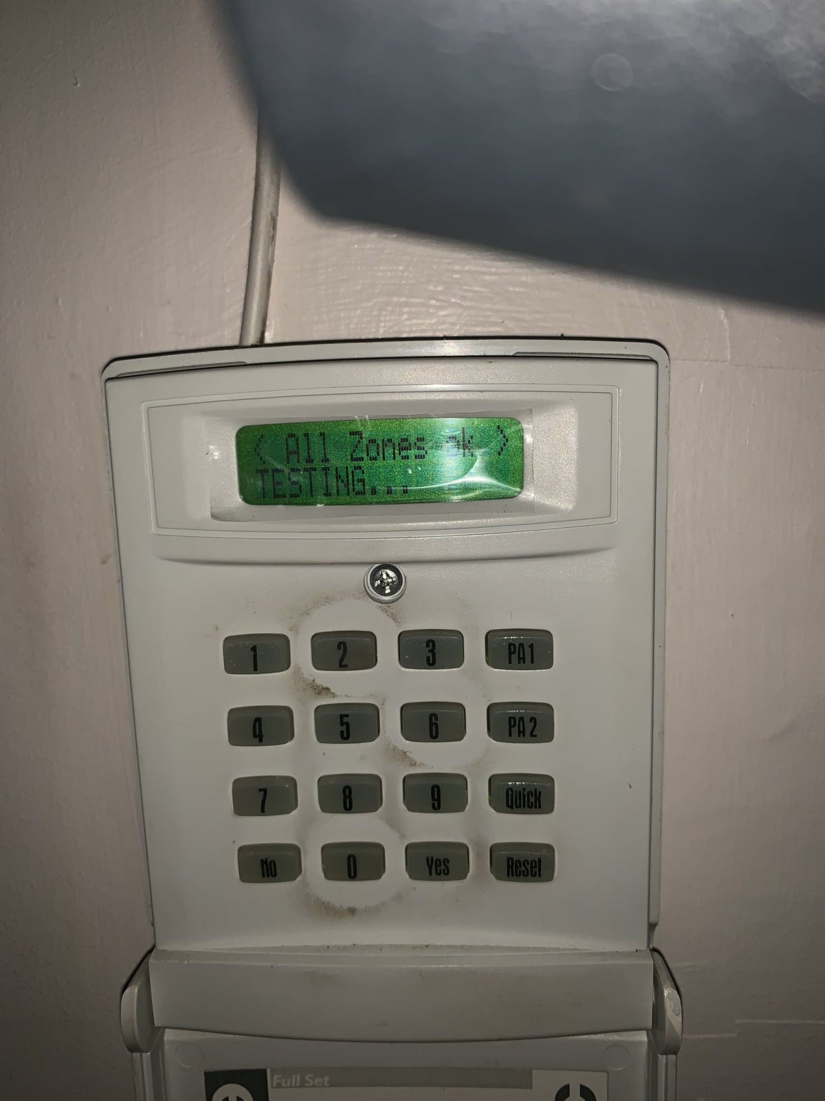

Also I don’t believe this one does a walk test it’s more of a system test which says all is ok. I have used other alarms that have the walk feature like the Yale premium alarm which the panel makes a noise when each pir is triggered. Is there a way to know if downstairs is part set ?
The panel keypad is showing UNSET?
Entering your user code it would disarm if it was set or part set.
Ok so when it’s part set of you set the alarm and leave on returning it’s in full set mode. That’s good to know thanks. So my issue cannot be that it’s part set on returning home 2 of the 3 pir’s flash but 1 doesn’t however on going upstairs that our triggers the alarm.
It’s a panel test like this image. I’m also setting the alarm and on return walking up to pir’s

Part set you normally part set the system and certain sensors wont work, ie hard wired PIR would illuminate but not cause an alarm if that sensor was omitted in a part set.
That's a walk test now you have to go round and activate each device.
the screen suggests you have tested all the zones?
by walking in front of PIR an it illuminating, a door contact by opening and closing the door
a shock sensor by tapping on the device or a hard thump on the frame its fixed to
