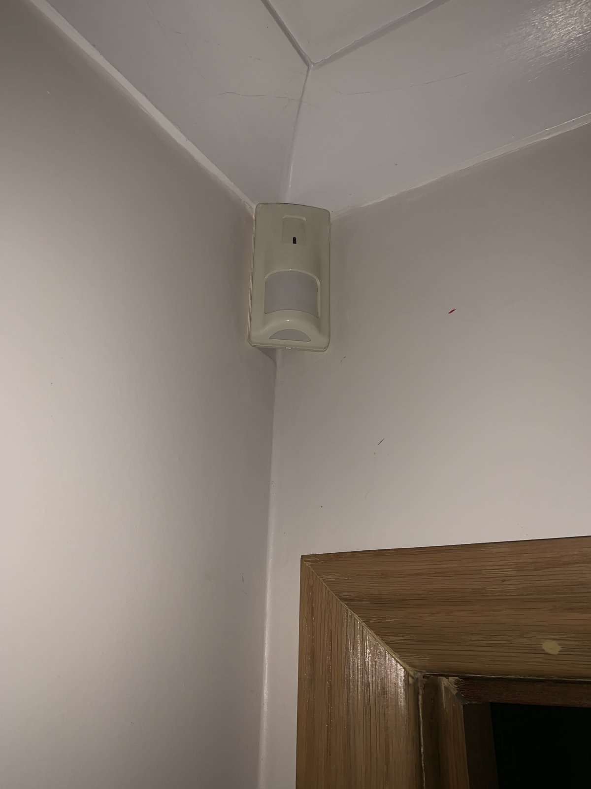

Whilst turning the panel on test mode I opened pir’s downstairs and pressed the tester button, they all flash red but the panel stays the same, I walked upstairs to test the pir upstairs and it triggered a tamper alert now the alarm keeps saying tamper upstairs even when trying to set the alarm.

There is no other way to test these pir’s inside there is a metal part once clicked it shows you if the battery is working or not I don’t know any other way to test, there is nothing to push whilst case is on. However the tamper I can sort I’m just wondering why the alarm is not sounding on walking in the house especially on the ground floor.
Sparkymarky It’s not about messed around with I know how to take a pir case off and back on I’ve been changing the battery’s for over 10 years that’s not the issue but thanks for your input.
testing the batteries does not test the PIR to be fair.
a walk test tests the PIR to see if it picks you up.
pictures of the PIR's maybe useful as I believe this panel is hardwired normally.
If the service timer is turned on and you have being getting service required messages then the system will lock out within the 14 day time limit.you will then require the engineer code to reset the system.
That’s a cpx panel which can have wireless expansion...
