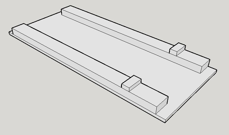

I take your point about a chop saw being a far handier tool than a circular saw for cutting decking planking, however whilst it is possible to knock-up a quick and dirty cross cutting jig for decking planks for use with a track saw:
using a couple of decking offcuts and a couple of bits of 2 x 1 softwood (the bits at the top) mounted atop a piece of sheet material (anything from an old flush door to a piece of plywood) which will allow you to cross cut planks accurately with a track saw, I have yet to figure out any way to get a chop saw to cross cut a 600mm wide worktop or do sink cut-outs in the top. Whilst it's nice to have both, it does put more strain on the budget
BTW in use the back edge of the rail rests against those "ears"
