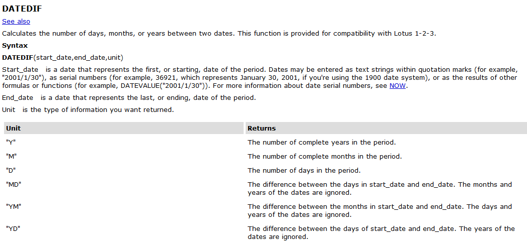

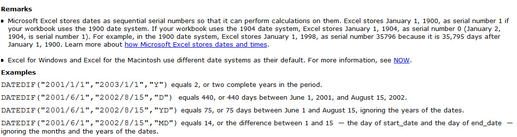

From the ('integrated', not on-line) 'Help' of Excel 2000 (Excel 9.0.2720) ....

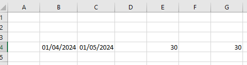

With =DATEDIF(B4,C4,"D") in cell E4 and =C4-B4 in cell G4 (and G4 formatted as 'number' with zero decimal places) both work for me in Excel 2000, Excel 2010 and Excel 2019 (illustration is of Excel 2019, but the other two look identical). What's in G4 is the ';easier method' I mentioned previously.
With =DATEDIF(B4,C4,"D") in cell E4 and =C4-B4 in cell G4 (and G4 formatted as 'number' with zero decimal places) both work for me in Excel 200, Excel 2010 and Excel 2019 (illustration is of Excel 2019, but the other two look identical). What's in G4 is the ';easier method' I mentioned previously.

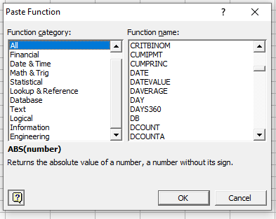

One last question - on yours, is DATEDIF on the functions list, or do you type it in?
No, you're right, it's not in the list (see screenshot from Excel 2000 below). I was not aware of that because I don't think that I have ever in my life used that list - I've always just 'typed things in' :)
