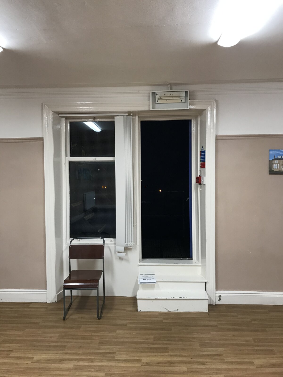

I’ve got an emergency light to replace, but I’m unsure as to which direction I should fit the arrow to point at.
The current convention in this building is an up arrow above a through door.

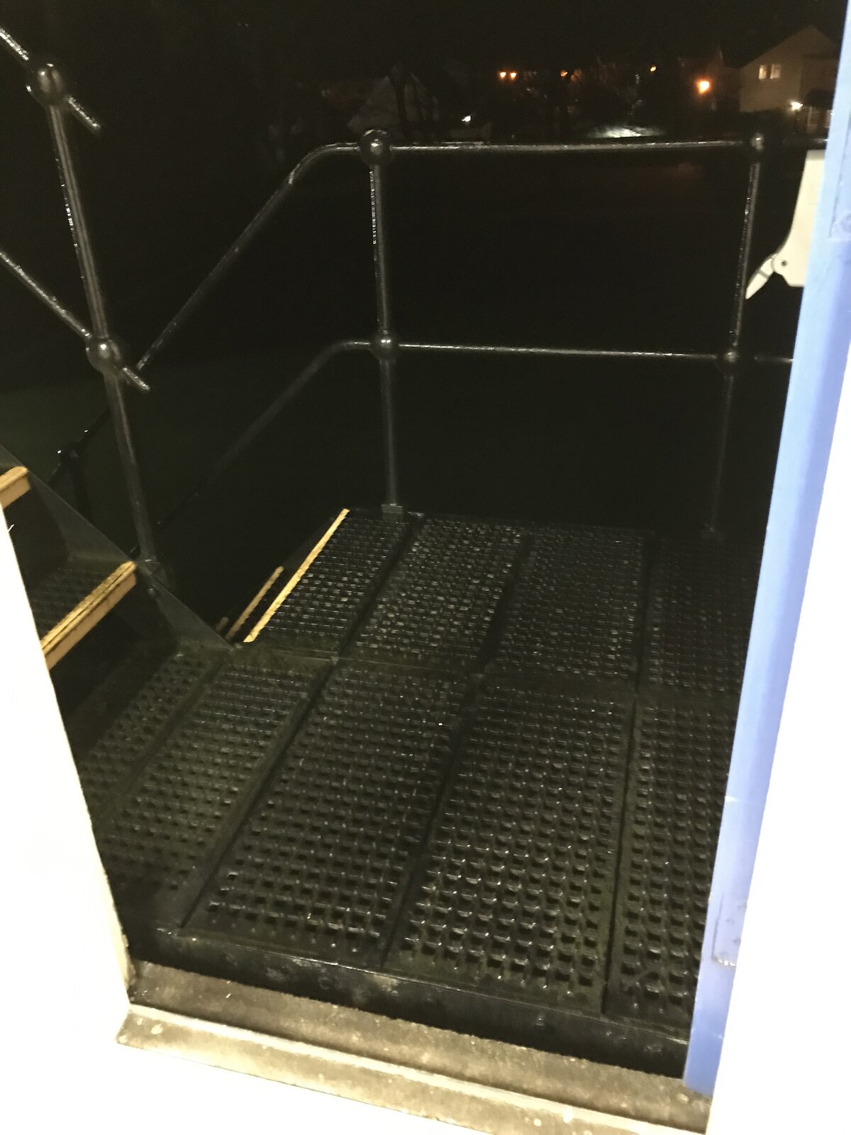

To use this fire exit, you must take three steps up, go through the door onto the external fire escape. Take two steps forward and then turn left and follow the staircase to the ground via another half landing and a 180° turn.
Which way would you fit the arrow?
I’ve removed the existing arrow so as not to influence your decision!
I would say it only relates to the door, so should be up.
Another on the stairs pointing down left ???
Does anyone think fire escapes would be up to escape?
I would have an uninformed guess at down arrow as stairs down immediately outside and this is probably confusing as other final exits will have up arrow if no stairs outside. Double confusion due to the euro style signs you can get with it the other way up aswell.

It should go down.
An up arrow means "that escape is forward and straight on or forward and straight up".
An arrow pointing down means escape is in a downward direction and is commonly used within a staircase enclosure although will still apply here, the 3 steps can be ignored - a down arrow basically means go through the door below the sign and head down.
