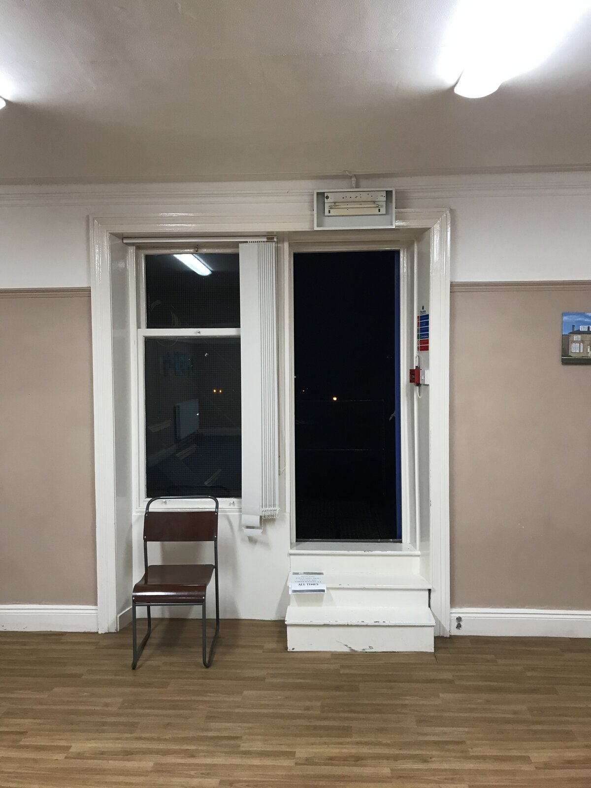

I’ve got an emergency light to replace, but I’m unsure as to which direction I should fit the arrow to point at.
The current convention in this building is an up arrow above a through door.

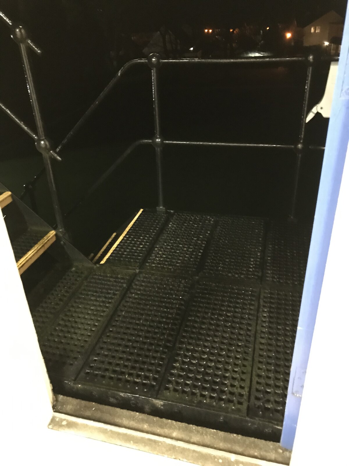

To use this fire exit, you must take three steps up, go through the door onto the external fire escape. Take two steps forward and then turn left and follow the staircase to the ground via another half landing and a 180° turn.
Which way would you fit the arrow?
I’ve removed the existing arrow so as not to influence your decision!
