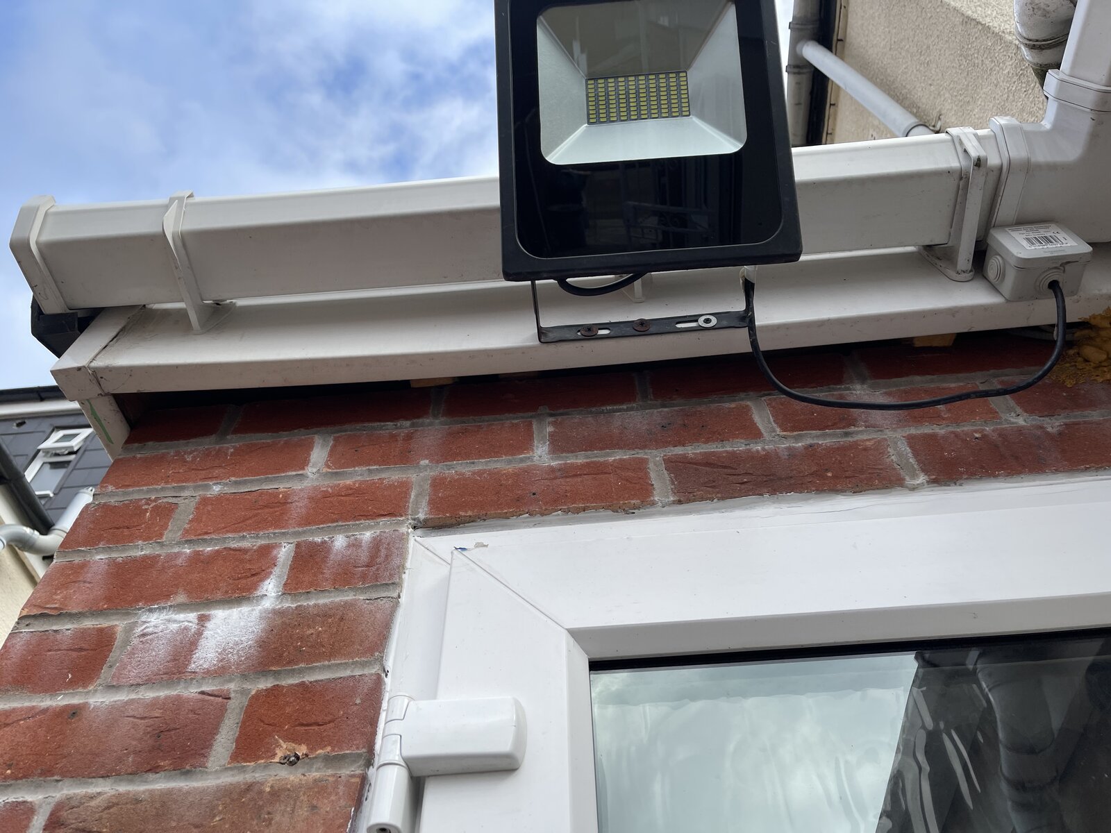

Expanding foam
Sounds like a good plan.
Bit of ct1 and duck tape to hold it in place whilst it dries and jobs a good un
If you insist on using the foam, pack the gap with wire wool and then foam. It'll stop the mice chewing through. But foam will look awful. The PVC trim is a much better idea
Yes it would look much better. Will just go for trims by using silicone as the adhesive. Will return the expanding foam

It should also be noted that the foam will turn bright orange over time if used outdoors.
Be aware that any hole large enough to push a regular pencil in to is large enough for a mouse to enter.
The wire wool prior to foam cuts though their noses as they try to munch their way through the foam.

This is the gap I need to seal off. Will get trims to seal the gap
The builder didn’t finish the job completely. Was such a dosser!
That UPVC door is very poorly positioned and the silicone sealant loos like it was smoothed with a hairy forearm.
The finishing on the soffit/fascia detail is ridiculous. The builder should be put against a wall and shot.
Is a hairy forearm not a good tool for silicon?

Listen mate. You pick out all the nitty gritty stuff. I put the silicone on, I rushed it because I wanted to do it quick. You too picky. Also the door had to be positioned that way because it is only a small extension. We extended the living room and only expanded like a passage way size. The door couldn’t be anywhere else!

I was referring to the position of the door relative to the brick jamb. You should be seeing at least 30mm of brick edge or more.
It is too close to the corner structurally as well - 3 bricks minimum.

I cut it off slightly because I didn’t take a pic of the whole door width to width
