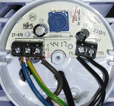

View attachment 147122 Trying to get the timer working on an Expelair VX100T. There's a single live, a neutral, and earth cable from the socket the previous fan was wired to.
Wiring the live to the L on the new fan causes it to run continuously. Wiring the live to the T causes the fan to switch on and off with the light and the timer doesn't work.
Any ideas?

You cannot then. It requires a permanent live to L, a switched live to T and a neutral to N.
Are you sure?
If you mean live to both L and T, that's how it will work because live to L is switched off with the light.
Just wiring live to T, and not L, it should do nothing.
You need a 3 core and earth cable going to the fan for this to work.
Trying to get the timer working on an Expelair VX100T. There's a single live, a neutral, and earth cable from the socket the previous fan was wired to. Wiring the live to the L on the new fan causes it to run continuously. Wiring the live to the T causes the fan to switch on and off with the light and the timer doesn't work. Any ideas?
I can't really make sense (see below) of what you're experiencing, but if the supply cable has just a single 'live' cable, then you will not be able to get the timer to run as intended - since to do that you need both a permanent live and a 'switched live' (switched by the light switch.
If the one L you have were a 'switched live', I would expect the behaviour you describe when you connect it to both L and T - but it would then probably not work at all (and certainly not when the light was off) if you just connected it to the L.

Leaving aside the obvious for the moment - where is the neutral, then?
Ok, the blue wire is the neutral... but the source I quoted says that it is the switched live. What is the obvious that you are leaving aside?
The previous fan used to switch on and off with the light with a few minutes delay. I appreciate the responses, but from the pic I posted can anyone tell me how to actually wire this so the timer works or is it not possible with this model of fan?
As has been said, it's not the model of fan which is the issue - if it's a timer fan, then it must be possible for it to provide the functionality you want. The issue is the cable, and how many wires there are in it. For a timer fan to work, you need the permanent live, switched live and neutral, and there should also be an earth - hence 4 wires in total (3 + earth). However, it's been known for some people to adopt the 'naughty' (and potentially dangerous) practice of using the 'earth' wire (green/yellow or bare) of a 3-core cable as a 'switched live' - so, if you've only got a 3-core cable, perhaps that is what was done.

The source you quoted says that it is a switched live in the example drawing they used.
Wires don't know what colours they are, and will behave on the basis of how you connect them up, not their colour.
If whoever installed that cable did not use blue as a switched live, then it is not a switched live, no matter how many drawings you look at where it is.
Hands up anybody who thinks the instructions for the fan show the middle terminal as the earth connection.
Has anyone mentioned that -
even if done wrongly, it should be wired in exactly the same way as the old fan.
How was the old one connected?
Not only that but, although I have yet to find the full instructions for a VX100T, there are umpteen 'wiring diagrams' out there. All look similar/identical, none seem to show the same terminal arrangement as in the OP's photo, and none show a connection for an earth. I therefore wonder whether (a) the photo the OP has showed us really is of a VX100T and (b) ...
