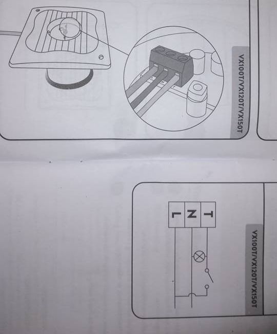

Thanks for your input everyone. It does seem that a timer fan will not run on the wires I have as has been said, but here is the wiring diagram from the manual.
It does seem that a timer fan will not run on the wires I have as has been said, but here is the wiring diagram from the manual.[/ATTACH]
I'm afraid that I am still confused. I thought you had told us that the previous timer fan did work as expected with "the wires you have" (which presumably have not changed)?
To be sure, can you clarify what the photo you posted is (since it doesn't look like a VX100T), and why that green/yellow wire is connected to the middle terminal?

It does look like the diagram now shown.
I don't understand why that does not appear on any searches.
Because there are three wires and three holes. :)
It does look like the diagram now shown. I don't understand why that does not appear on any searches.
Quite - it's very odd that the umpteen wiring diagrams on-line are different from that.
True, but that doesn't alter my question as to why the G/Y is connected to the middle terminal, given that that terminal is labelled 'N' in the diagram now posted, and that, in the OP, it was said that there was "a single live, a neutral and an earth" in the cable.
Kind Regards, John
Ok...my sarcasm senses are tingling... so the earth wire shouldn't be connected at all? Do you have any suggestions for what kind of fan will run on the existing wiring and not run continuously?

If your previous fan had a timer for running on after the light was switched off and it worked then the new one will do the same.
That at least one of the wires has been used for something it should not have been, means we cannot tell which wire does what.
You will need to determine which wire is always live (I would think brown but who knows what previous person did?)
which one becomes live when the light is on (might be green/yellow, might be blue)
which one is neutral (might be blue, might be green/yellow connected to neutral or still connected to earth)
If it is the latter, then it should not be used until rectified and wired properly.

As John suggests, it seems likely that someone previously decided to use the yellow/green"earth" cable as a neutral. The two other cables are functioning as the permanent live and switched live.
If your fan is running constantly then it may be the case that you have the perm live and switched live the wrong way around.
For the record, I am not advocating that you continue to use misleading wiring, but I can see no logical reason why it shouldn't work.
You cannot say that.
If the green and yellow is connected to earth it is dangerous.

As EFLI has said, a worse possibility is that it might still be connected to earth. In the absence of RCD protection, that would still work, but would not be 'safe'.
As EFLI has also said, that would not cause the fan to run continuously (even if light was off). If one of the avail;able conductors is a permanent live, and if that is the one he connected to both L and T, then that (and only that) arrangement would result in the fan running continuously.

Indeed, potrentially dangerous. However, as I have just noted, the fact that the fan now 'works' (with some wiring arrangements) means that that (G/Y is connected to earth) could only be the case if there is no (or no working!) RCD protection - since a 15.7W fan (68mA, even if PF=1) should be more than enough to trip an RCD.

Hopefully not - the problem is not the use of a G/Y conductor as a live one - for a sheathed cable that is allowed, as long as it is oversleeved at each end to indicate what it really is, the problem is that there is no earth going to the fan, and that is simply not allowed, double insulated fan or not.
So, to be precise with the use of English - the existing wiring can be used for a timer fan, but it may not be.
