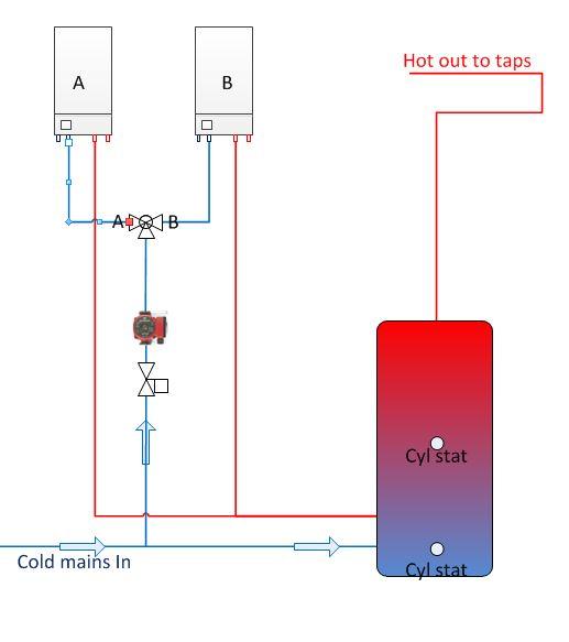

Forget about unvented cylinders and go for semi instantaneous hot water.
This lot will supply 40 ltrs a minute of 60 degree hot water to run 2 baths & 3 showers at the same time ( 2 x 10 ltr + 4 ltr cold) and 3 x 7 ltr + 3 ltr cold)
Nothing ( including CH on WC runs over 60 degrees)
Total cost of parts under 4k
Reheat time of buffer (250 ltr) will knock your sox off & this set up will run your central heating.

Hi
Could you briefly explain what is going on in that diagram? Does it involve a home booster pump?

This set up isn't beholden to the pressure pump, but it does generate a lot of hot water. I'll leave the explanation of its workings to Kim (ecowarrier) though if you don't mind? ;)

Forget the LH boiler.
Normal combi.
With no draw off eventually stat in the buffer cools & calls combi to fire DHW. The anti strat pump circulates (whatever the boiler can muster) litres at 60 deg. thru the buffer & back up to the boiler till buffer satisfied then all stops.
Call for DHW - lets say 25 lt per min. Buffer supplies then bot of tank cools & calls in combi. Lets say 10 Litres at 60 degree coming in from boiler. So 250 ltr tank lasts 10 mins & not reheating slowly - but direct by 60 deg useable watewr. So 25 going out 10 going in only 15 being used from buff. . Now u have 16 mins of water supplied at 60 degree so your 25 is nearer 40 at the tap. DHW demand stops combi reheats the buf with direct heat
Data logger suggests putting the hot water in at the top lasts longer at 60 degrees & make insignificant time to reheat of boiler.
Shunt pump size depends on resistance thru the boiler u choose. Boiler must be able to take hot water thru cold in. Look at the flow rates for 60 degrees from your boiler manual data..
The job was done for a brothel. They use MOUNTAINS of hot water. The system that came out was two 35Kw on normal u/v 250 cyl - system that went in was two 36 combi with 250 buffer and the improvement was staggering.
The break tank & booster was due to the mains not keeping up with the boilers & buffer! You won't outrun these babies! lol

A very elegant solution!
A few questions:
1. Is this legal in the UK?
2. What combi's will allow a flow of hot water coming in from the expected cold mains without throwing a hissy fit?
3. I suspect you have to size the pump to deliver, as far as possible, enough water to prevent cold coming into bottom of tank at maximum outlet, i.e. so the cold feed into tank only sees flowrate for static reheat, in the opposite direction to shown. Correct?
4. Are they motorised valves before and after the pump, and why are they required?
