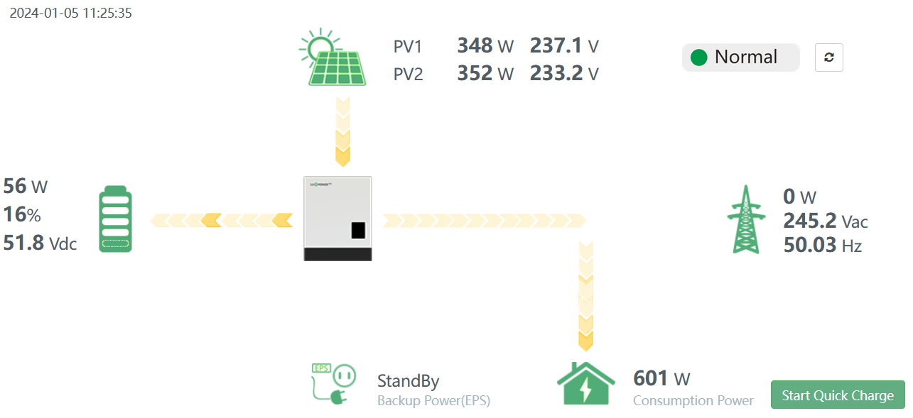

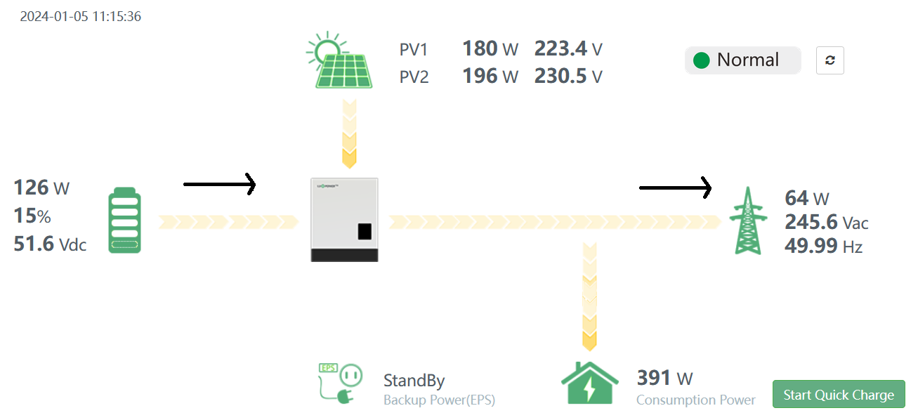

I am told this is not what is really going on, and it is due to delays with server in China? But Solar is making 376 watt, battery discharging 126 watt total 502 watt using 391 watt so 111 watt left, exporting 64 watt so 47 watt has disappeared so it would seem likely some of the figures are suffering a delay. In the time it has taken to write this changed to
And all figures add up OK, wonder it others get the same, or just me? Over all for December we hardly ever exported

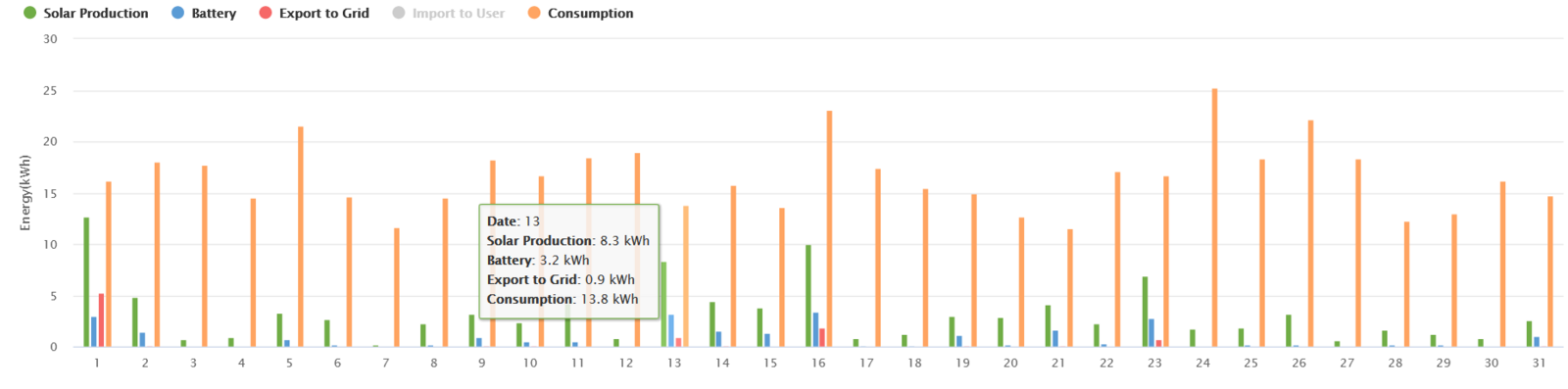

Just as well as until smart meter fitted not paid for export, 1, 13 (shown) 16 and 23 were only days with export. As one expects this time of year very little solar, but it does not seem to be doing what it should, my battery should stop discharging at 10% unless there is a power cut, but last night dropped to 4% then recharged to 10% off the grid, not aware of any power cut. My clock still showing correct time.
But not sure if worth complaining or if that is either normal or due to delay with server in China?
