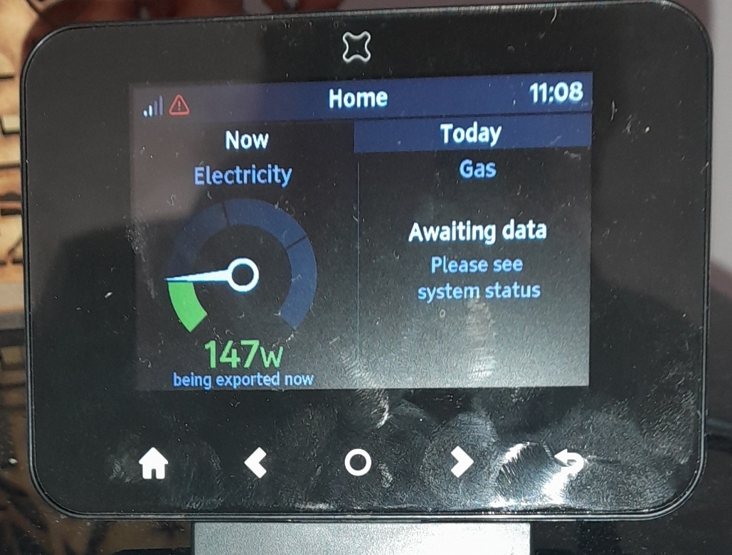

It sits under the TV, and use power from grid and one can see green amber red we ease, but into the grid, and shows green without much movement into green can't see how much without going right up to the display.

The change between green and amber is around 1.75 kW and is easy to see, the export screen however 1709770038528.png the green segment is about ¼ of the dial movement and is moves that little one needs to read the actual figures, even at 2 kW the needle hardly moves. This
is so small, I need glasses to read it, this from the solar does show how much used,

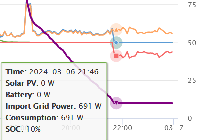

but only really interested in what has been used from 21:46 when my battery hit 10% before I changed tariff I was using between £2.50 and £3 per day, but I have no current readings, so a bit useless.

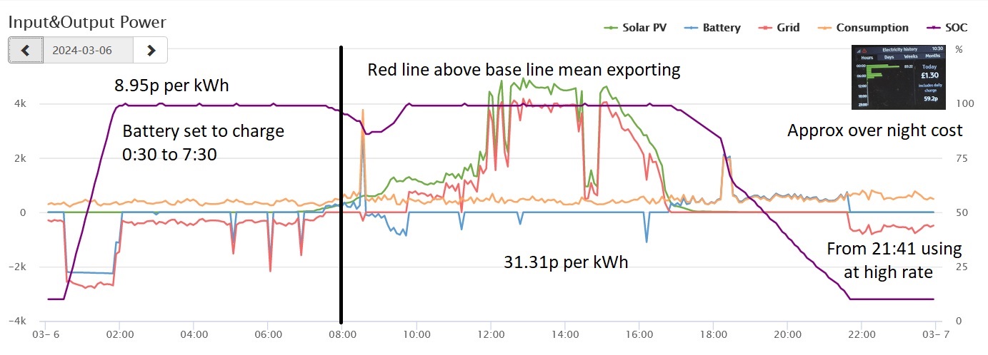

The display does show hours, days, weeks, months. However I can only access today, can't access yesterday. The app shows on the 26th Feb I used used £2.14 worth of electric, since then my tariff has changed, and also changed how I use the power, I now charge battery from 0:30 to 7:30 (cheap rate 0 to 8:00) and clearly interested to see if the change is reducing my bill.
So I saved the full day yesterday and intended to look at daily bill to compare, was in bed at midnight so when down this morning to have a look, but the display as said does not show yesterday.
So I have this
so I know midnight to around 10:30 today I used £1:30 and since since 7:30 not used any power from grid that seems to be my over night use. But as to from 21:41 to 0 that is unknown. To equal what was used before tariff change I need to use less than 86p for rest of day.
