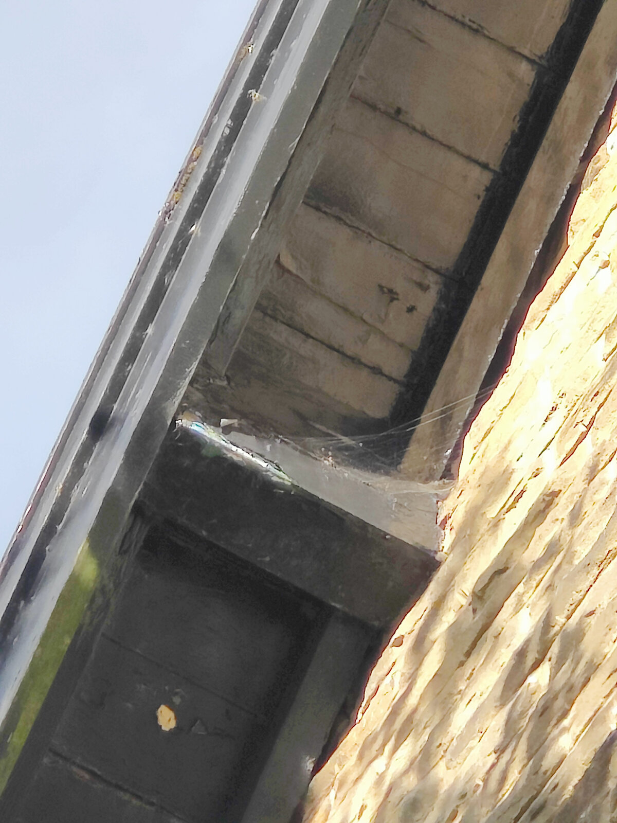

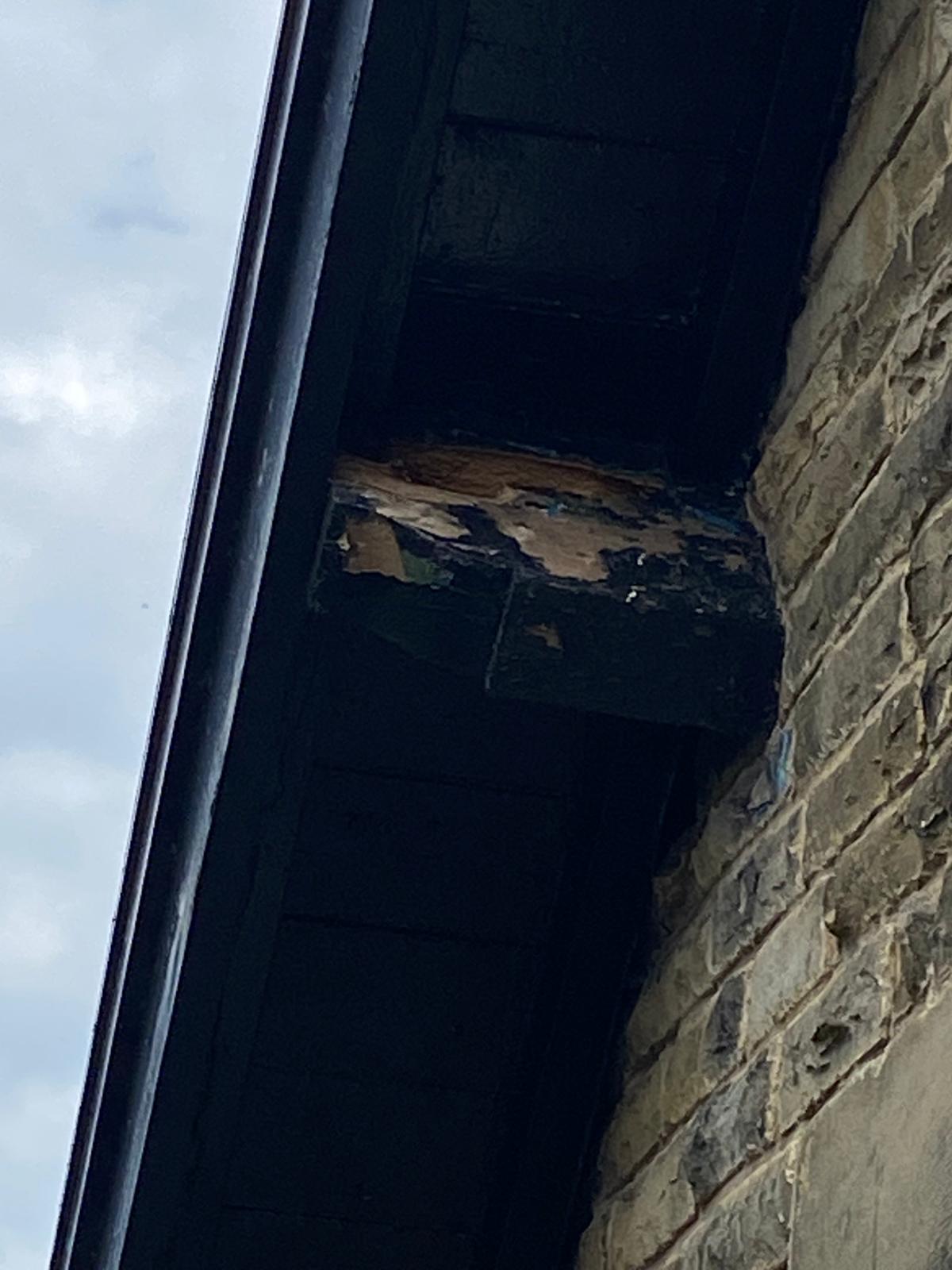

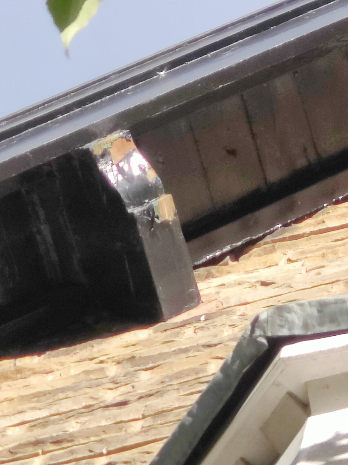

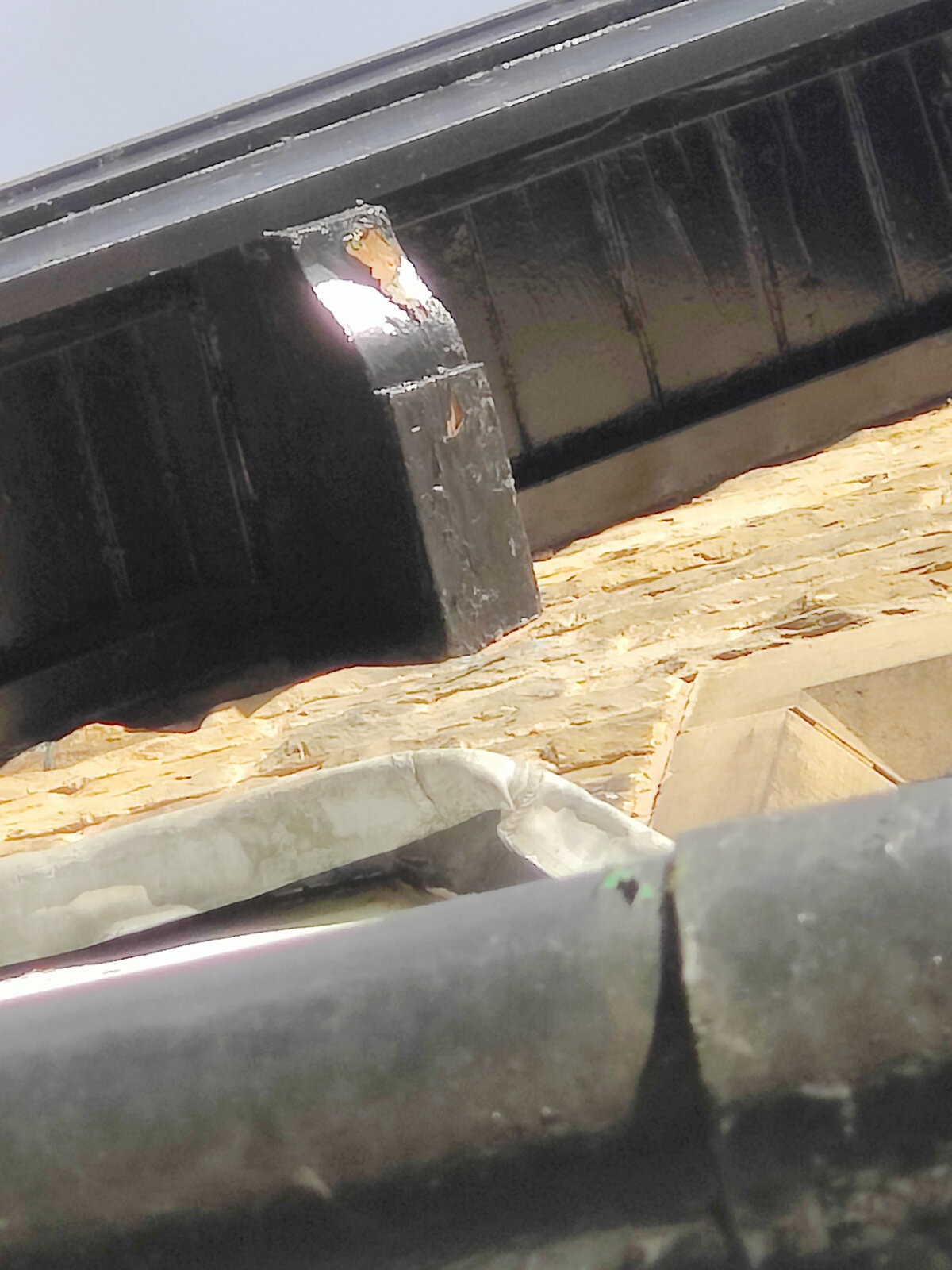

Hi,
So the front, side and rear of my house has exposed purlins under overhanging eaves.
At the front, the purlins on the left hand side of the apex towards the top and middle of the roof have a lot of paint missing - I just assumed they had weathered and needed painting but they seem on their 'top' side to be down to the bare wood.
They are 8 x 4 and set at a 45 degree angle. They may have some kind of rot? looks like they have cracks and the higher up one seems to have a hole where it meets the soffit.
I've gone into the fully insulated attic space and jabbed the worst looking one with a screwdriver - it's solid. There is a cavity wall which is about 400mm thick.
I can't see anything amiss up there, some powdery spots on areas of timbers which come off if I wipe them with my finger, but no kind of bad smell. I've looked down the rafters as well - there's a piece of insulation board sitting between each of them.
Does anyone know what this could be, how it could have happened and how I can get it fixed please?
We have been here about 4 years, the purlins have been like this a while - not sure how long. The slate roof has vents dotted around it - there's a decent breeze up there. It's laid with impermeable felt also. It looks like there may have been some difficulties in the past as some of the original planked soffits look to have gone a bit rotten - but nothing recent? We lost some slates etc. on the opposite side of the apex but had this repaired.

Looks like they should be repairable, probably the result of water ingress from an old unmaintained gutter or soffit, dripping over many years.
They don't seem to be purlins in the technical sense as they appear to fit under the end rafter only.
Blup

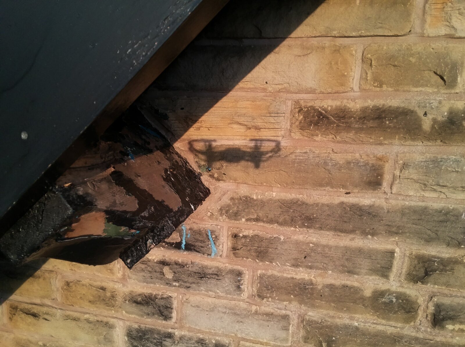

I think they are purlins? They support the eaves/roof overhang, the one at the top goes through the space at the top of the house, back to load bearing wall at the back of what is the front 2nd floor bedroom, it's bare wood, the lower down one is the same but you can see it in the front 2nd floor bedroom and it's painted or covered in some sort of paper.
So the section of roof above the front 2nd floor bedroom rests on these. The red lines in the picture are where they roughly run at a 45 degree angle.
The tradesperson working on the house thought it was dry rot.
What's weird is where has all the paint gone? I don't remember finding any flakes of paint on the ground? You can see the layers of black, blue underneath that and even green! that must surely be the original Victorian paint.

I can see now they run further back than i thought. You will have to examine and remove the rotten wood before deciding what to do, you might get away with 2 part epoxy wood filler, or alternatively need to splice in new wood.
Not really a roofers job and too small for many builders, maybe a chippie with a head for heights.
Blup
I've seen them totally hollowed by rot from the ground they look ok until you look close

Can you post better defined pics for the purlins on the out side, and the soffit above them - and clear focus pics showing the purlins inside the loft? Will you ID each pic?
If you have rotted out purlin ends with the rot going back through the wall then eventually, if not now, you will have support difficulties for the wide verge soffit, barge board and roofing above.
From your balcony, a long batten of timber with a spike fixed to the end will allow you to probe the outside purlins.
Hi the last time I encountered this ,a builder came and cut the bricks to the side of the rotten purlin ends to rough size of new purlins and run through into loft alongside purlinswith a 6x2s or something the same size as original , into same position as the original on outside , ran it from the front edge to about 6 foot ‘ into loft and bolted them to original purlins which inside were sound . Once the verge weight was being held he cut back rot purlins to good wood and painted the cut end in preserver or something like that . He then bricked and cemented the holes left by the removed rotten purlins .
Also the rot was caused by faulty lead work around his chimneys and water was getting through and soaking in

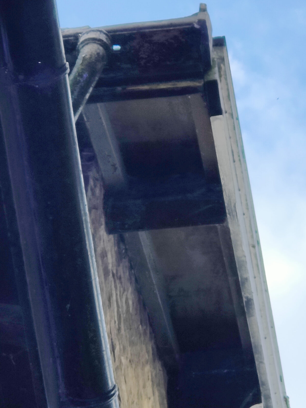

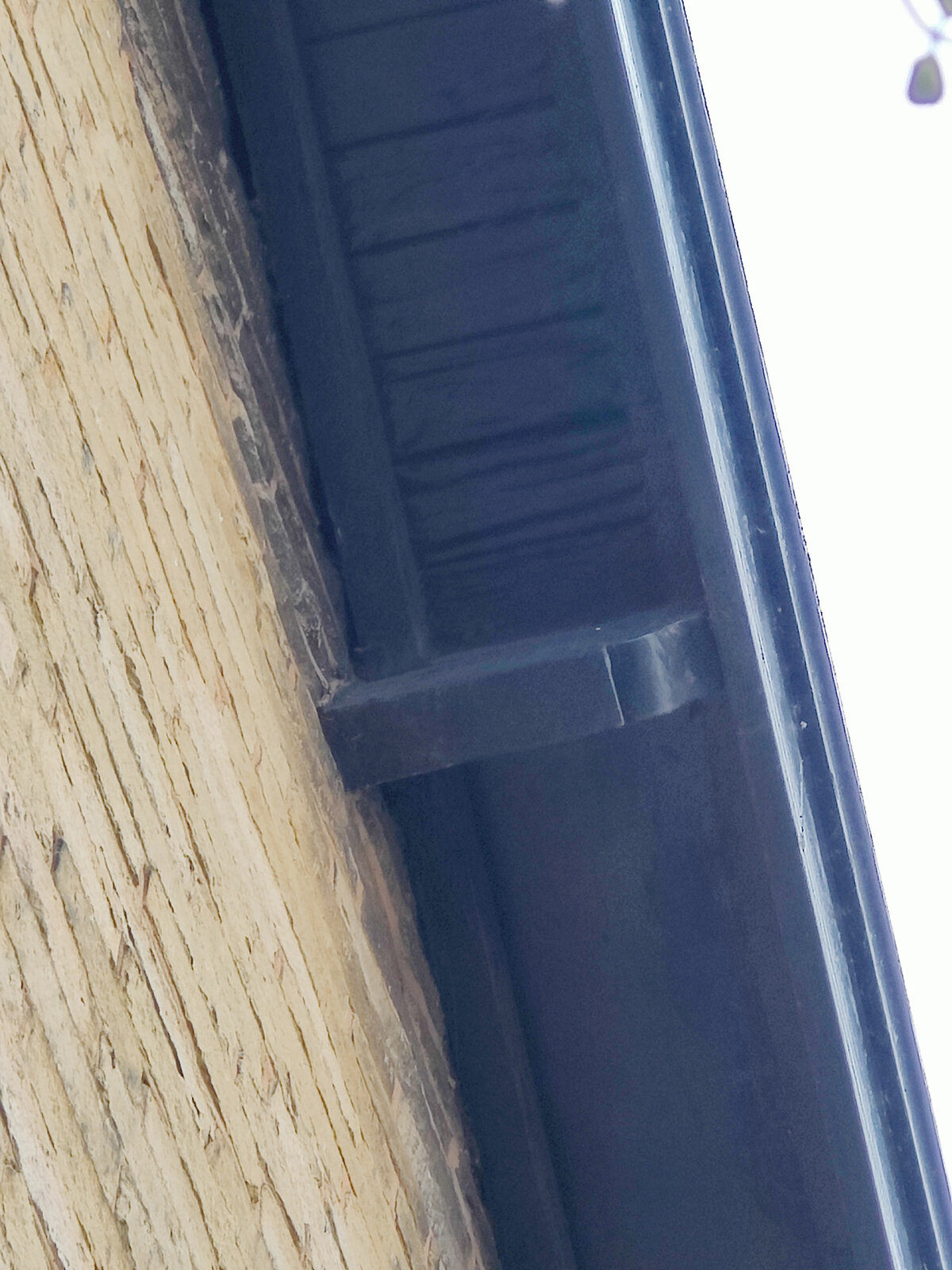

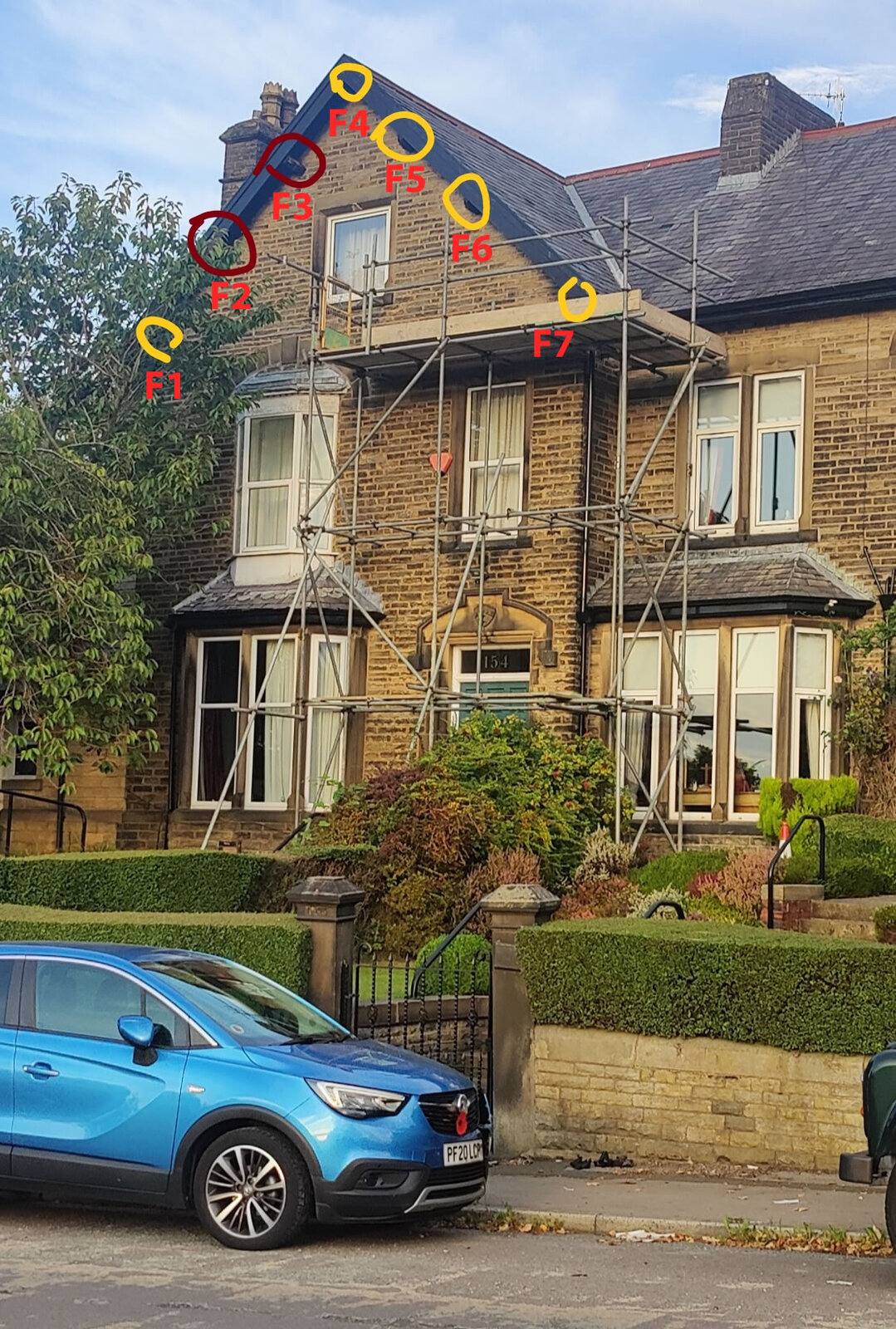

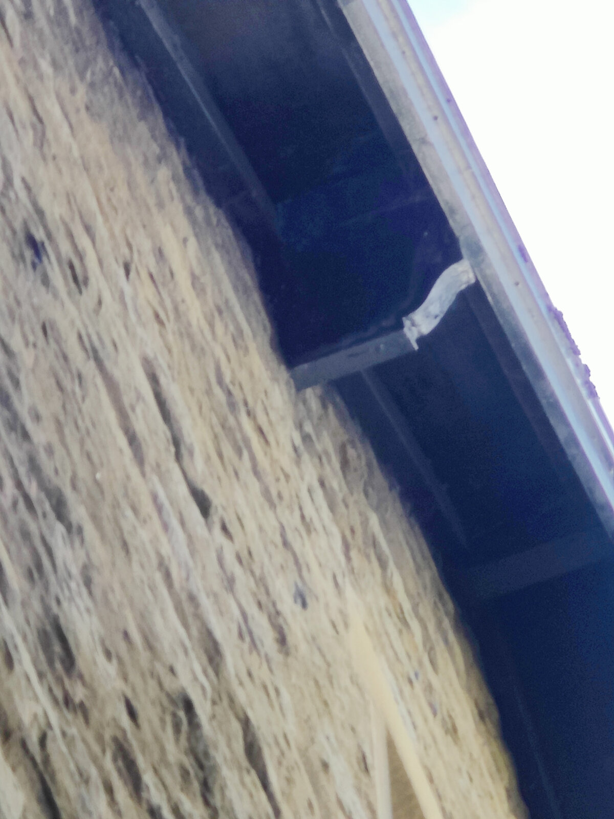

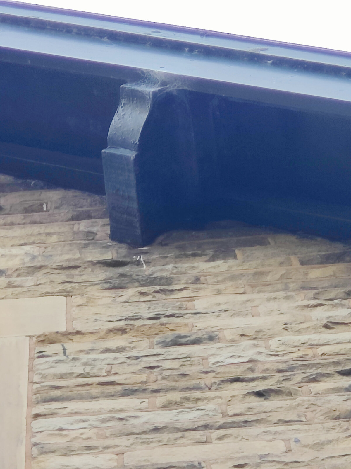

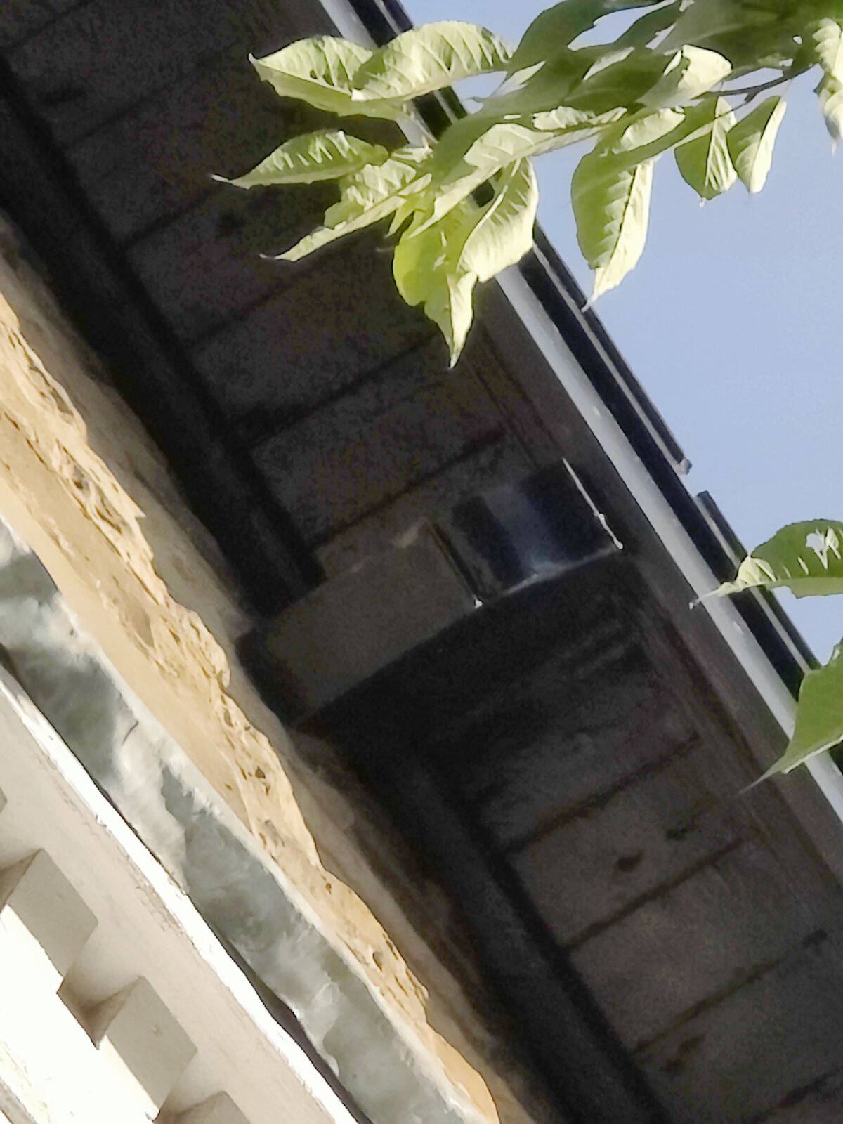

I've labelled @tell80 these pictures of the apexes and wallplates/purlins:
Front
F1, F2, F3, F4, F5, F6 (can't get F7 as scaffolding in way)
I think F1 has some rot/weathering where it meets the fascia
We already know F2 and particularly F3 are weathered and have some rot from the original pictures

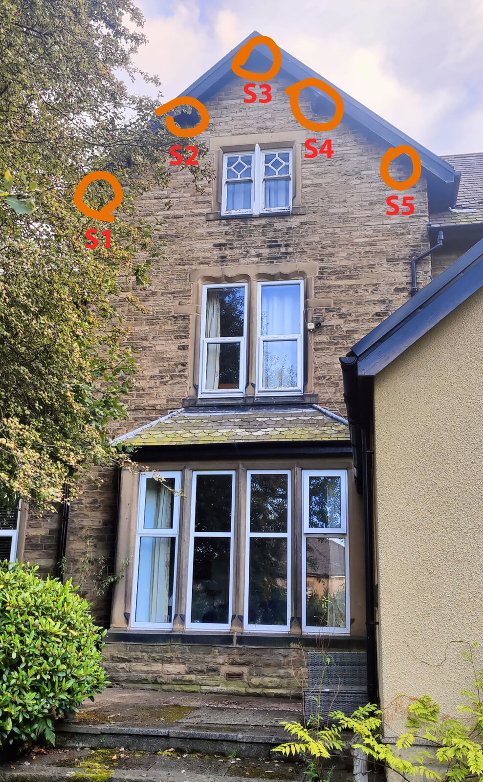

Side
S1, S2, S3, S4, S5
It's hard to tell, I think S1 could be hiding something, S5 looks a bit rotten where it meets the fascia

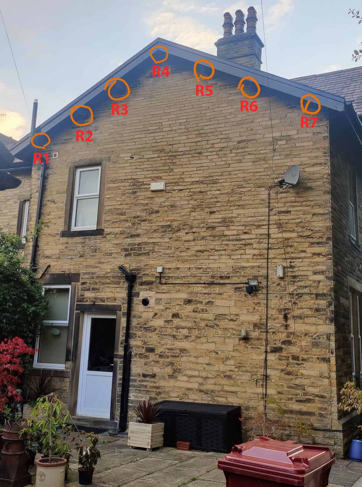

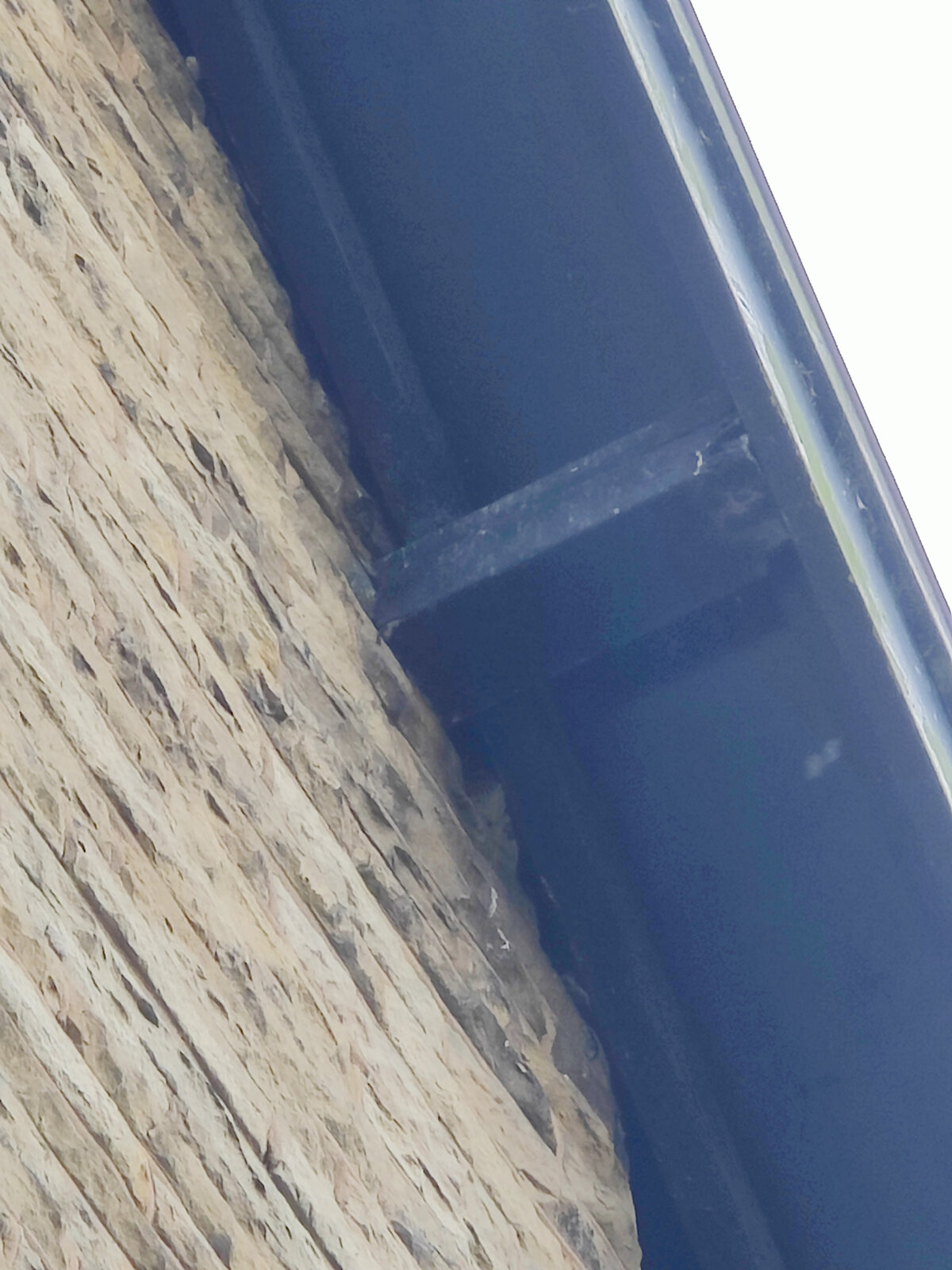

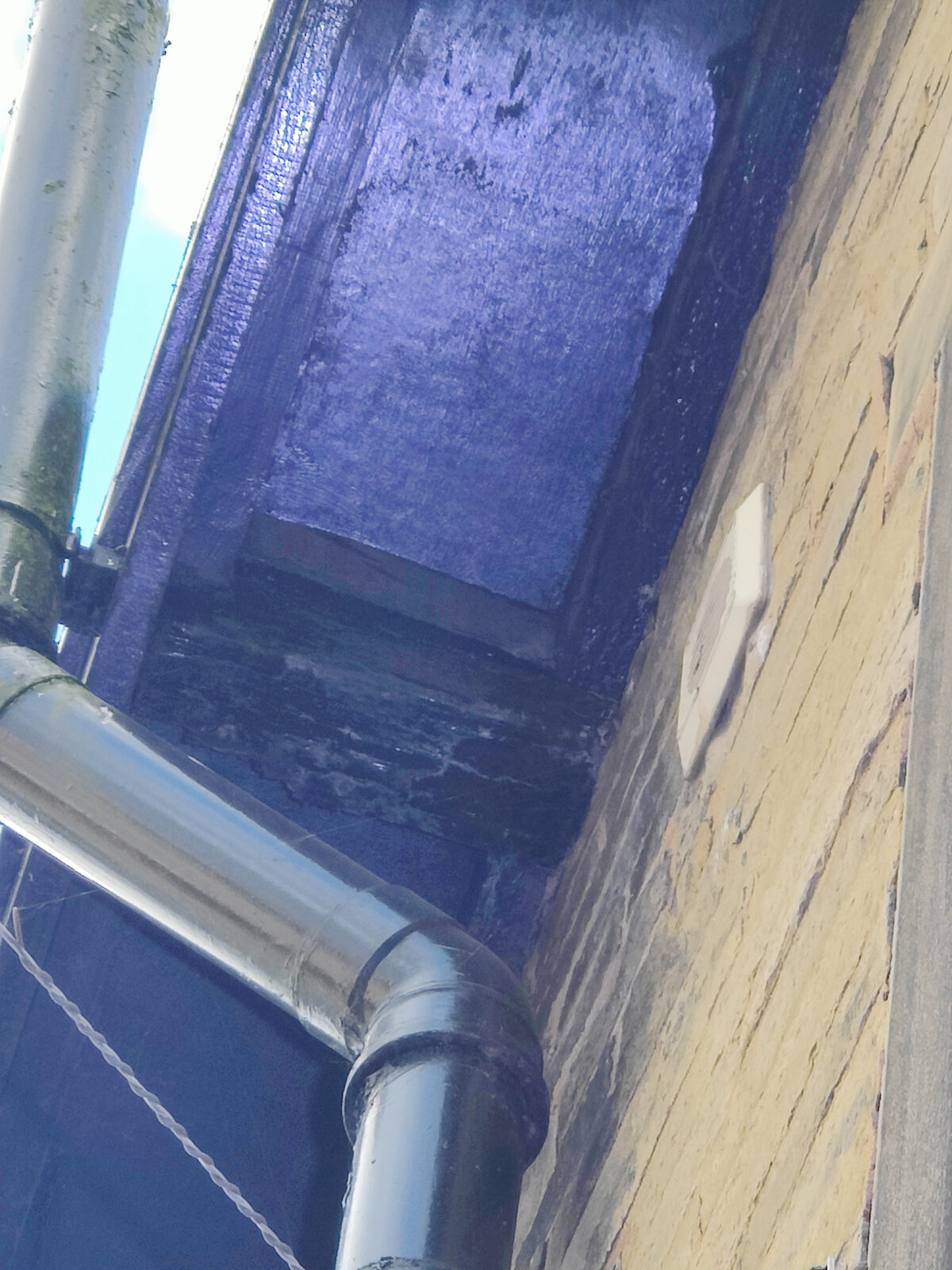

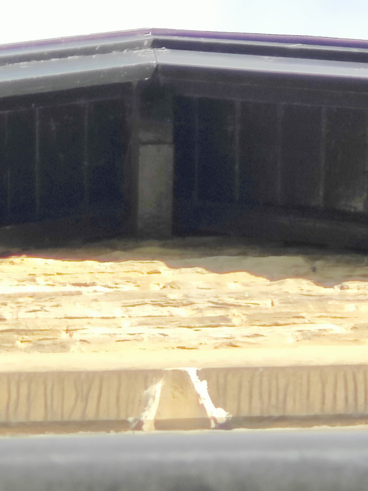

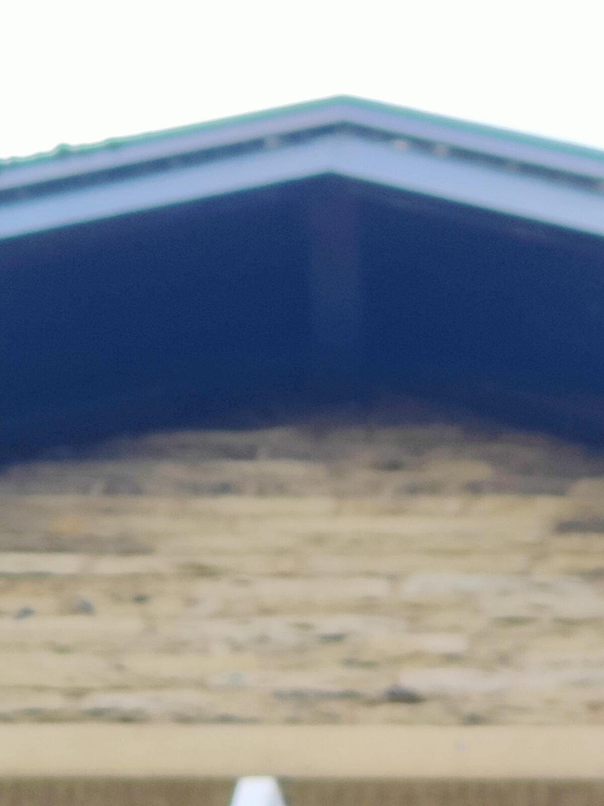

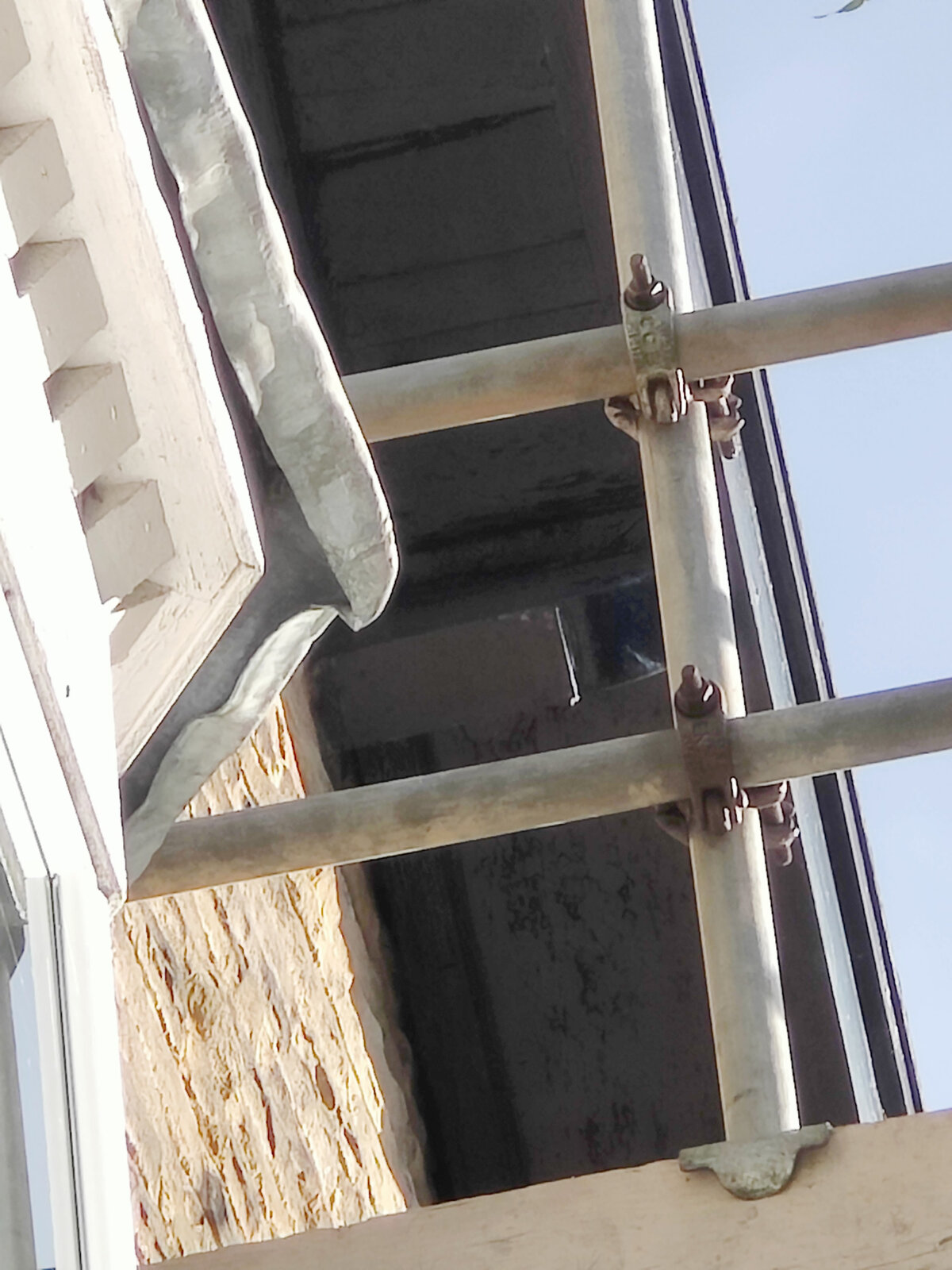

Rear
R1, R2, R3, R4, R5, R6, R7
I think R1 looks like the worst of the lot. How can this just be clad with the wrong plywood?
There used to be a chimney stack at the top in the middle, what you see on the outside R4 is sat on the top of what is left of the chimney and a larger beam is butted up next to it.
I think R7 has some rot where it meets the fascia.
