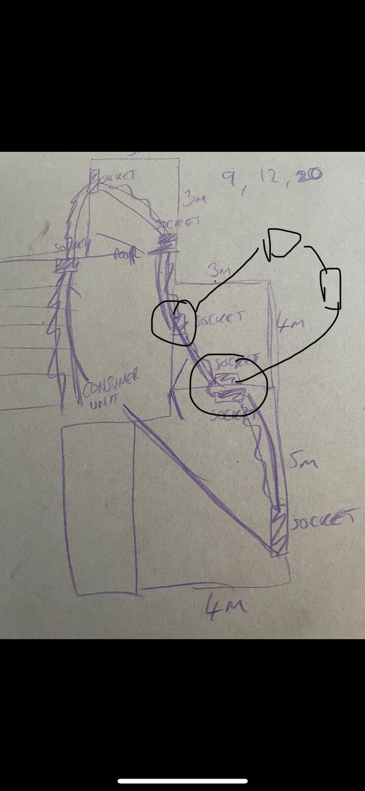

We are looking at putting some extra sockets into another room, however an electrician we have spoken to has said we can possibly extend the ring main. He has mentioned about breaking the connection between the 2 circled sockets and extending the main that way, ie connect to socket then create loop of sockets back to next one. Is that something that is able to be done?

Yes, but it requires test equipment to know if the existing ring is under the 106 meters permitted, and if extra can be added and still keep within the limits, so not really a DIY job to extend a ring final.
Thank you. Is the 106 metres the total length of cable, or square meters? What about spurring off individual sockets(?
Although 106 metres will be a f'cking big ring and yours looks nowhere near to that.
I may just get him to put spur off 1 socket to a double socket. It is only for a couple of table lamps and maybe a TV if the kids want to go in there.
Does the 106m include to and from CU, as room sizes are well under 106 square meters

These are the bits we are looking at, so we assume 20 amp centre of ring final and 12 amp even spread, so Design current for circuit Ib = 26 amps, so the line - neutral can increase by 0.59 Ω and the line - earth needs to be over 1.38 Ω.
It is not so cut and dried, as the 26 amp is not written in stone, however one can't simply add to a ring final, without considering the volt drop etc.
Today there is little equipment which will have a problem with volt drop, and the earth loop impedance with RCD/RCBO protection is not so important, as long as over 300 Ω then considered stable. But still, the line - neutral needs to be under 1.38 Ω for the magnetic part of the overload to work within the required time.
The MCB/RCBO is 2 or 3 devices in one, there is a thermal part which can take ½ hour or more to trip with over current, and the magnetic part which will take a fraction of a second to trip, so the circuit needs to be designed, so a short circuit will cause enough current to flow to trip the magnetic side, typically a type B needs 5 times the thermal current settings, plus 5% to allow for volt drop.
The problem DIY wise is the cheap (£40) plug in testers are designed for radials not ring finals, so are set to around 1.8 Ω not 1.38 Ω so it needs the expensive (£200) tester to work with ring finals.
