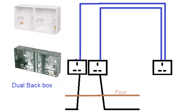

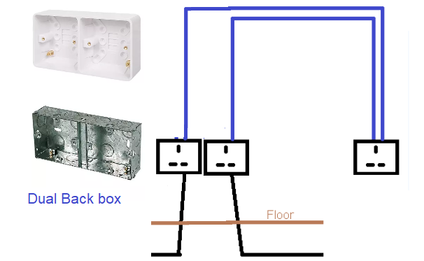

Extending a ring into extension 1
Step one is look at the original installation certificate or measure R1 + R2 or at least the prospective short circuit current or loop impedance and work out if extra cable can be added to the ring final. 106 meters is considered to be maximum length to comply with volt drop, but also depends on the over current device, for example a B32 MCB will trip on the magnetic part of the trip with 5 times rated valve, so 160 amp, using ohms law, this equals approx 1.44Ω and add 5% for safety, 1.36Ω so step one is be enquiry (reading installation certificate) or by testing, (using the loop impedance meter or low ohm meter) work out if you can add to the ring final.
Using a twin back box and two single sockets, or a double back box and two grid sockets, is likely the easiest way to split the ring. To add to the circuit the circuit will need to be RCD protected, and I think the new edition is now in force, so will need to be a type A, can't use type AC any more.

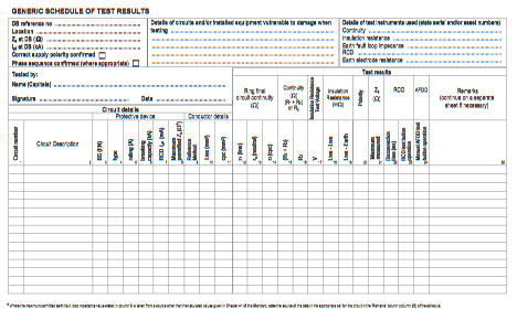

This web page goes through the procedure to test the ring final what you need before starting is to measure.
Step 3. Measure between Line to Line to get the reading for “r1”
Step 5. Measure between Earth and Earth to get the reading for “r2”
However these readings need adding to the incoming loop impedance reading, and without that your stumped. So unless you have an installation certificate giving the readings, you can't work out if you can add to the ring final.
For the inspector he knows what the maximum allowed loop impedance or prospective short circuit current is, so he simply plugs in and tests, if it passes OK, if it fails then do it again and do it properly. But that is not really what you want, what you want to know is, when I add 20 meter to the ring final will it pass before you add 20 meters.
Limit for the ring is 106 meters, so when re-wiring a house, simple, use one role of cable, if one is not enough then form another circuit. But how can you measure how much cable is already used? The easy answer is guess where the centre of the ring will be approx, and measure the sockets around that point.
You will need to fill in these forms this
one is what you are interested in, you should already have one from when the house was first wired, this
and this
tell you what the readings where when built, also found on an EICR, and from that you can work out if you can add to the circuit, other wise it needs measuring first.
