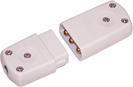

Personally I would change the ceiling rose, but I am an electrician, you could use a connector 1677271999983.png either two or three pin depending how many cores, but it depends on your skill.

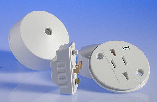

With suspended ceilings it is common to use these 1677311099424.png so the ceiling panel can be unplugged and swapped without turning of the lights to the whole office. I see no real difference between fixed socket and a in-line socket, the only problem is lack of earth connection, and without seeing how the new light is to be used or fixed can't really comment on that.

The danger with using one of these is putting the open pin end on the feed side. And they are not maintenance free so, technically, against the rules.

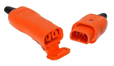

You make a good point, as an electrician just never considered anyone could be that daft, some are better than others 1677313954446.pngthe cover on some locks the plug into the socket, and the plug has recessed pins anyway. But we have to expect some common sense to be used.

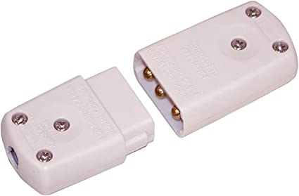

I note one person is always saying sockets should not be fitted to lighting circuits, but I use them OK not a 13 amp plug 1677314331857.pngit is designed for lighting. But 1677314476769.pngit can be used with any other appliance if I was daft enough to use the plug.
