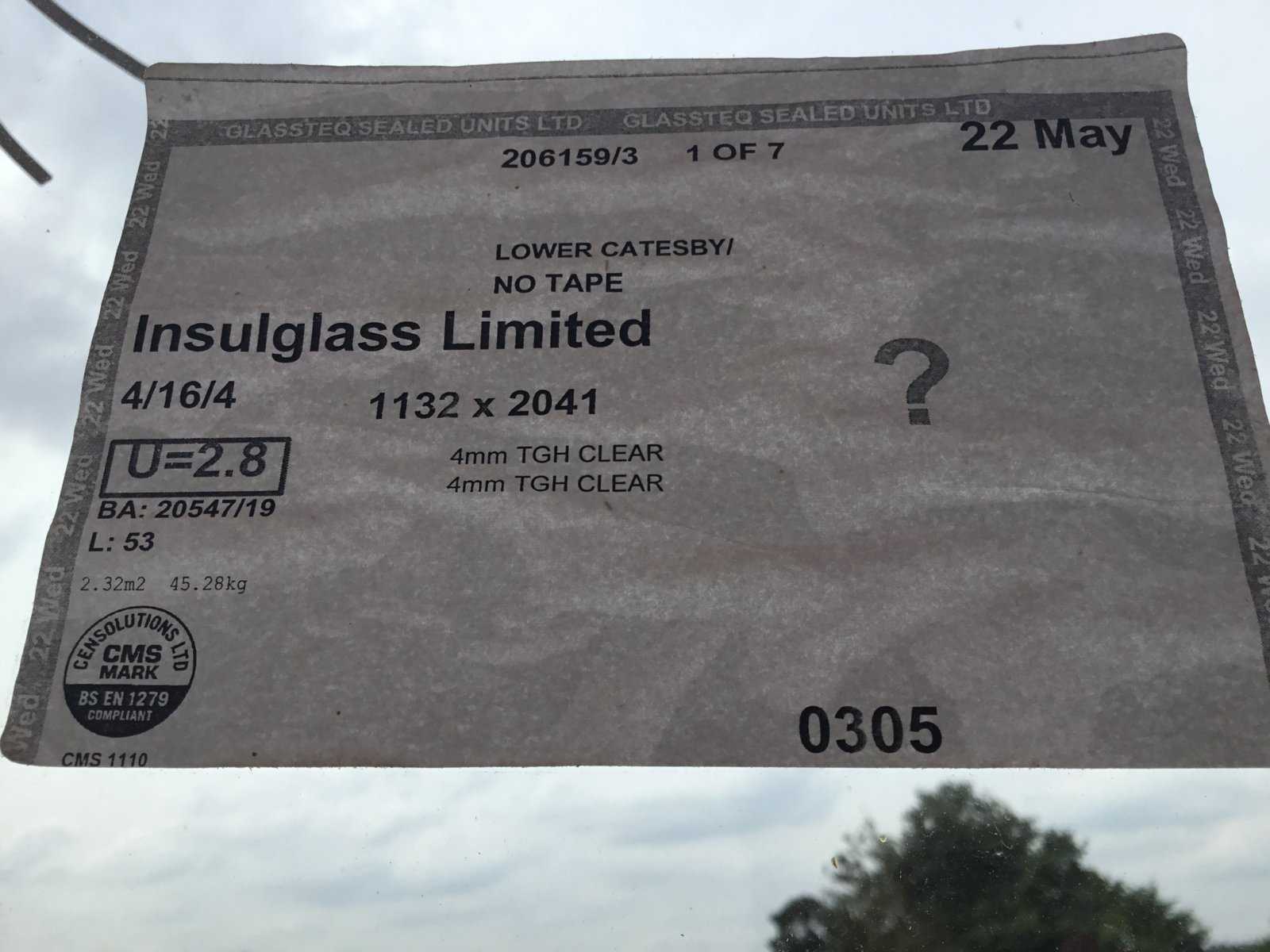

After glass was installed in our new sun room I saw it had paper labels saying U value was 2.8 (The doors are labeled 1.8 and the one opening window is 1.4 - don't know about the velux). I would choose much better and had originally asked about reflective glass which all my neighbours have because of heat - was battered back (builder tends to ignore me because I am female and ask difficult questions).
Spoke to building control (his private firm). Builder had told them it was an exempt conservatory but they agreed when I asked them to look at the plans that it is NOT EXEMPT - so windows should be 1.6. (Year round use, Solid roof with <25% glass lantern, under-floor heating separate from rest of house, new walls about 2/3 glass, existing wall has 2 large sets of patio doors to much-used rooms).
Builder now says the windows were probably mislabeled !?! and therefore no need to worry ...
I'm worrying. I think we'll boil in summer and freeze in winter (in our adjacent living rooms).
I will ask for documentation of the windows' U value as I'm ultimately responsible for meeting building regs.
As building control is a private company paid by him, can I influence them? My preference would be to replace the windows. Other options might be film on the windows and/or very good internal doors (which causes issues re thresholds...)
What do I do next? I can see it will cost quite a lot for him to put right (remove and replace windows and make good exterior clam shell window fitting). We never discussed the windows spec except for me asking about reflective, low-emissivity glass and being ignored. Most items we are asked to spec to minute detail (including very technical stuff for insulation and electrics - spend hours online researching). But imo it's his fault for cutting corners (I'm paying 120K, if he'd said reflective glass was a few K more we could have had a conversation - but we had no conversation.

What glass is it that had the label 2.8?
Are you sure it referred to u value? Could it have said 28mm? I only ask because glass labels never usually mention u value. Double glazing labels usually state the construction detail: ie 4/20/4 soft coat black spacer toughened argon and the label is usually says 'this face to inside'.
I cant imagine and door, window or velux coming with anything but low e as a standard option these days and I cant imagine the builder actually specifying non low e glass.
The difference in price of different types of glass is pretty negligible between low e and clear
@Notch7 I thought that was a great thought - but they clearly say "U=2.8" - and on the opening window it says U=1.4
So I think it's U value. But I may be leaping to conclusions.
The builder now assured me he has checked with the supplier and the labels are wrong, so everything is ok. But he still wants to switch to external doors on the inside and do a calculation. Which seems contradictory
Here’s the label.. Can anyone interpret it for me, please?
I phoned the manufacturer who said for this order, there is U value 1.6, unrated for g value, air filled
they can't tell me about emissivity as "that depends on the frame" (the last comment was after they realised I wasn't a company).
This appears to be a 24mm ‘Low E’, argon-filled, double-glazed unit. I agree the labelling is very confusing, but I actually think you're fine.
I suppose their software could be set up wrong, but if the label is correct then what you have is:
4mm tough clear
4mm tough clear
24mm double glazed unit with 4mm toughened clear glass in and out
that would have a u value of around 2.7 to 2.8
-I would expect it to say:
4mm Tough clear
4mm Tough soft coat
the centre pane u value should be between 1.1 and 1.4 (1.1 is soft coat+warm edge spacer+argon gas fill).
emissivity coating is either hard (pilkington K glass) or soft coat (Saint Gobain planitherm total)
emissivity coatings can be tested.......it needs a specialist laser checking tool.
