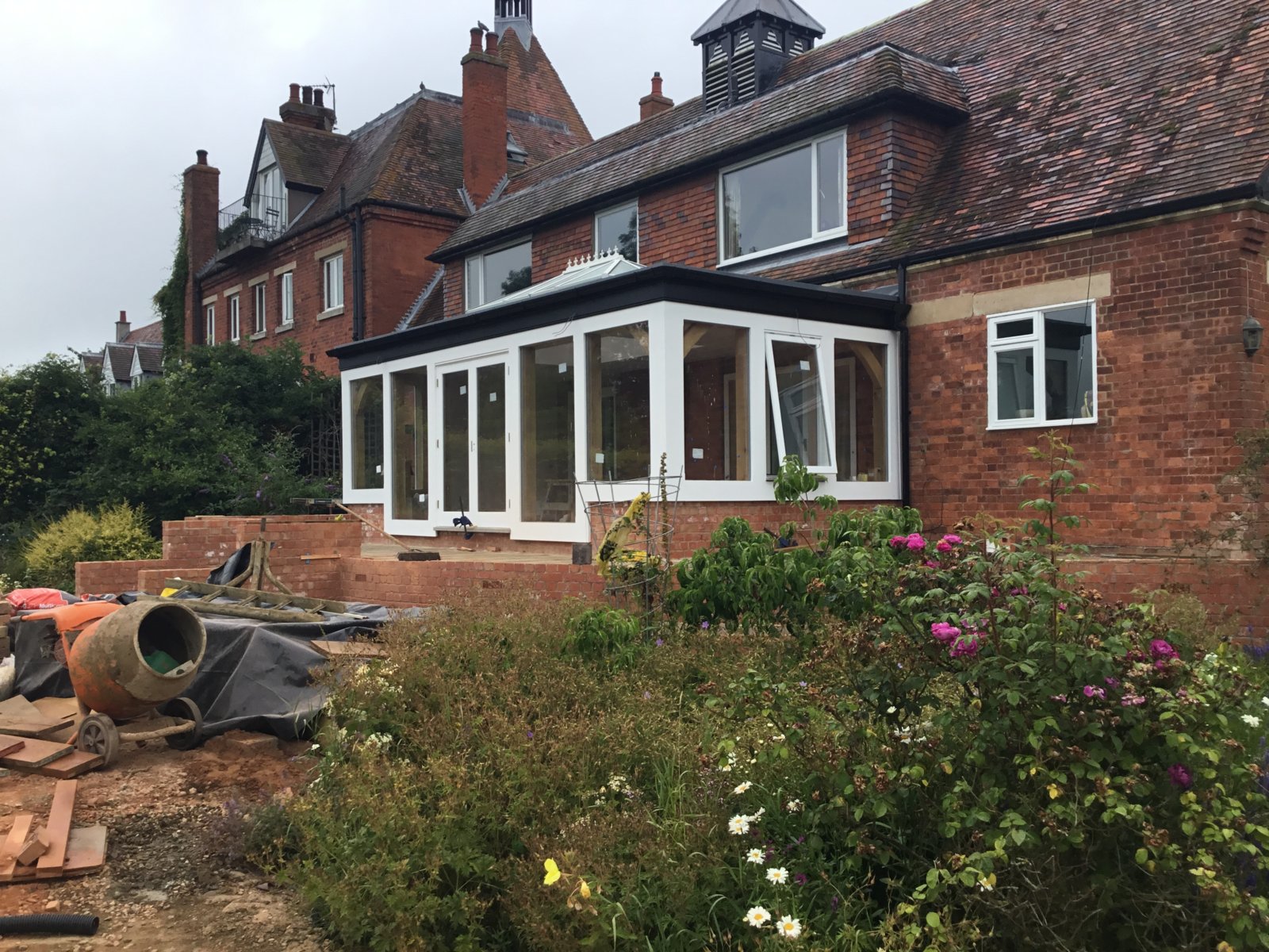

@Notch7 Thanks - that all sounds brilliant - and thanks for encouragement to sort it out, it is getting us down. Thing is, how do we fix it retrospectively? If you can help me think it through I'd really appreciate it... and thanks for the sympathy!
It is an extremely exposed spot. It faces West and the prevailing winds charge at it over fields from the south west, in winter it's fiercely cold. It is 6 feet above ground level as the ground falls away fast from the house - which makes it more exposed. I have 4 neighbours with west-facing conservatories and all of them have replaced their glass in the past 10 years because of excessive heat in summer. This is why I raised it with the builder! I think we need low e on the wall glass because of these conditions.
As to the spec -- the room is 7m x 3.2m. I'll post a photo!
I don't know what glass we have in the lantern. No labels...We have two self opening veluxes in the lantern. The lantern is about 20% of the roof area and the veluxes amount to 1/3 of the glass area.
There are 7 panes other than the doors and opening window. Two of those are 2m high, 1.1m wide. 4 are about 1.6m high x 1.m. That's a lot of glass, and it's all just double glazed with toughened glass, no argon or coatings. The U value is either 2.8 or 1.6 depending what spec the builder manages to prove he has installed.
The doors and one opening large window are labeled "label on inside" and one of the panes is 4mm S/COATG. I presume this means the inner pane has some sort of soft coat.... their U values are better, 1.8 for the doors and 1.4 for the window. Doors are 2m x .9m and the opening window is 1.6m x 1m
The panes are clam shell fixed with acoya onto oak beams. It has all been sanded and filled and painted. To replace them will mean removing gutter, finding all the fixing holes, unscrewing, refitting and making good. Not impossible but not cheap - I would guess it is 3 weeks' work at worst for one person (one carpenter built the whole thing - from seasoned oak - amazing work but very slow. We were told 16 weeks and so far it's been 9 months). I am considering paying to redo it, since although I asked for low e, he says he doesn't remember and I can't prove it (no documentation). Since we usually talk about every millimetre of the spec, I expected to sit down and have a proper discussion about the glazing at some point, but it just arrived one day.
As to the private building control company - I think they do two inspections and rely on what the builder tells them. He does all the calcs for them. But they seem at least to be asking for evidence of what spec glass he has used. After the first inspection the BC inspector thought it was an exempt building and probably would always have thought so if I hadn't phoned him.
Here’s a picture
(They have built a road of hardcore 4m wide through my garden, which is devastating... but that’s another argument waiting to happen.. they used 7 ton vehicles which I don’t think was necessary)
I still think it looks nice!
