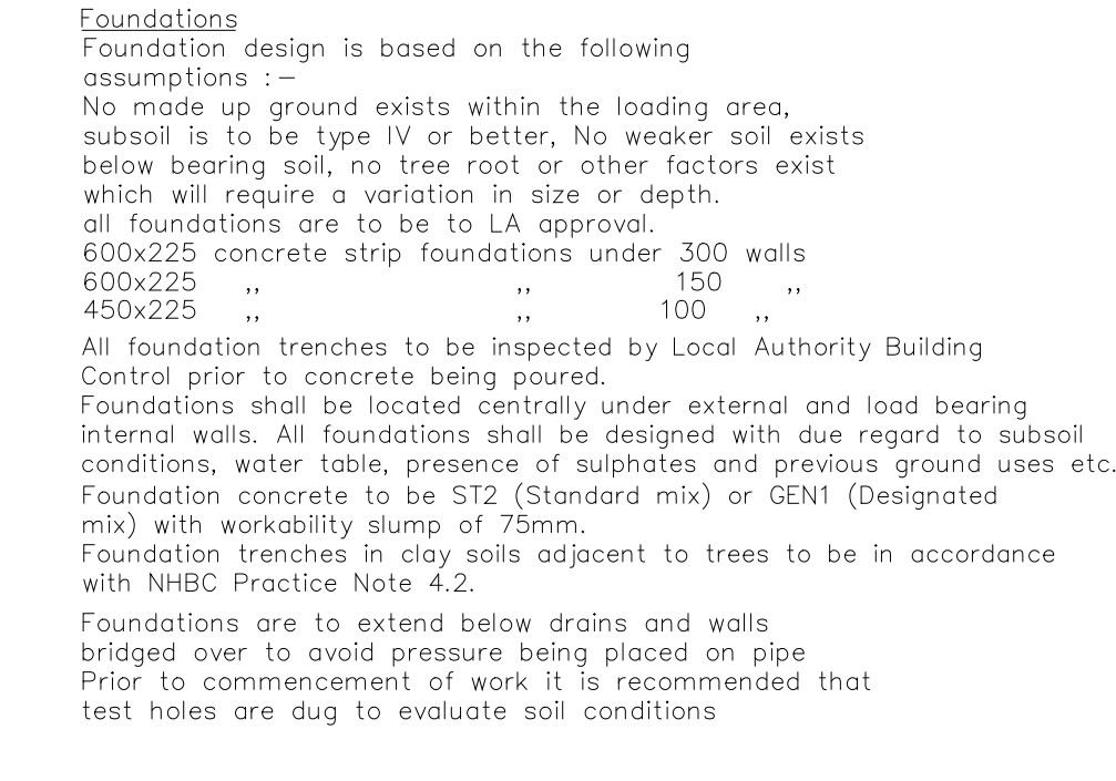

OK, should I genuinely look to complain and get refund on the work my designer has done? I'm otherwise very happy with what he has done for the price.
I beleive he does have knowledge of the potential cround conditions, hence why he has specified beam and block rather than a slab. I didn't know that he should be specifying exact foundation designs. Have you got an example you could share for me?

Usually in the plans, where they show the fundations they write something along the lines of: xyz mm concrete filled fundations subject to Building Control approval.
So the rule of thumb is always to contact BC before excavating and ask what they want.
Most times they will say to dig down a certain depth and then they will come out to inspect.
At that point they would either approve the footing depth or say what's required.
Builders know this and quote accordingly to a set m3 of concrete.
Any extra is extra and it's usually stated in the quote.

This is what is said... and that's all. BC also give guidance on their website which all makes sense. What doesn't make sense is that I essentially have a retaining wall about 1.2 meters away which drops down about 600mm... my existing house footings go down 860mm on what appears to be (test hole) solid ground so they go another 260mm deeper than ground which isn't that far away. I would have thought that it would need to go down deeper than 260mm.

Just for an update on this. I have spoked to building control who dont seem to see it as an issue. They spoke about making sure that at the bottom of the foundations the loading is taken uo at a 25% angle and as long as that doesnt cross over into the retaining wall then it should be fine. They also said they would be happy to come have a look just book it in - which is exactly what I will do. They were very helpful.
