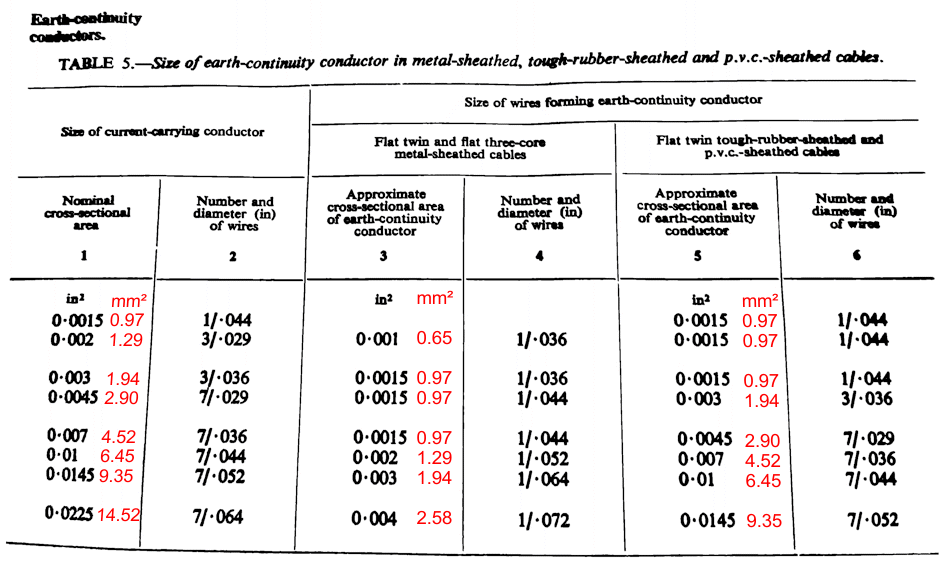

You should measure the CPC(earth wire) as well.
It should be 1.67(2.5/1.5) x 0.5 = 0.835 if modern cable (single core), or
2.5(2.5/1) x 0.5 = 1.25 if old imperial cable (stranded cores).
However, I have a feeling that early metric (solid core) may also have been 2.5/1.0 - was that the case?
Kind Regards, John
Imperial was imperial.
Metric was indeed 2.5/1.0 and later 2.5/1.5.
The 2.5/1.0 was what I was referring to.
I realise that. My point was that EFLI said that imperial was (I presume he meant 'the equivalent of') 2.5/1.0 but implied that all metric was 2.5/1.5 - although, as I suggested and you have confirmed, early metric was also 2.5/1.0.

These are the imperial cable sizes for flat cables with the metric conversion added in red.
