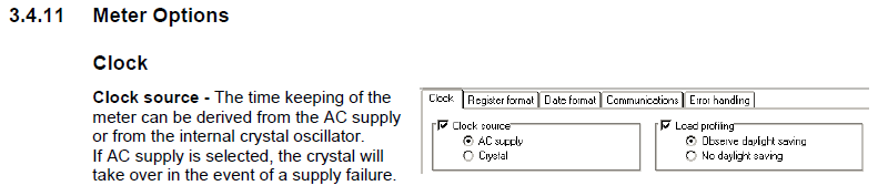

I don't know (at least, can't remember) about the previous ones, but my present meter, although potentially pretty 'smart', does not have its ('optional') communications module installed, and I find it hard to believe that it would have a separate/additional 'communications' facility built in just for timings.. It also has the E7 times marked on its case, which rather suggests an internal clock, rather than being 'controlled' from elsewhere - and the fact that those times are 'GMT throughout the year' also seem to suggest that there is no 'external control'.
To resolve these uncertainties, I'll fish out my meter's manual later, and have a read!

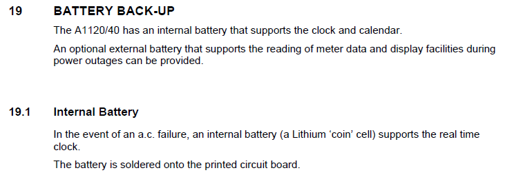

Indeed - and now I've found the manual, everything is confirmed ....
Given that the battery is 'soldered in', it presumably could not be replaced by the likes of a 'meter changer'.
