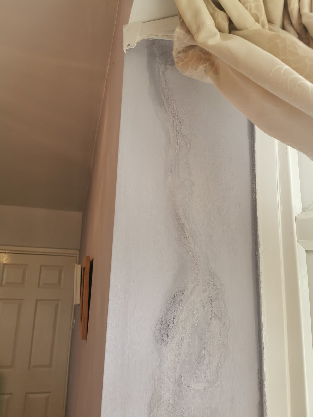

Hi all,
We're about to have our sitting room wall treated for rising damp.
From doorway in hall, to window bay in sitting room.
The builder has sent an FAQ that states that, once they've finished, that we can apply some paint 4-weeks after, but shouldn't decorate for at least a year.
Is this correct?
We were looking to put the house up for sale in January.

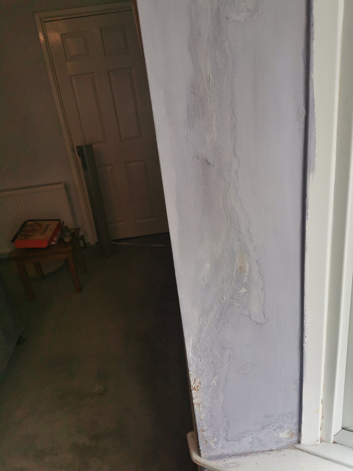

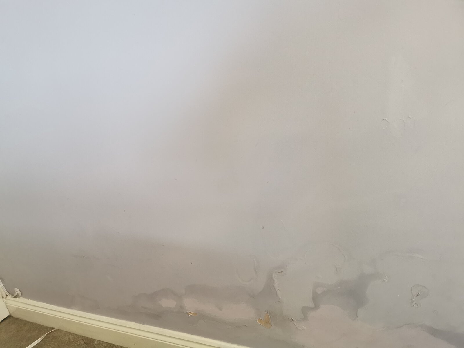

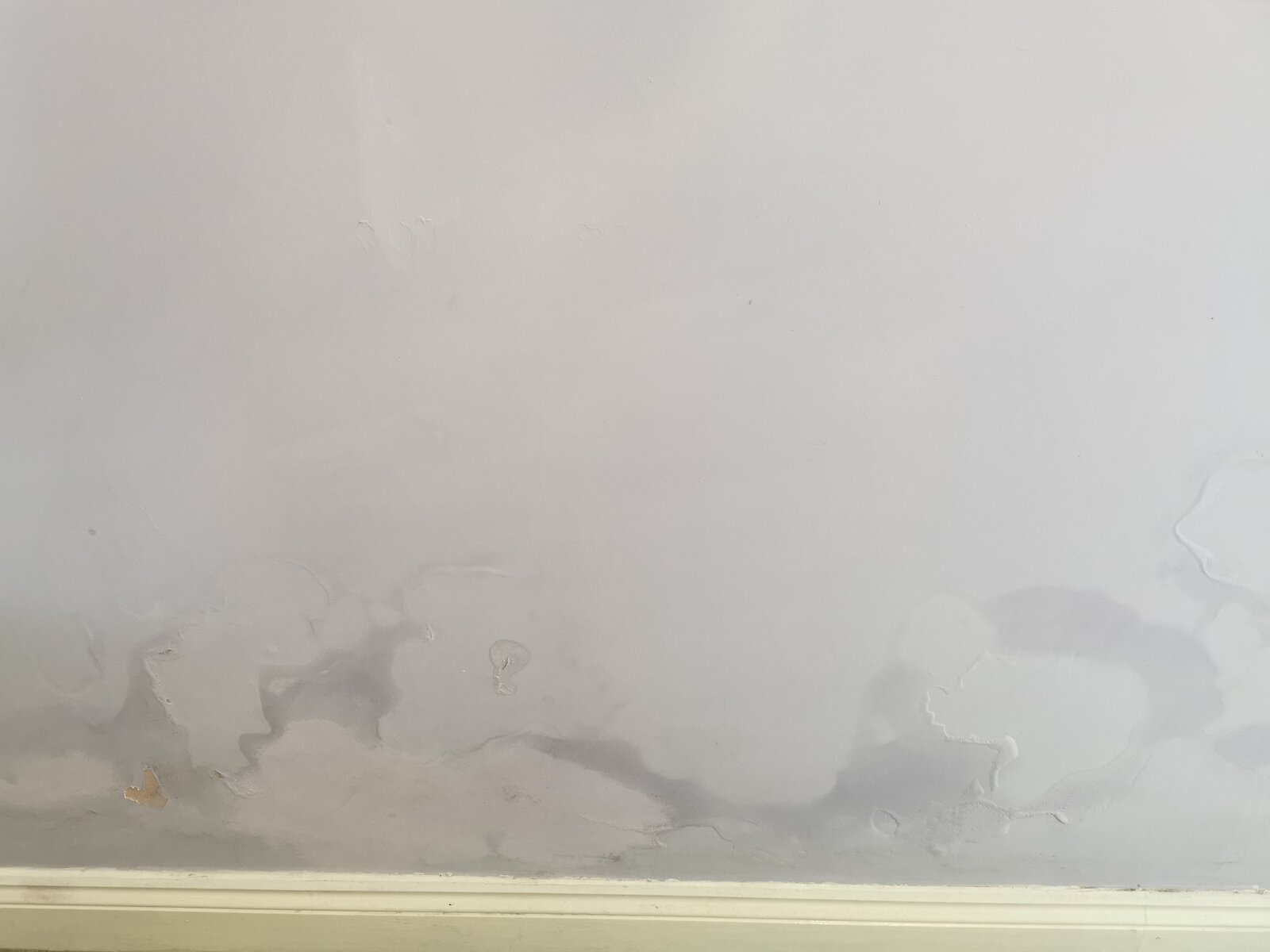

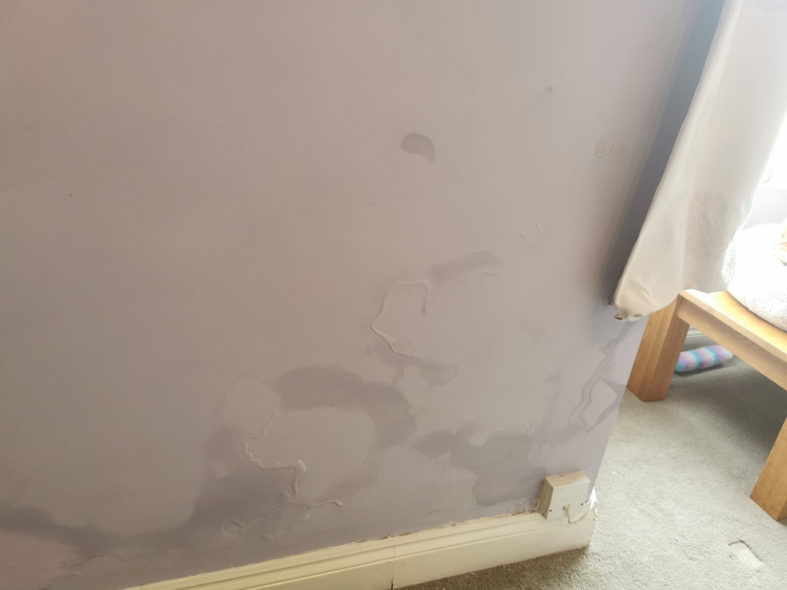

Hi,
Here are the pictures.
img_20240706_102827-jpg.348157

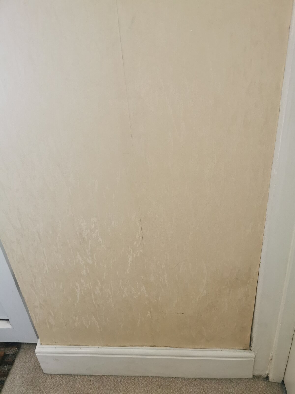

Water is running down that wall from above.
Is there a bathroom up there? A chimney? A gutter? A roof leak? A pipe plastered into the wall? A bay window? A porch roof?
Did somebody tell you it was "rising damp?"
His report said the following:

I'm not convinced that your problem is due to water in the ground soaking into the wall from below; in which case it is not "rising damp"
And I see no sign that the source of the water has been identified, in which case it will not be cured.
How old is the house? In London, DPCs were compulsory from 1875, and are usually slate, which does not wear out. Can you see it on the outside walls, about 2 bricks above where ground level used to be when the house was built?
Is the floor concrete, or wooden with a ventilated void beneath and airbricks visible at the base of external walls?

I think damp company is doing what they normally do, alarm and scare people.

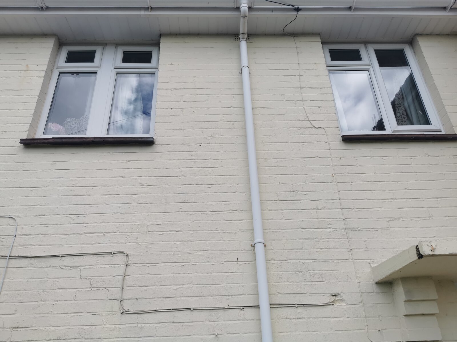

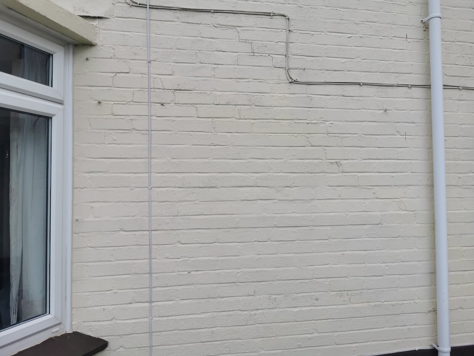

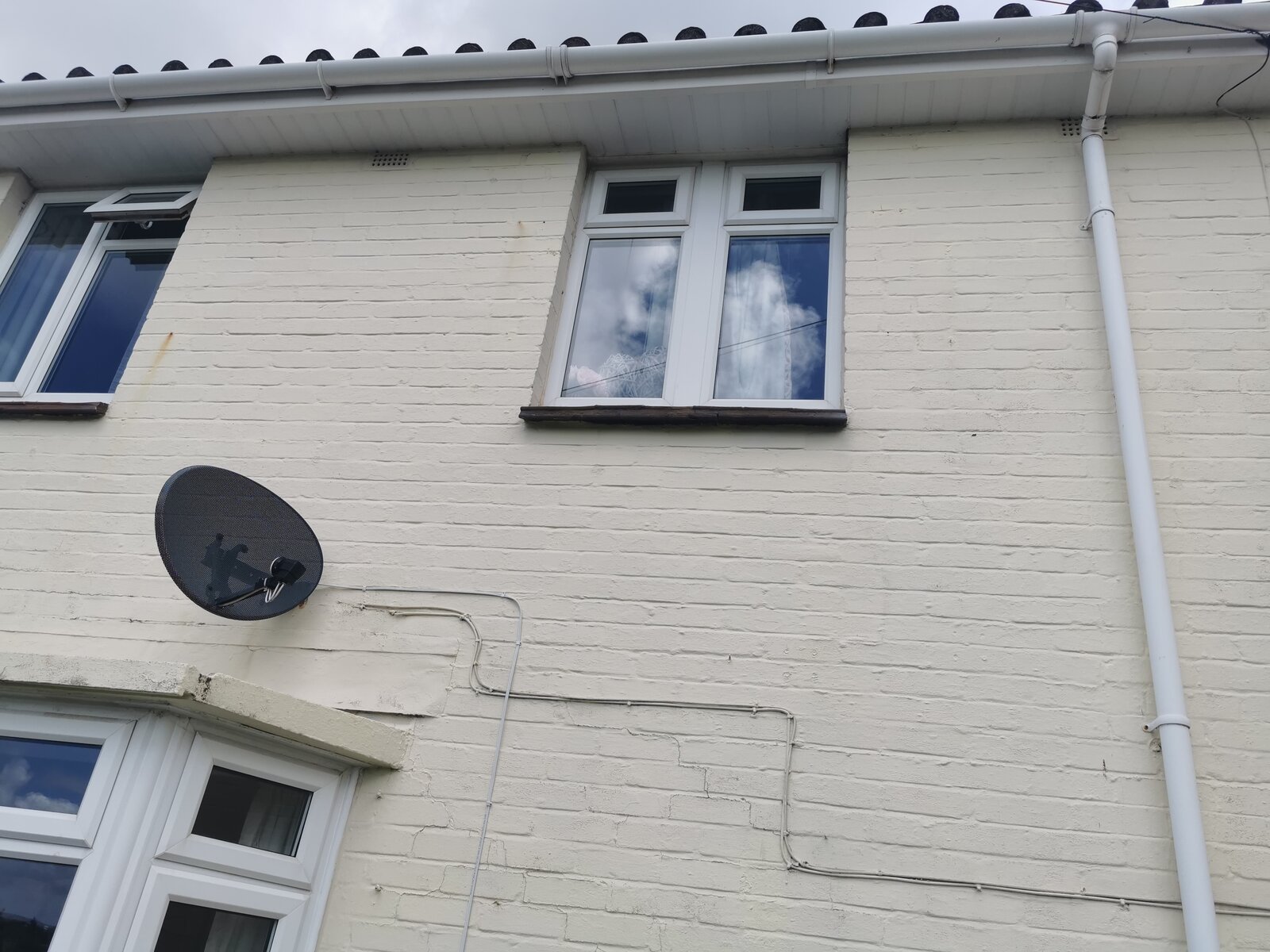

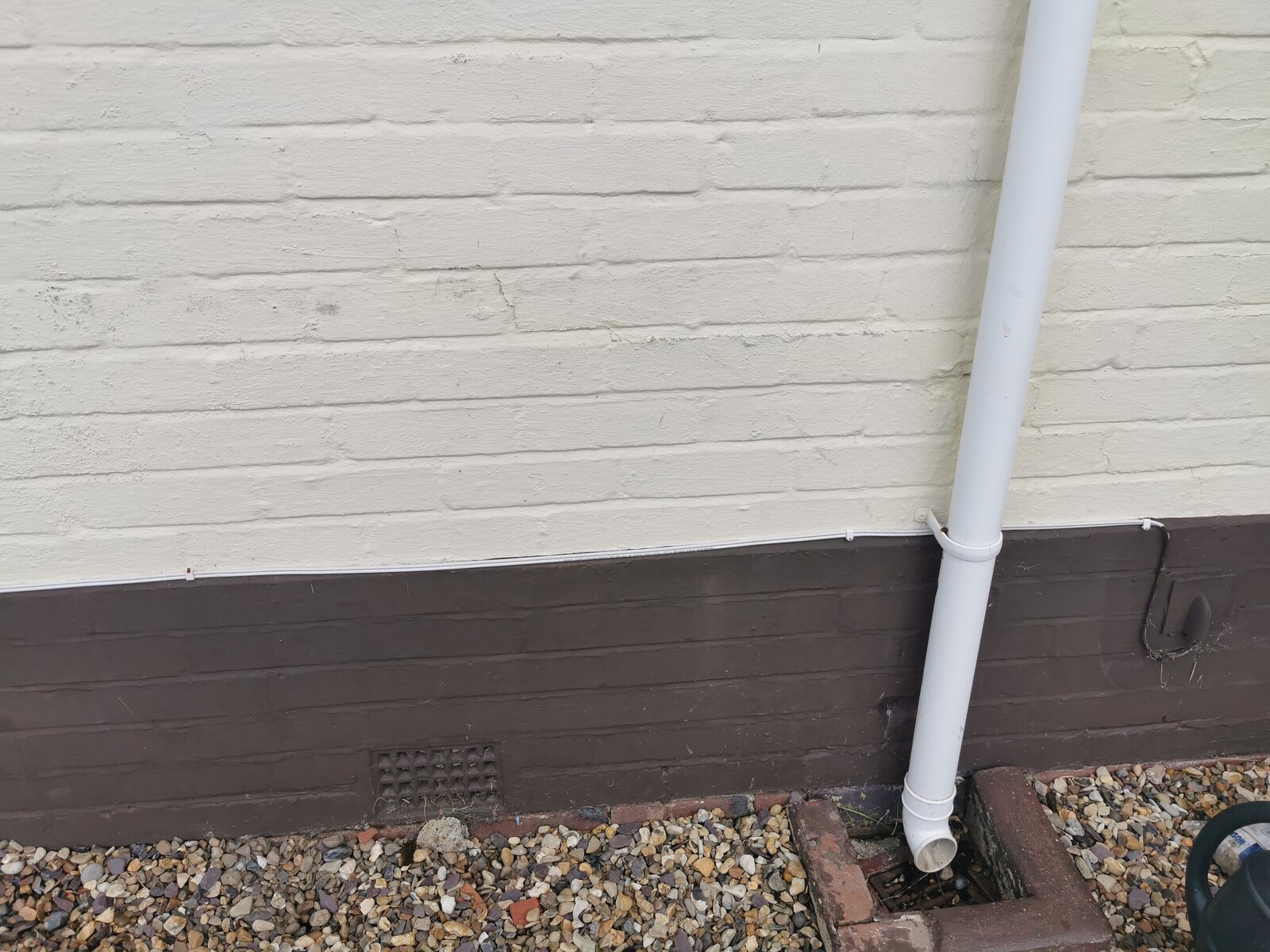

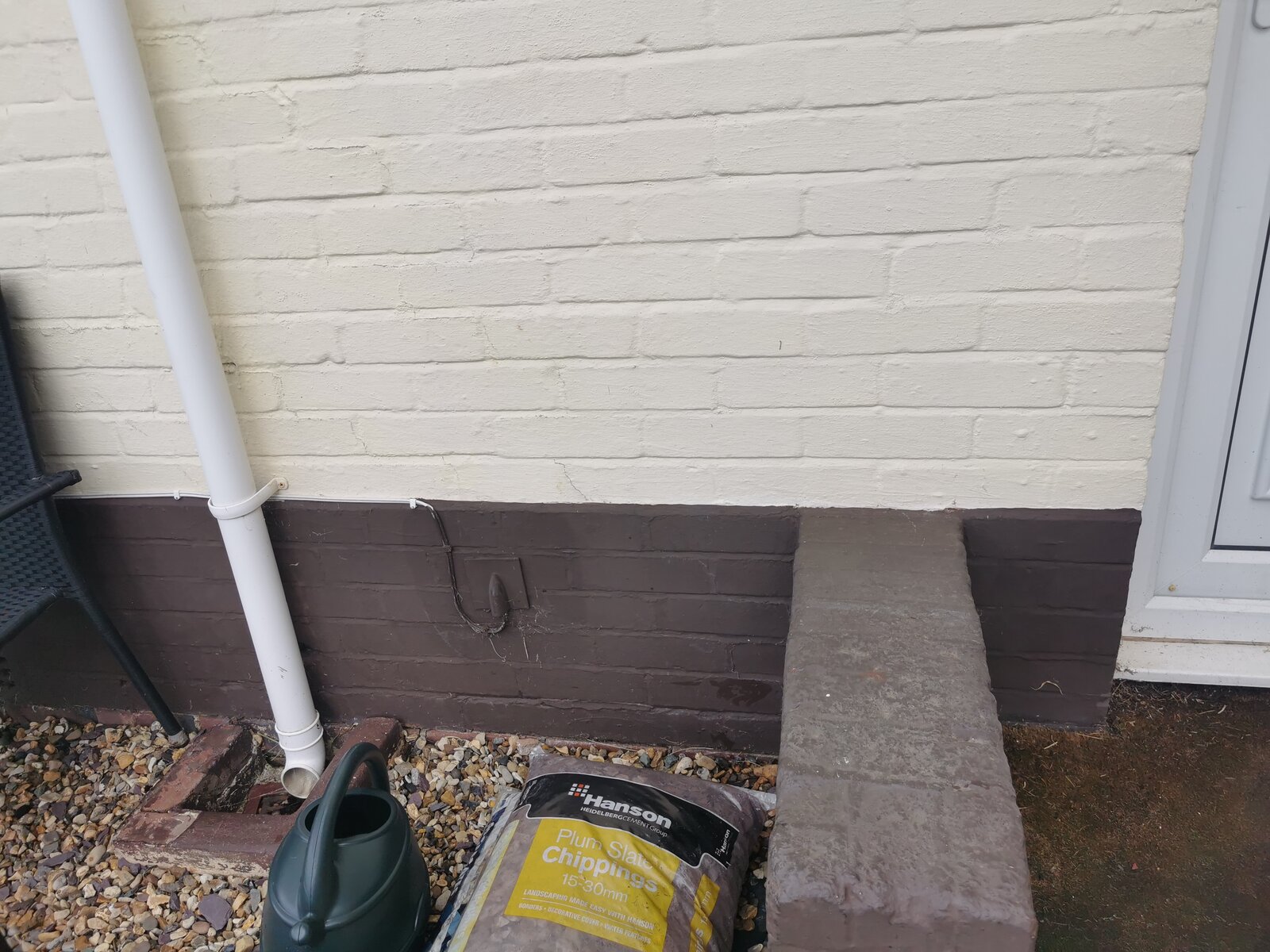

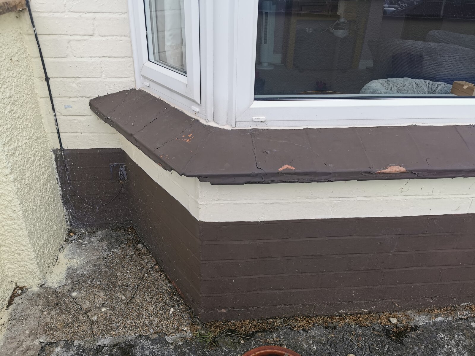

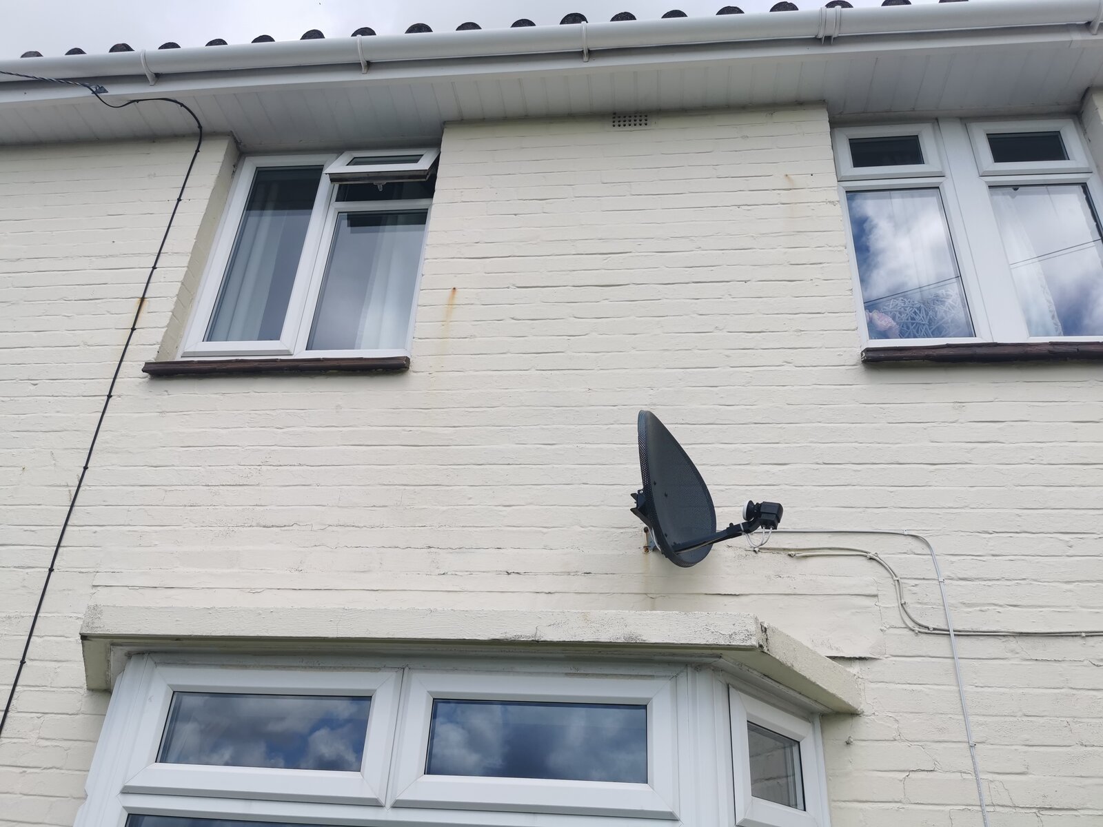

As above, check outside first. Is that an outside wall in first pic?
By the window could be coming from above....

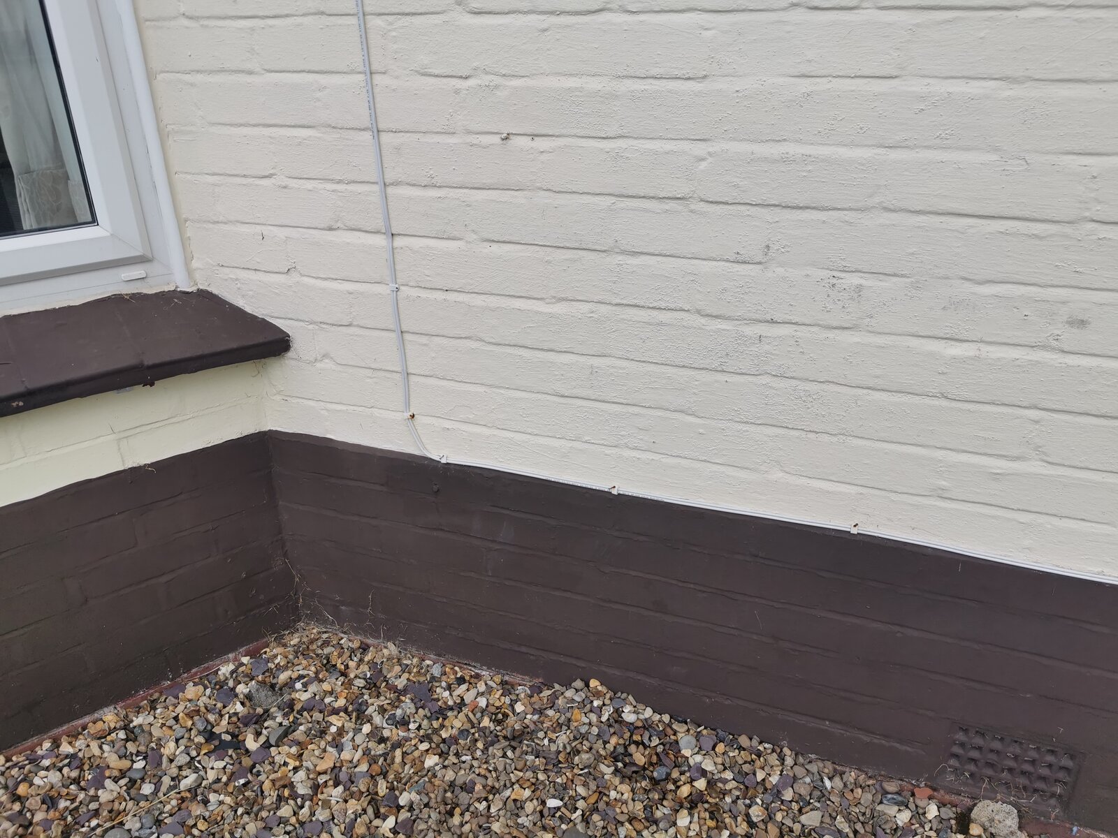

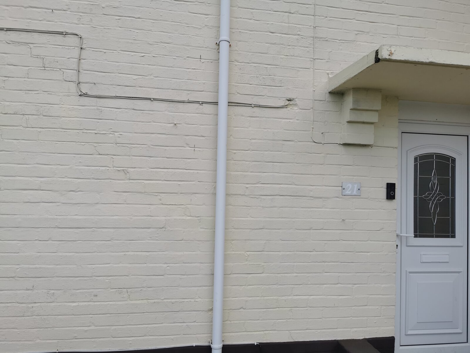

you mentioned it's an external wall, so show us the outside. All the way up to the roof and showing the gutters, downpipe, any plumbing overflows, and any bay window roof and gutter. If there is one, photograph it from an upstairs window as well if you can
It's an external wall.
With vents in the outside wall.
The first pic is of the hallway, between sitting room and front door. The damp is coming through here too, as you can see the wallpaper is coming away from the wall and darkening.
I have taken pics of outside wall and on top of window bay.
