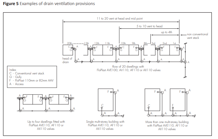

As for the diagram you posted, what is this ...
?? .... and what is meant by this, and what is it pointing to:
... and, as a matter of interest, where does that diagram come from?
Kind Regards, John
I think it just means there is more to the right but the diagram stops there.
Perhaps just referring to the text to the left, i.e. numbers of non conventional stacks (AAVs) and what is required as the number of dwellings goes up. Not entirely clear.

Possibly, but it looks as if the arrow may be pointing to the 'short' vertical pipe rising from the "up to 4th" dwelling from the right (presumably the most downstream end). It is a very badly drawn and annotated diagram!
So, without being sure what that 'unconventional stack' may be. the depicted line of 20 dwellings has only two conventional open vents - at the 10th and 20th dwellings from the most downstream end - is that correct? If so, where does that come from - is it based on some regulation, or is it something made up by FloPlast?

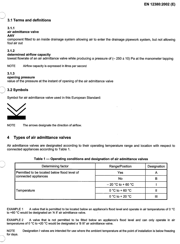

The document does not seem to include any explanation of what (if any) additional design features are included in the AX110 ('external grade' AAV) to avoid freezing of water 'jamming' the valve.
Not sure, they are tested in line with the appropriate BS and that is where the designation (A1 in this case) comes from.
Yes. I don't know where their info comes from, I've had a look at a few BS docs but nothing apparent. I'd hope it is based on ventilation requirements for drainage systems, but I'd be guessing. I'll do some more digging when I have time.
Fair enough. Does that "A1" designation relate specifically to exterior use?

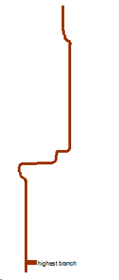

I thought that I should perhaps explain/illustrate why I am so attracted by the possibility of using an external AAV. The present vent pipe, which is approaching 10 metres in total length, is anything but straight and vertical, and never could be. It has to get around two gutters, go across a small bit of flat roof and also go around a 'step' in that flat roof.
What I want to try to avoid, after removal of the present disintegrating cast iron, is replacing it, 'like-for-like (route-wise) with plastic - quite apart from all the the hassle (and access to some bits is not all that easy) it would cost a goodly amount in 'fittings'! The below is a rough diagram of the present situation, and it would obviously be a very attractive idea to be able to replace it all with just an external AAV (near the bottom of my diagram)!
Kind Regards, John
No, suitable for freezing temps and installation below an appliance spill level, the external Floplast is an A1,
Don't see why not, looks like a good solution.
Thanks. That's what I really meant - maybe it doesn't explicitly say 'external', but suitable for use down to -20°C (presumably including when 'wet') is good enough for me!
