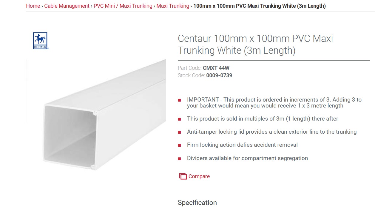

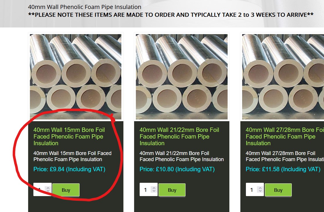

Using 100mm square trunking and 40mm wall insulation would be the easiest, quickest and most practical if you ever needed to access the pipe again.​
https://www.cef.co.uk/catalogue/pro...xi-trunking-complete-with-lid-white-3m-length
https://insulationandlagging.co.uk/Pipe-Insulation-Lagging/40mm-Wall-Phenolic-Pipe-Insulation
That's a good shout but wondering if it's suitable for external use and if the insulation would be large enough for the winters we look like we're going to be getting.
