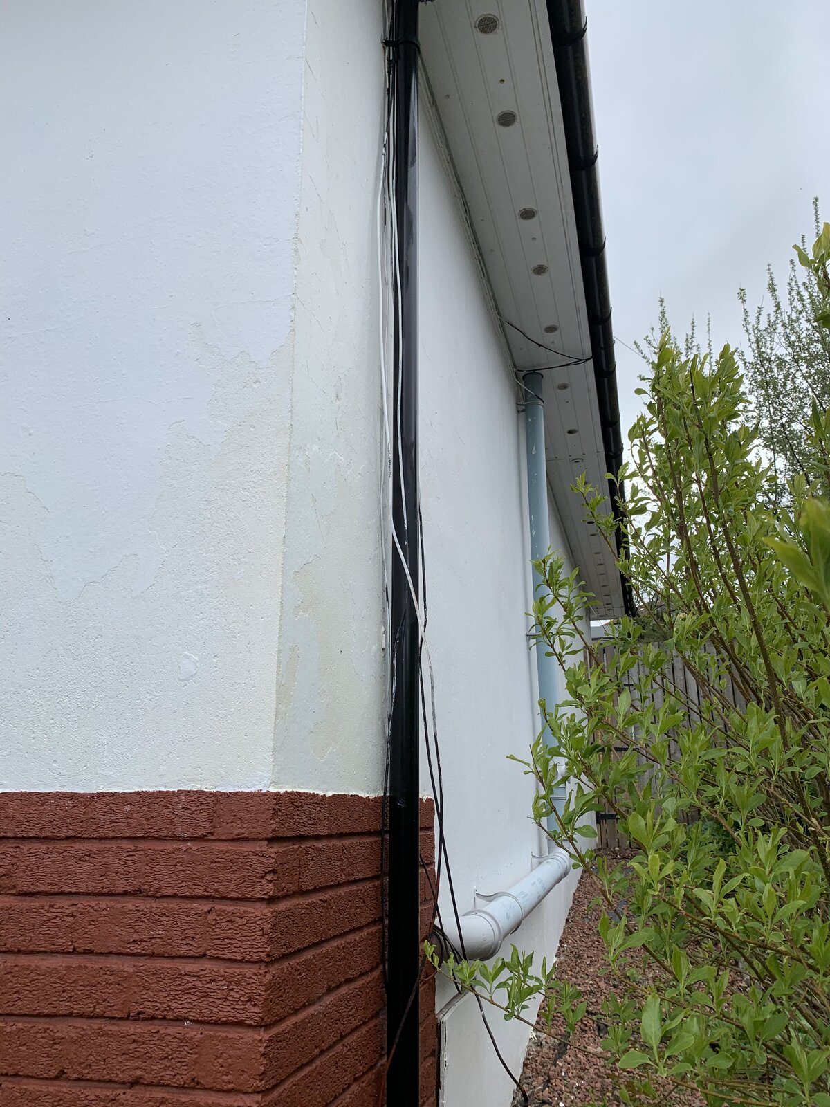

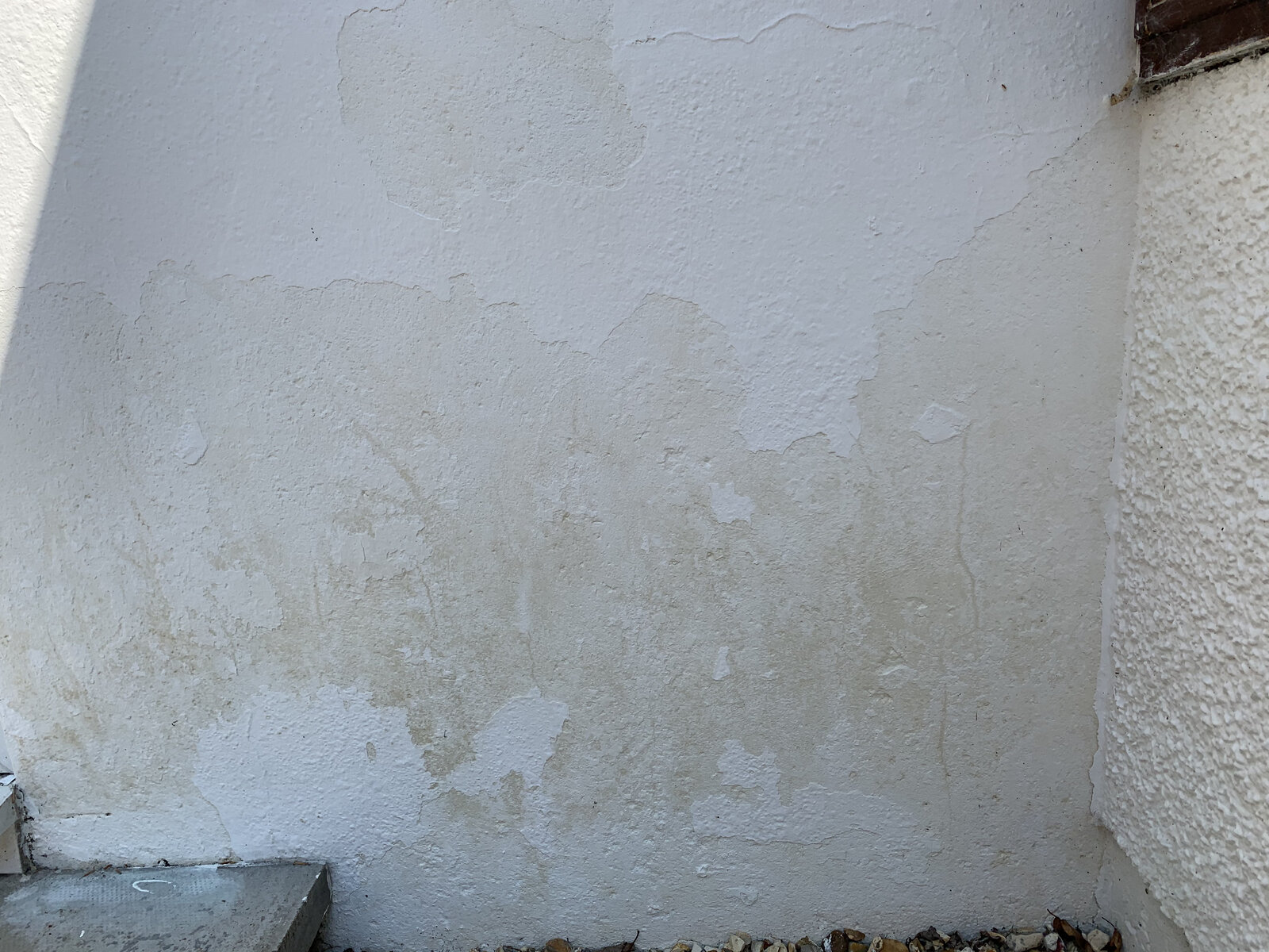

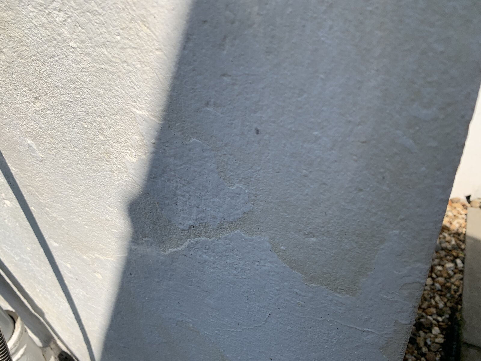

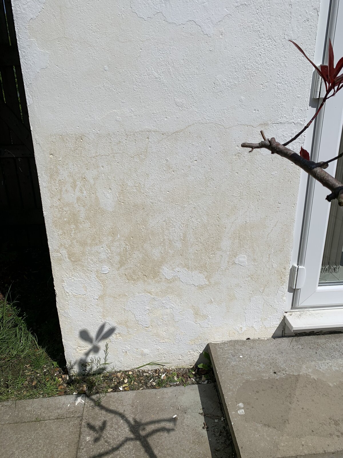

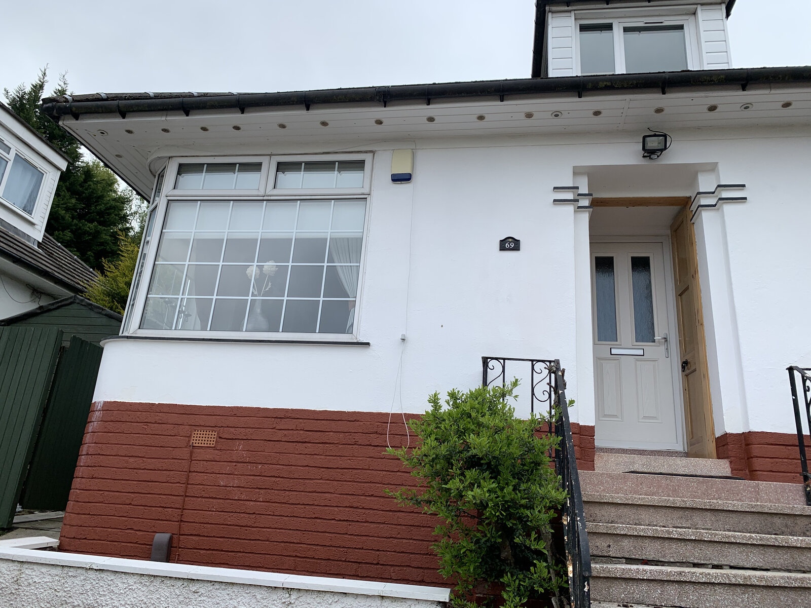

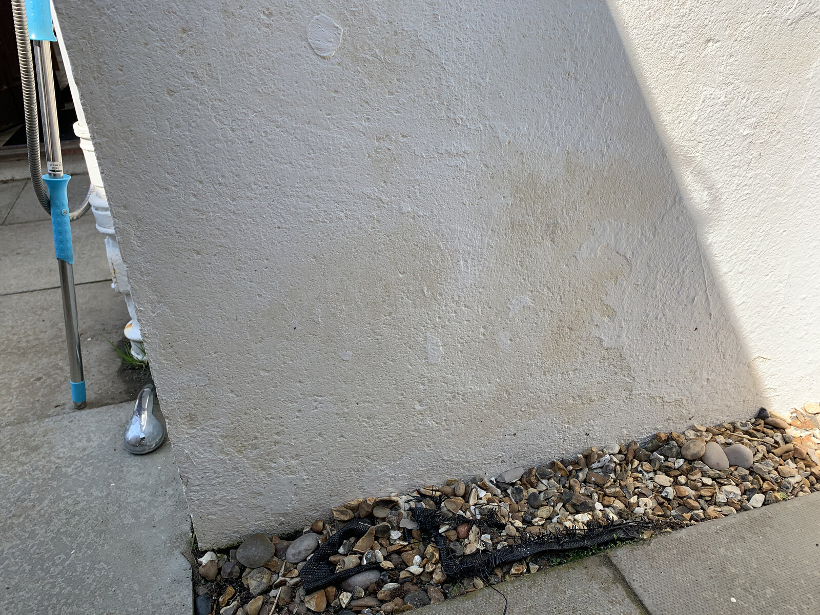

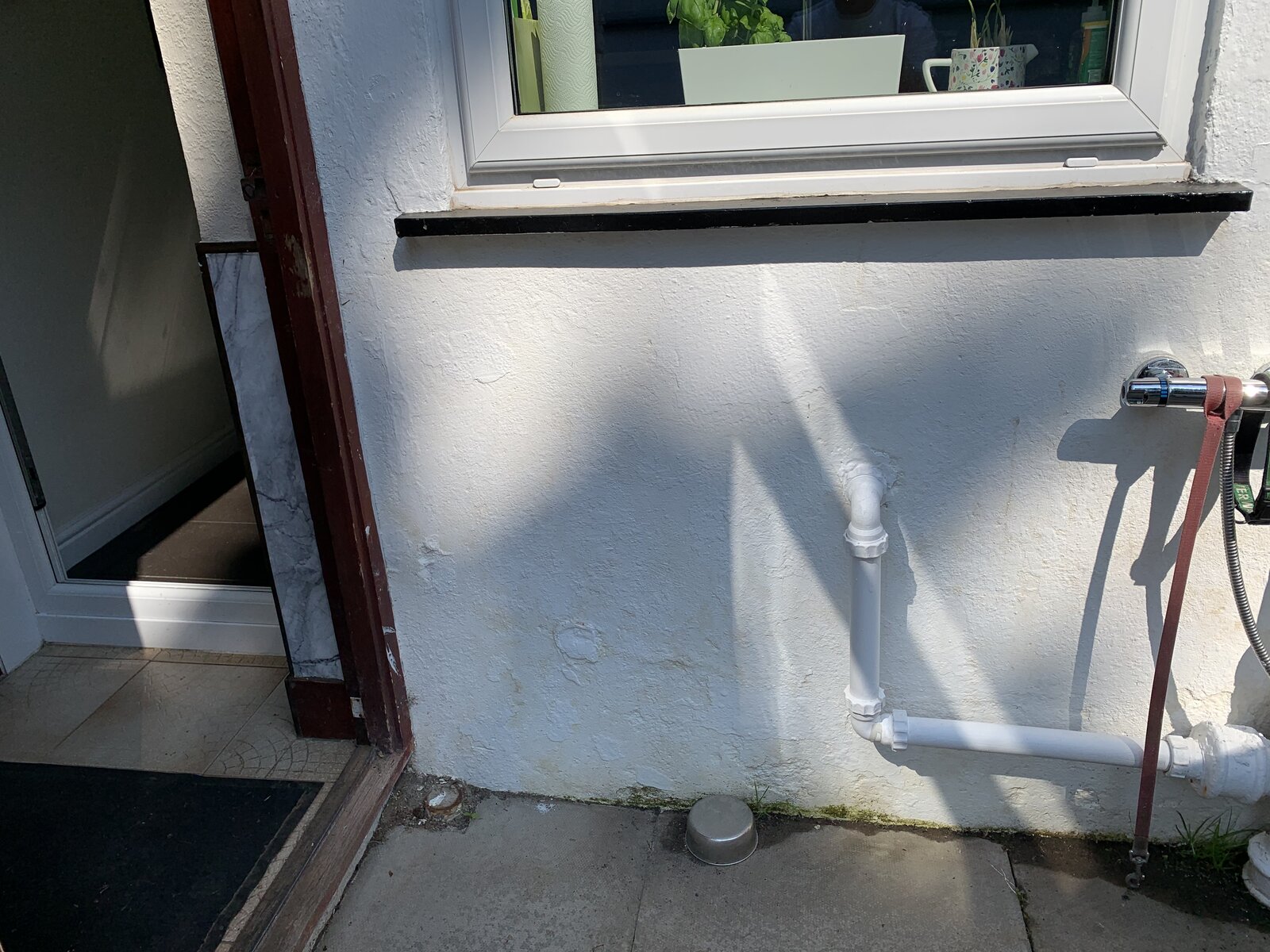

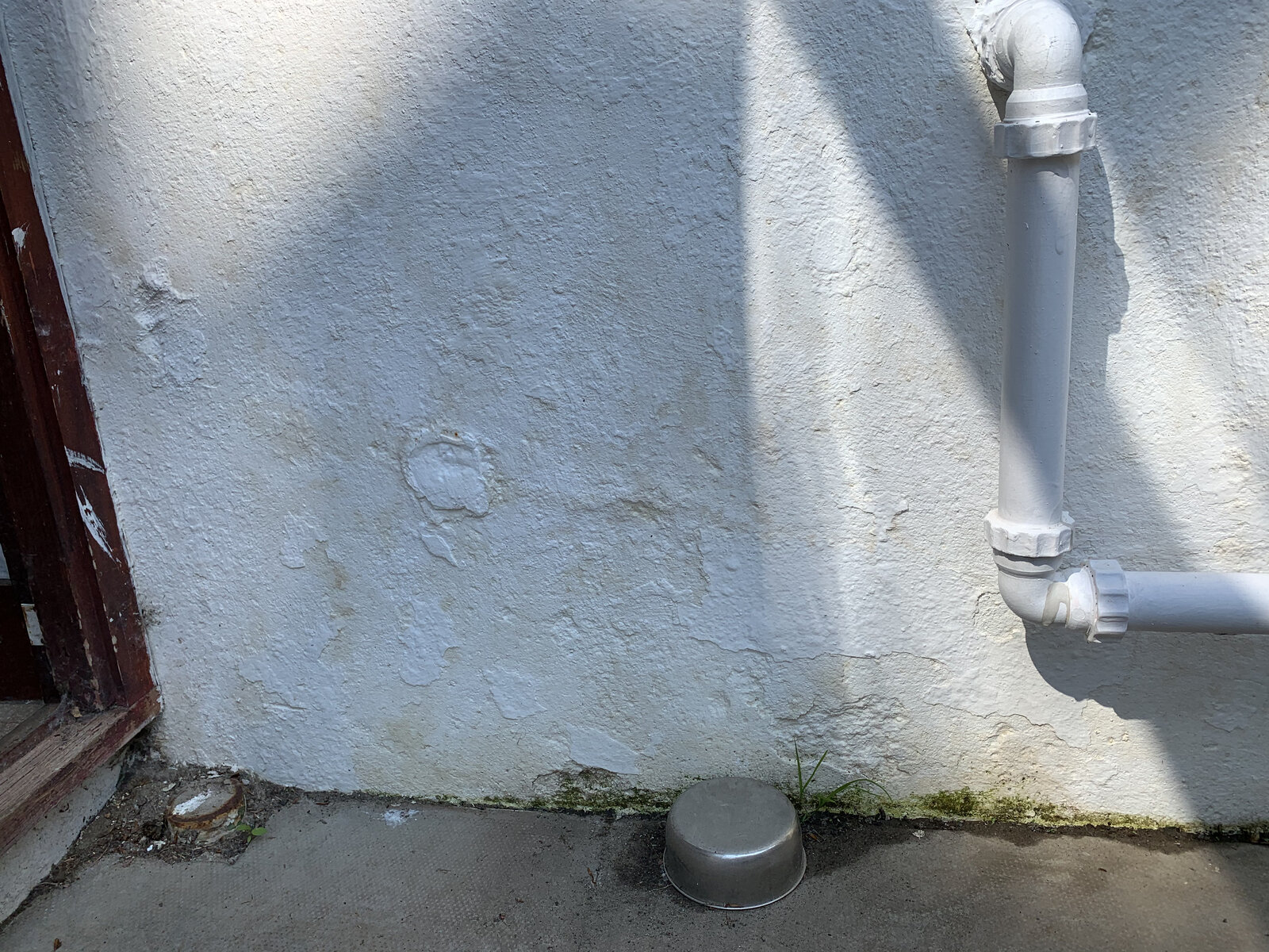

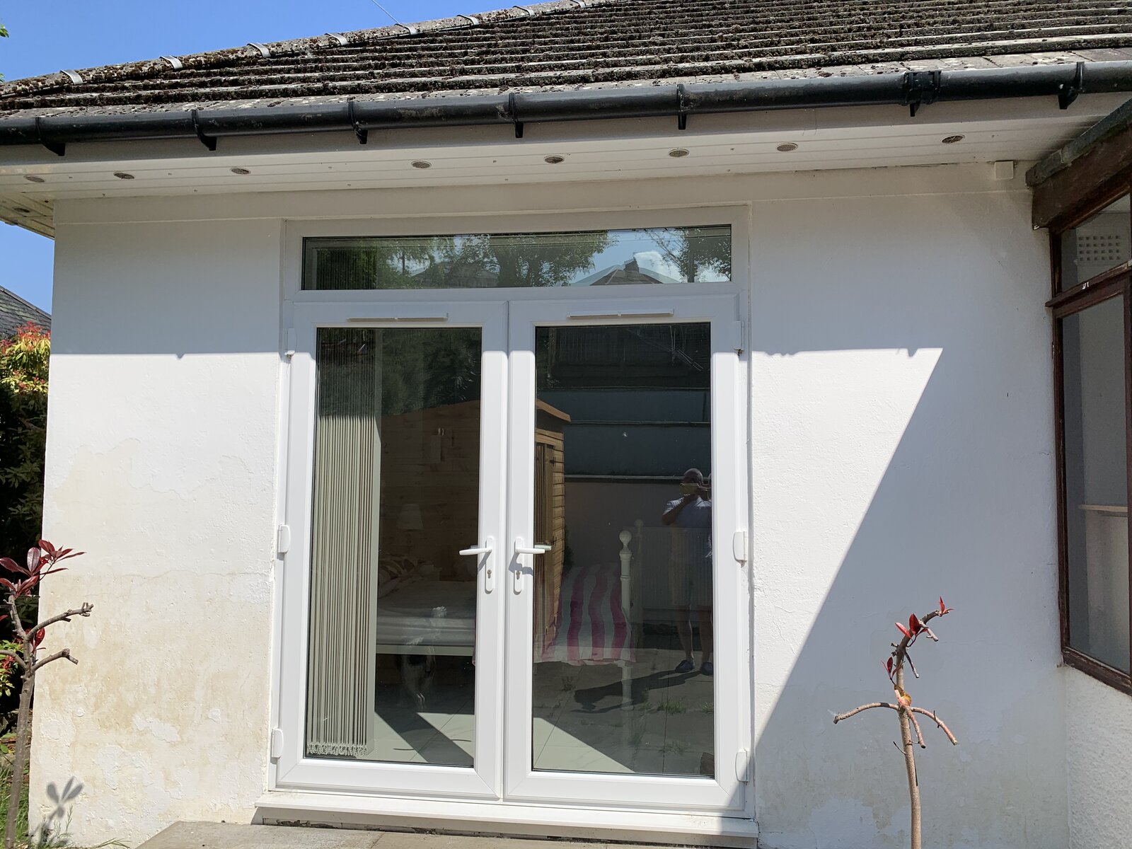

Hi guys, I'm looking for some advice re the existing cement render on my house which is a 1936 detached bungalow in Glasgow.
The render is in pretty good condition except that some of the top finish coat has deteriorated over the years and has flaked off so last summer I power washed the walls to remove the rest of the flaking top finish and painted the house but unfortunately the bare patches of render turned yellow so what we have now are large patches of yellow on all of the walls (photos below).
I would like to either have those patches repaired (if possible) or re-render the whole house (approx 100m2) with a smooth render like K-rend or similar but in the meantime I would like to re-paint the house (just to make it look acceptable) but I think I need to treat those yellow patches with something to stop that staining through to the new paint.

Im not an expert but it looks like may be damp or soil stain sucked up the wall but no expert as I say.
Thanks it may well be especially the areas round the doors at the back of the house but those yellow stains are high up on some of the other walls, the front of the house has about ten course of facing brick from the ground up to where the cement render starts.
Its the yellow sand of the render showing through. Did you use a masonry primer + undercoat or just slap white paint straight on?

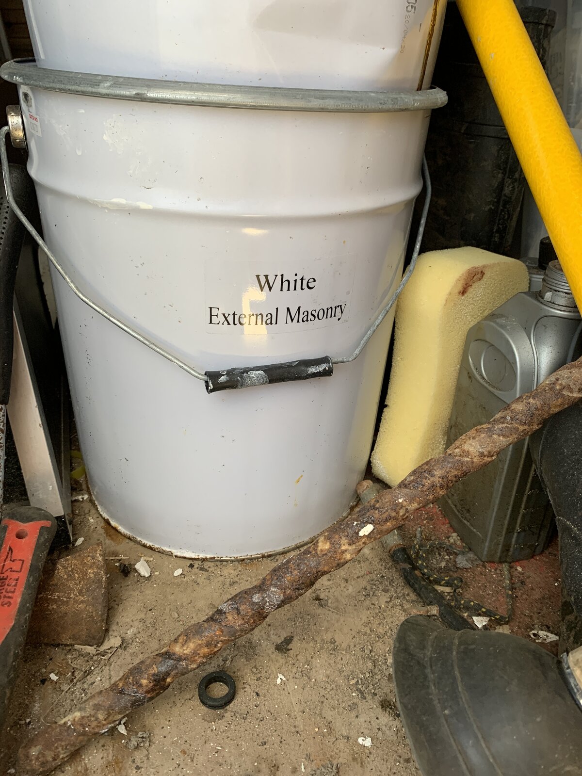

Hi @sxturbo, just wondering if I can water down the existing masonry paint to use as an undercoat?
I bought a couple of 20 litre drums last summer and have a load left.
I intend to just do the short walls at the French doors as a test before I do the whole house.
The masonry paint I have is below.
Think it's Paint master masonary paint, I bought it locally, unbranded though.
Stabilizing solution evens out the background making for a better overall finish, if water based has that paint been stored completely frost free?
Hi thanks @lostinthelight, yes the paint has been stored inside.
Would this below be suitable for priming/stabilizing?
Also can I water down the masonry paint and use that as an undercoat?
Providing the paint is okay of course.
I've not opened the drum yet so it might well be off.
