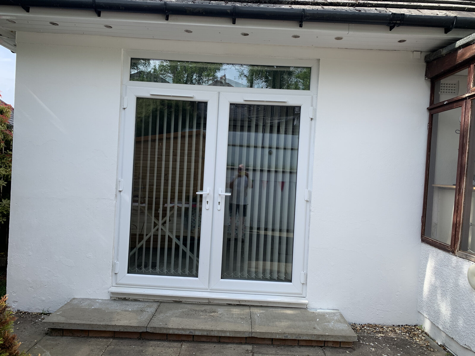

Thanks guys, I’ve picked up five litre of the stabiliser and painted it on the wall at the french doors and at the back door but only on the yellow patches.
This part of the house walls are the worst.
I’ll get a coat of the masonry paint on tomorrow, the paint seems fine btw.
I’ll update the thread and stick up some pictures too, some parts of the walls are in a bit of a state to be honest but the render is at least sound.

Imo you need to do it all so it doesn't dry patchy
The top coat ,that is.
Aye I’m going to do two coats on the entire wall but I’ve only stabilised the patches, didn’t think there was any point stabilising all of the wall as the existing paint where there isn’t any patches is absolutely fine so I’ve painted the patches with stabiliser and then two coats of masonry paint on the entire wall.
I’ll be honest though the back wall that I’m re-doing at the moment probably needs re-rendered.
I really can’t see anyone making a decent job of re-applying a finish top coat at the patches to match the rest the wall, maybe a decent plasterer/roughcaster could but I’d only be buying some time I think.

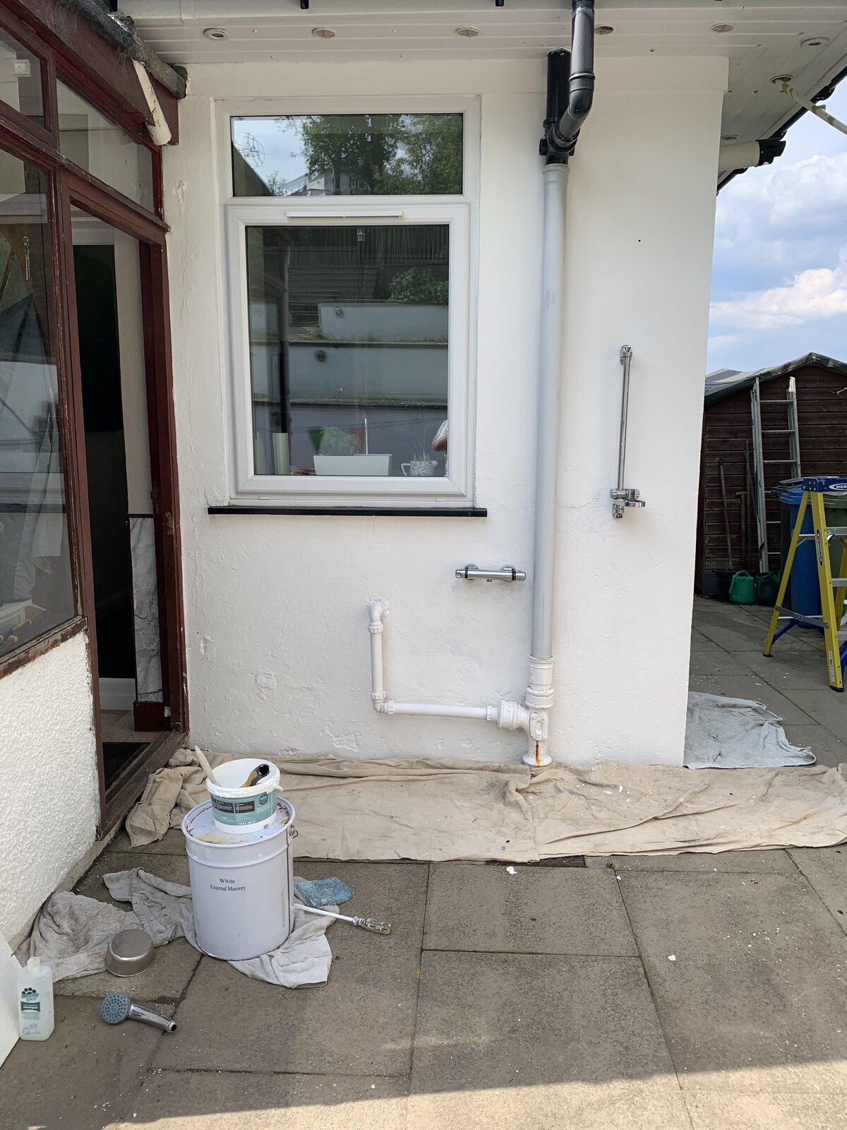

A little update guys.
I painted the back wall today, I gave it three coats of paint as I’ve plenty but it’s looking excellent.
I’ll know for sure tomorrow though but provided there’s no reappearance of the yellow patches then I’ll carry on with the rest of the walls.
