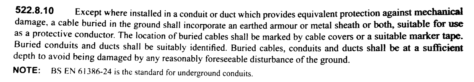

BAS, why do you choose to deliberately misinterpret 522.8.10 that says - Except where installed in a conduit or duct..........cables shall incorporate an earthed armour sheath.
I am not deliberately misinterpreting 522.8.10. Are you deliberately misrepresenting what it says by omitting part of the requirement in that quote?
I do not agree that PVC conduit complies with the requirement for mechanical protection.

Plastic conduit with non-armoured cable does not comply.
Plastic is in no way equivalent to metallic armour.
Highly doubtful the rest of 522.8.10 was followed either.
Agreed but, as I wrote, if the 'equivalent' does, indeed refer to the rest of the sentence, what about "equivalent (mechanical protection) to that provided by an earthed metal sheath"? I'm pretty sure I could find you some cables with earthed metal sheaths (not armour) that provide less mechanical protection to the cores than would many/most plastic conduits, don't you agree? Since it seems odd that the regs would be intended to be interpreted in that way, I suspect that it may be another example of a poorly/badly worded reg!
I would have thought that 450mm deep and under a patio would probably satisfy the last sentence, but I agree that the OP may omit the marker tape.
But would those cables be suitable for direct burial?
For what it is worth DNOs seem to be happy with using concentric cable with no armouring, preferable run through ducting but also they seem happy for it to be buried without ducting in some places.
Although the concentric outer layer is usually combined earth and neutral.
522.8.10 seems to say that they (at least some of them) are - otherwise it would presumably not offer that as one of the two acceptable options for cables which are not installed in a conduit or duct. Unless I'm missing it, I see nothing in the regs which requires that a buried cable (whether underground or in a wall) has to provide any significant mechanical protection if it has an earthed outer covering.
Kind Regards, John
I'm sure there is a reg somewhere about cables having to be suitable for the environment where they are used.
Would you bury BS8436 cable directly in the ground and then claim that you had exercised reasonable skill and care etc?
