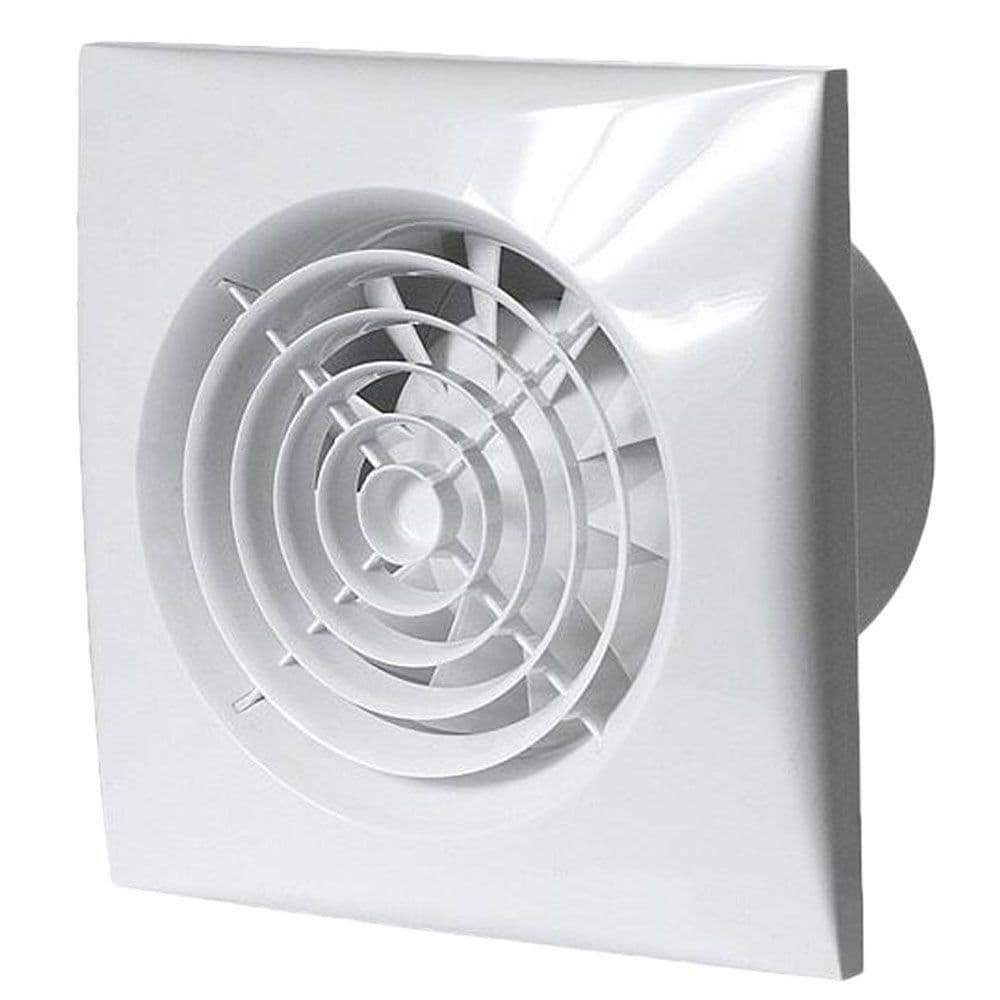

The Silent Tornado ones were the ones I was originally looking at as they seem to have very good reviews:
Does that mean I need to look for something else or is there a way (electrically) that I might be able to force the humidistat version to run when I want it to?
Of the ones that retailer offers, I think the Envirovent are the best quality.

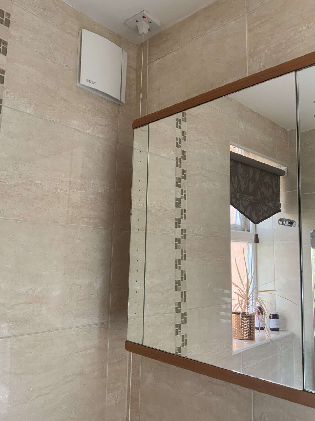

With ours, it is wired to a permanent live as it should be. When it senses humidity, it comes on and stays on until the humidity has decreased. I have a separate pull switch for the switched live (that normally would come from the light) for a manual override - I just turn it on then off again and it runs for as long as the timer is set.
I did not have it connected to the light as I did not want it coming on and running on the timer whenever anyone turned the bathroom light on in the middle of the night for a wee or if anyone turned the light on in the evening for a wee and it blows all the warm air in the bathroom out the vent.

They also do a 150mm (six inch) version that is more powerful (also branded as Soler & Palau, same company)
You don't need the 12v version.

It is this make but the model may have changed slightly - we bought it about 15-20 years ago. I don’t think ours has the 12v ecowatt. The longest overrun will prevail. I.e. it won’t switch off on the timer if there is still humidity present above what it has been set to. You can adjust both the timer and the humidity settings.
I have the pull switch in reach of the toilet!
