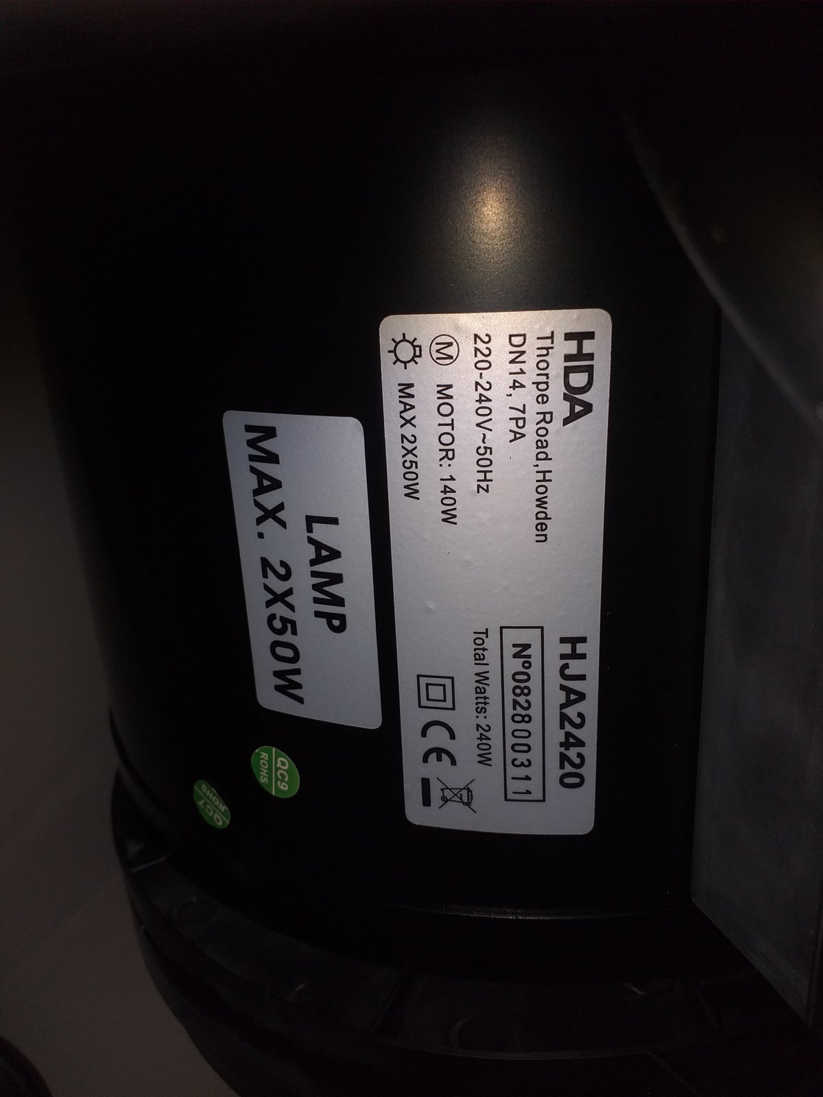

I called the company from sticker on fan. They said my local supplier address. I called their engineer. He said it would cost £140 just for motor and £170 for whole unit and he suggested replacing the whole unit. Shall just buy this and fit myself?

I have been pleased with Elica extractor hoods. But email and ask for their glossy brochure as the website is awful to navigate. Look at noise in db, and extraction rate in cubic metres per hour. There may be other good makes

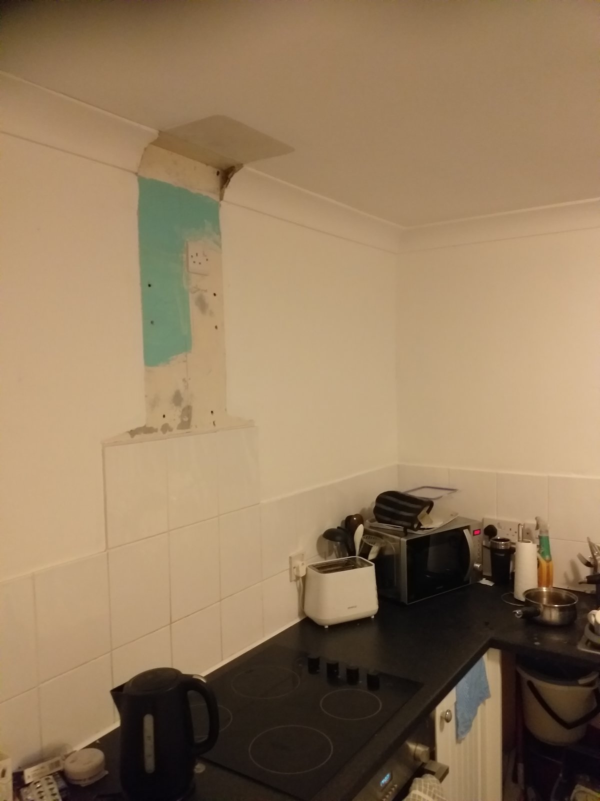

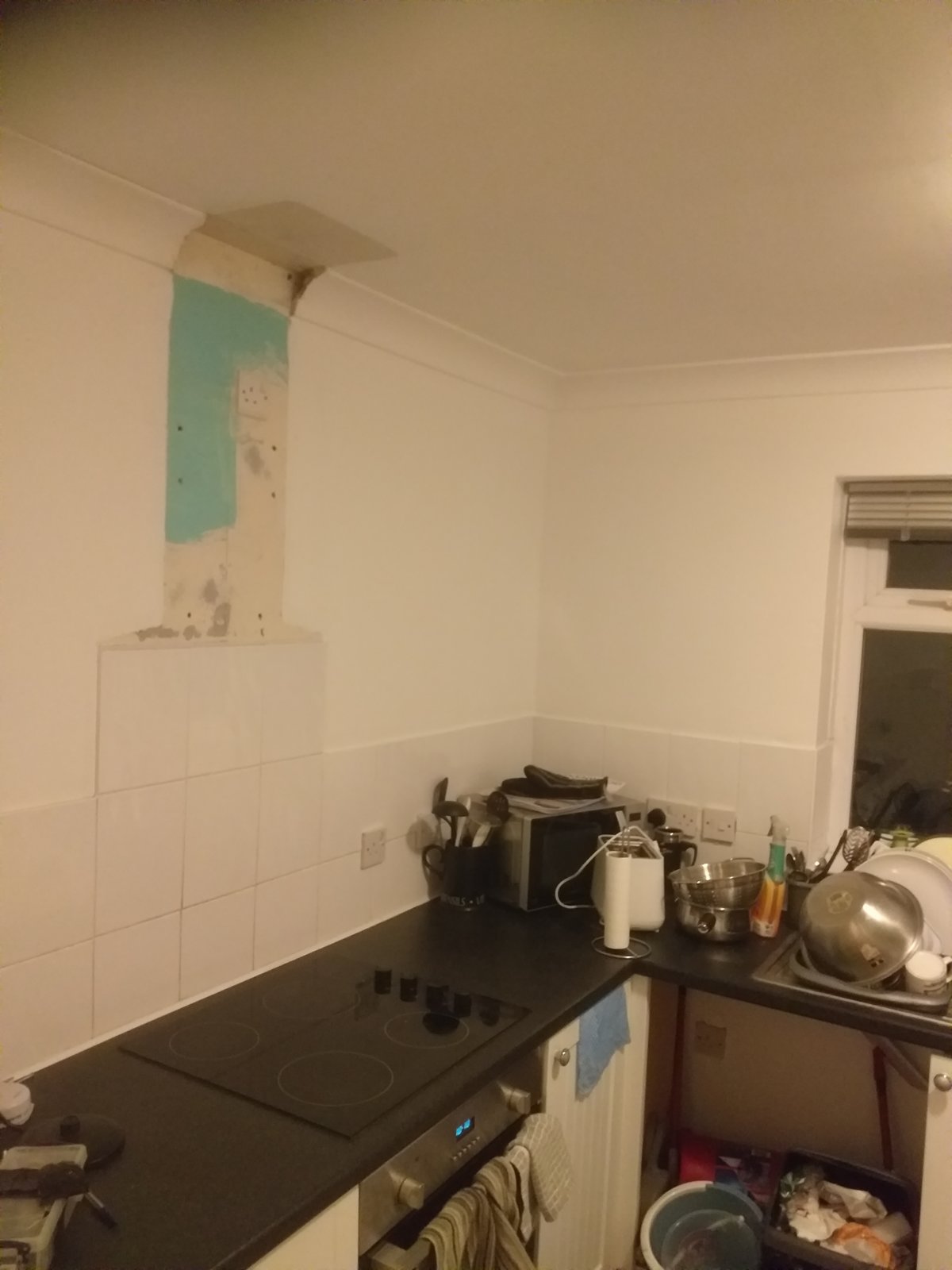

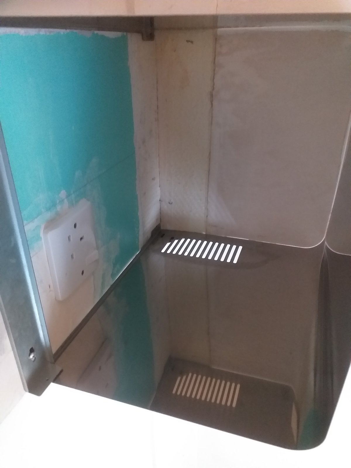

Just taken extractor down. Shouldnt there be a pipe going from it to the ceiling? There's no hole in the ceiling or wall. What's going on?
I called Elica and they said their fans use only 6 inch pipes to take out the fumes.
It's been used as a recirculating extractor only.
There should be a carbon filter fitted in it which removes the smells has this ever been changed?
Nah. To be honest I just saw the metal mesh thing and inside the motor. Dont know if there was one of those

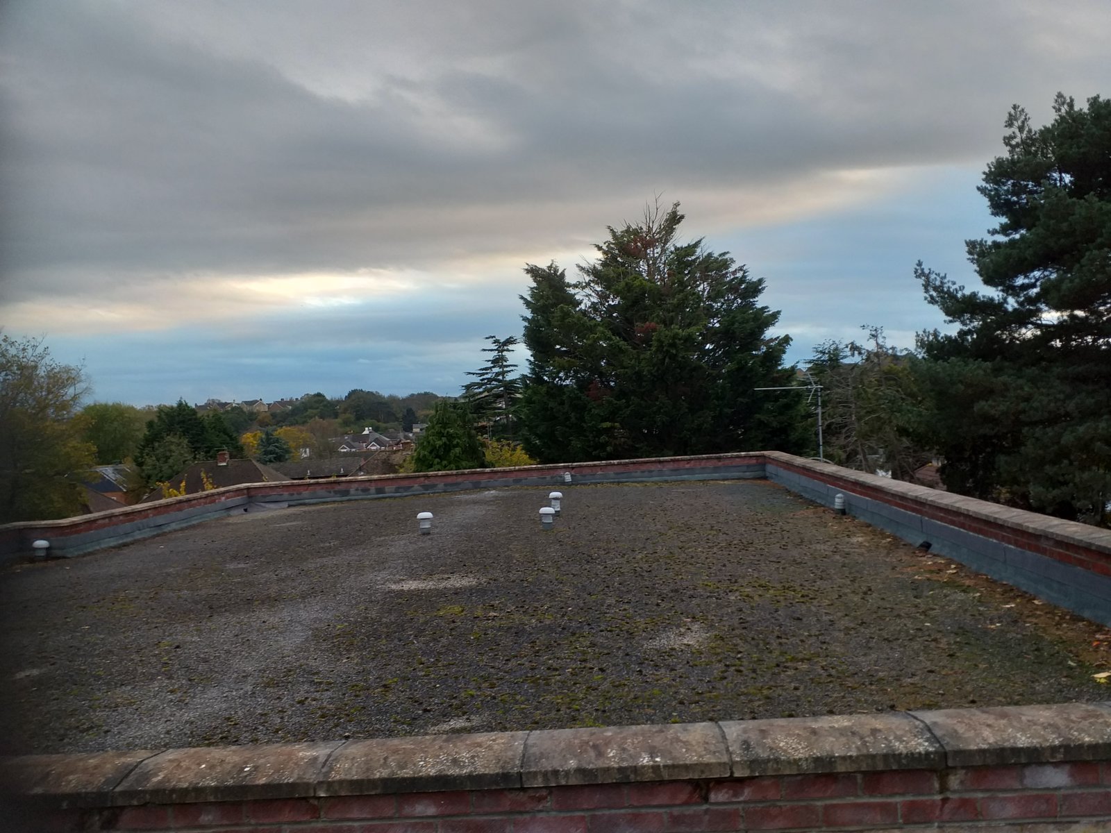

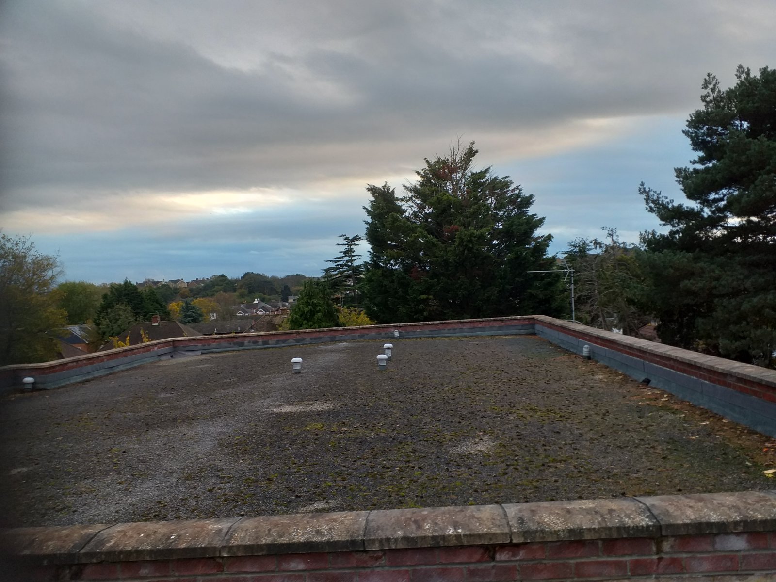

Been onto the property management people to get s duct hole fitted. Preferably through roof if not wall.
I guess it would best to take the duct out the roof. In top floor of flats with flat roof. If not take it out of wall next to window. Ive got number of a gut with a 6 inch drill bit. Should I box it in if I do that?
If you are leasehold you may find that the freeholder doesn't want you punching holes through the roof or wall.
Roof would certainly be the better way to hide the pipe and not have any boxing in.

Well I'm not allowed to go through ceiling so I'll have to run the duct along the top to the wall on same side as window and get a hole drilled there. I could box the ducting in. Is it worth it? Will it look crap and put people off when I sell it? Or get another one which recirculated the air?
If you go for a box in then because you have coving it's going to stick out a mile and look crap , you may have to remove all your coving to disguise it.
What is the other side of the wall the fan is on?
I personally would stick with a recirculating fan , not ideal I know
I observe that it's in a kitchen.
Fit some kitchen wall cabinets and nobody will see the duct.
