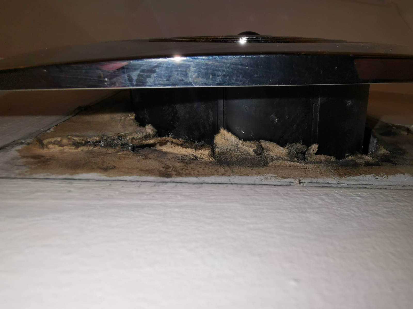

guys,
After complaining that the job was incomplete, I received this email from the contractor…
1. The dirt on the wall is left by your previous extractor fan and it is the work of the painter to paint the wall.
2. Your previous extractor fan is an old model which we couldn't find in the market and that is why we have to install this one.
3. Electrician tried to push the extractor fan inside the wall but the hole is not big enough and we will have to use the hammer which will make a mess on your wall and more work will have to be done which is plaster and repainting.
4. We have fixed these extractor fans in many houses and it is just an inch outside the wall but if you see the pictures taken by our electrician there is no issue in it
Is there anything reasonable in the response or am I correct in refusing to pay until the job is done to my satisfaction? To add the electrician had previously visited the site to ascertain the correct parts.
thanks,
Steve.

Then I'd say it's a completely inappropriate replacement unit. I'd have ibeen looking for an in-line fan, and not a wall fan. Certainly didn't need the additional cost of a chrome finish.

Refuse to pay until it is fitted correctly, which basically means both sides of the fan should be fitted flush against the wall surfaces with a sealed connecting tube, (ducting), between them. If it's not in the contract then they don't have to make good the decor but they certainly should make good any damaged plasterwork.
It may be the Fan they have fitted has a long Spigot at the back ,& as a result it doesn’t fit flush , others don’t do get the Co to replace it with another Brand with a small spigot / rear section
Phil
Do NOT pay them a penny.
In this situation, the simplest solution is to fit a piece of wood or plastic between the wall and the fan.
When they discovered the fan would not go back to the wall, they should have arranged with you or themselves to fabricate something to go between the wall and fan.
They clearly did not do this.
So, it was a complete waste of time fitting the fan, because it now needs to be removed to fit the wood/plastic.
And then the fan will need fitting again.
So NO. Do NOT pay them because it shouldn't have been fitted until the wood/plastic was fitted.
Anyone who leaves a fan like that without the agreement of the customer is a chancer.
Anyone who leaves a fan like that without the agreement of the customer is a chancerNOT A PROFESSIONAL OR CRAFTESMAN.

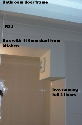

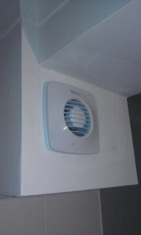

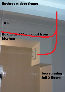

Just for the record, here's one I repaired earlier:
This is ground floor in 3 story block of flats
Full height in the Vertical box on the left are:
160mm soil stack,
2x ¾" cold feeds,
4x (maybe more) SWA,
110mm extract duct shown in red only down as far as shown.
So extremely conjested The original expelair fan was a big box unit surface mounted, Expelair Via the freholders managing agent recommended the fan shown as the nearest replacement, being on a communal duct, (upper floors also feed kitchen and bathroom into the duct) the fan has to include one way shutters, to prevent the other fans backflow, so quite deep.
When I first fitted it was proud of the white box and took probably 2 hours total to reconfigure duct to sit flush, patch plaster board, fill & paint.
That's the way to do a reasonable job.

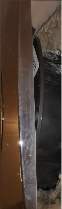

Looking at OP again I see the front isn't even fitted to the rear part correctly:
