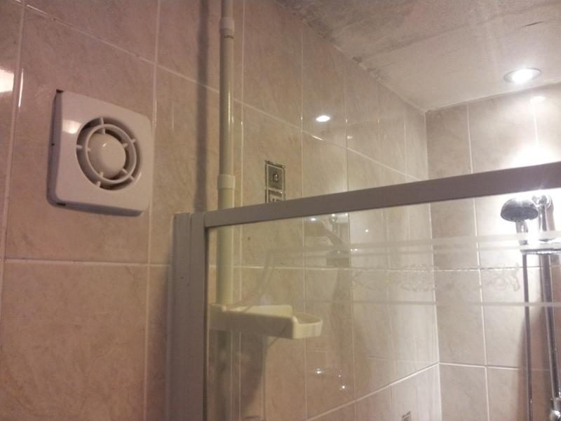

I have an extractor fan in a a shower room that is not clearing the condensation, the current extractor fan is too low down on the wall. I have set the overrun for as long as possible and cleaned out the fan. The shower room is on the first floor at the corner of the house with two exterior walls.
A builder has suggested fitting a fan with a humidistat higher up the wall and closer to the shower. However lots of people online seem to suggest just using a timer and setting it properly, is this recommended?
The room is ~9m3

The throughput of the fan may not be enough. Think about one with more grunt.
Also, don't forget that you have a 100mm dia hole through your wall.
You must let at least an equivalent amount of air into the room, or the fan will just be trying to make a vacuum.

Yes, but the fan is too low to get the humid air. The builder is thinking about putting a fan on the wall close to the ceiling and closer to the shower.
The shower room window on the other wall has been fully open and there is a 10mm gap under the shower room door.

Well, I was assuming you have excessive condensation but I suppose it is relative.
Is that mold on the ceiling and the surface flaking?
If so then it is likely to be more than condensation from the shower.
There may be a leak leading to permanent moisture somewhere or the rest of the house is excessively humid leading to constant condensation in the cooler shower room.
That is mould, it is just underneath that patch that the builder has suggested installing a new fan . There are no leaks what level of humidity is normal in the house?
Is the loft above?
If so, is it really cold along that side? Rain blowing in?
How long does the condensation take to clear after a shower?
Do you wipe up the condensation in the shower room and leave the sopping cloth there?
The other wall - by the warm light - looks better.

Temperature of the room has as much to do with condensation as the amount of moisture in the air. My office where I am typing this is 22.5°C at 48% humidity outside 10°C at 95% humidity. So any surface in the office at 12°C or lower will get wet and any where outside a 8.9°C will get wet that is the dew point.
So there comes a point where simply pumping more air just makes the room cooler and gets the walls below the dew point.
Capturing some of the heat leaving and transferring it into the fresh air in the room will help keep the room warmer. Also ensuring the replacement air is as dry as it can be to start with.

If you want a more powerful fan, try a centrifugal fan. I have one, it is very powerful, but sits bigger on the wall than yours (but will cover the poor tiling). They are louder though, don't wire it in with the light or you'll be waking everyone up during the night.
However, unless you fit a couple of these:
At either end of the room, one sucking and one blowing, you'll always get a bit of condensation on tiled walls. The one regret I have about when I refurbed my bathroom was that I didn't insulate the walls. I even had all the plaster off the walls. Just boarded and tiled. This is the main thing you can do to reduce condensation.

The ceiling is papered, so I'm wondering if a solution could be to get a more powerful extractor fan, and then plaster the ceiling and paint it with some mould resistant paint designed for kitchen or bathroom use.
Does the placement of the fan really affect it's ability to get rid of the humid air?

At the end of the day it is simple physics, and no amount of fiddling with insulation, special paints etc will do anything about the fact that breathing, cooking, washing etc all put water vapour into the air. Unless you want to stop breathing, cooking, washing etc you have to take the moist air out of the house and replace it with dry air, or all that water vapour will make an appearance somewhere - it has to.
I doubt it, as long as it's powerful enough. If you're worried that that might be a problem with yours, get some joss sticks and see if it drags smoke down from the ceiling.

Maybe I should try that first, although it's starting to bubble in areas. With the amount of other work we want to do around the house I wouldn't mind a temporary solution for the shower room.
So I will try the joss sticks to see if it can pull the smoke from the ceiling, but it looks like the thing to do is replace the extractor fan with a better one and paint the ceiling.
What about extracting through the ceiling, with a fan in the loft?
Free of the constraints of an in-wall one you could put a large powerful one up there.
