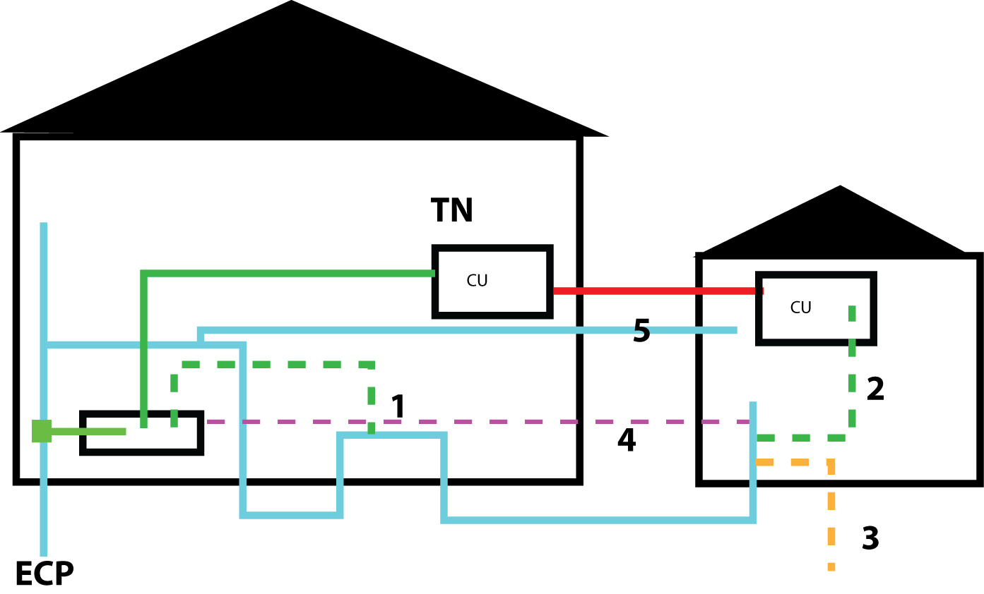

A metal water pipe enters the building , Its a Extraneous Conductive part (ECP) so needs Main protective bonding to the MET.
That same pipe, has a branch off it which then goes back under the floor (buried) and re appears in another room in the same house. (1) Does the second appearance of the pipe also need bonded back to the MET?
or would a supplementary bond be correct?
This pipe then goes back under ground to an out building which has a sub board powered from the main house.
This same pipe appears in the out building,
Should that pipe be protected by a supplementary bond (2) a TT earth (3) or A MPB (4)
Would it still be an Extraneous CP if it did not go under ground? (5)
Basically as it only travels through air, it can't pick up a potential?
and would that be a TT SPB or a MPB
Hope that makes some sense
Ok.
[hat same pipe, has a branch off it which then goes back under the floor (buried) and re appears in another room in the same house. (1) Does the second appearance of the pipe also need bonded back to the MET?
Not if it is connected satisfactorily to the other pipe and the MET.
It might need Supplementary Bonding if in a bathroom; otherwise not.
It will need MPB to the local earth bar.
As it is connected to the house MET it may be used AS the MPB to the house MET, so there isn't much point having TT in the outbuilding.
The electrode will just be another extraneous-c-p
Extraneous to the outbuilding yes, but once MPB to the outbuilding board is fitted it will then BE the MPB to the house MET.
1 - Yes, but that could be bonded by virtue of it being the same metal pipe is already connected elsewhere. Bonding conductors do not have to be green/yellow wires. Testing required to confirm.
2 - Bonding required.
Either to the consumer unit in the second building if it has it's own TT earth,
or connecting it to the MET in the main building and using the earth connection from there.
Whether items are extraneous or not is determined by testing - being in the air/ground or whatever isn't particularly relevant.
Am I getting this wrong
EFLI you say the pipe in the second location should be MPB to the local earth bar (CU in second building)?
But this pipe is already a protective bond between the two locations.
Basically this pipe could be seen as a green and yellow conductor between the two buildings.
as this pipe is a protective bond from the main house to the second building, so a separate connection does not need to be made from the second to first building
Is this suggesting that a second connection need to be made to the pipe in the second building back to the main MET?
Assuming the water pipe is continuous metal, it will be an extraneous-c-p to the outbuilding - both because it emerges from the ground elsewhere and it will become live with a fault in the house - therefore it must be Main Bonded to the OB CU.
Not until it is bonded to the OB CU.
After bonding to the OB CU, yes.
Correct. The pipe may - is allowed to be - the MPB.
No.
The usual reason for making an OB TT is to avoid having to have a large MPB back to the house, but you already have the pipe.
