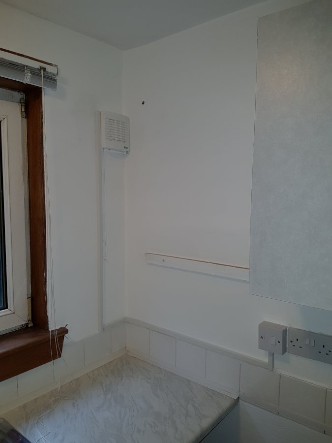

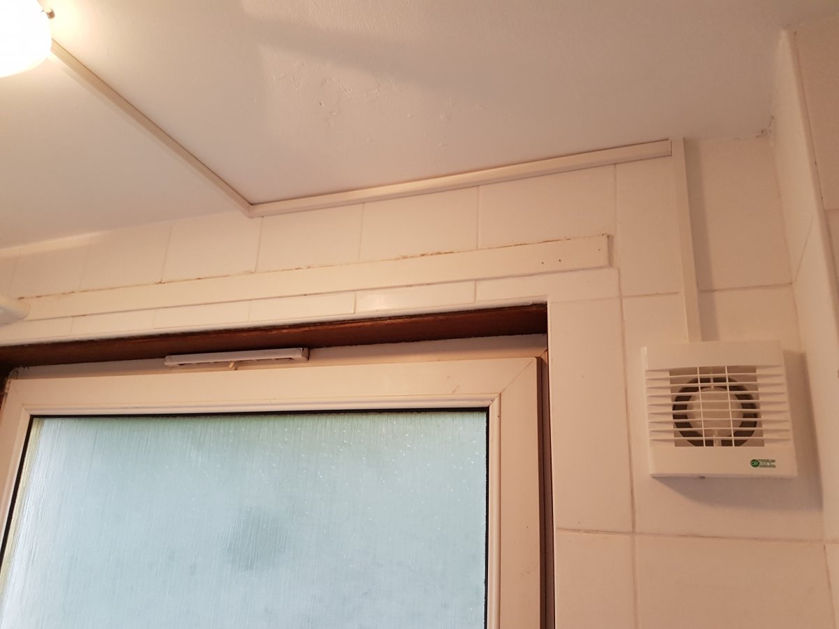

Went round to check out the work tonight.
He's used airvent extractor fans in the bathroom and kitchen. I tested the bathroom 1 out by putting the shower on and closing the window. The fan didn't seem to make that much difference to condensation levels.
Also the kitchen 1 is meant to be humidity based but the sparks fitted a switch which presumably will override the humidity sensors if the tenant can't be bothered switching it on?
Has he fitted low quality fans or is the 'airvent' brand standard quality?

He's charging me £1,350 for all the work and materials:
- 2 extractor fans fitted (with 1 hole cored in bathroom)
- 2 smoke detectors and 1 heat detector (BRK brand)
- New RCD unit (CPN/ CUDIS)
- Rewire of lights, cooker & water heater (see previous details above)
- EICR
- PAT tests
Am I being ripped off with what he's supplied?
