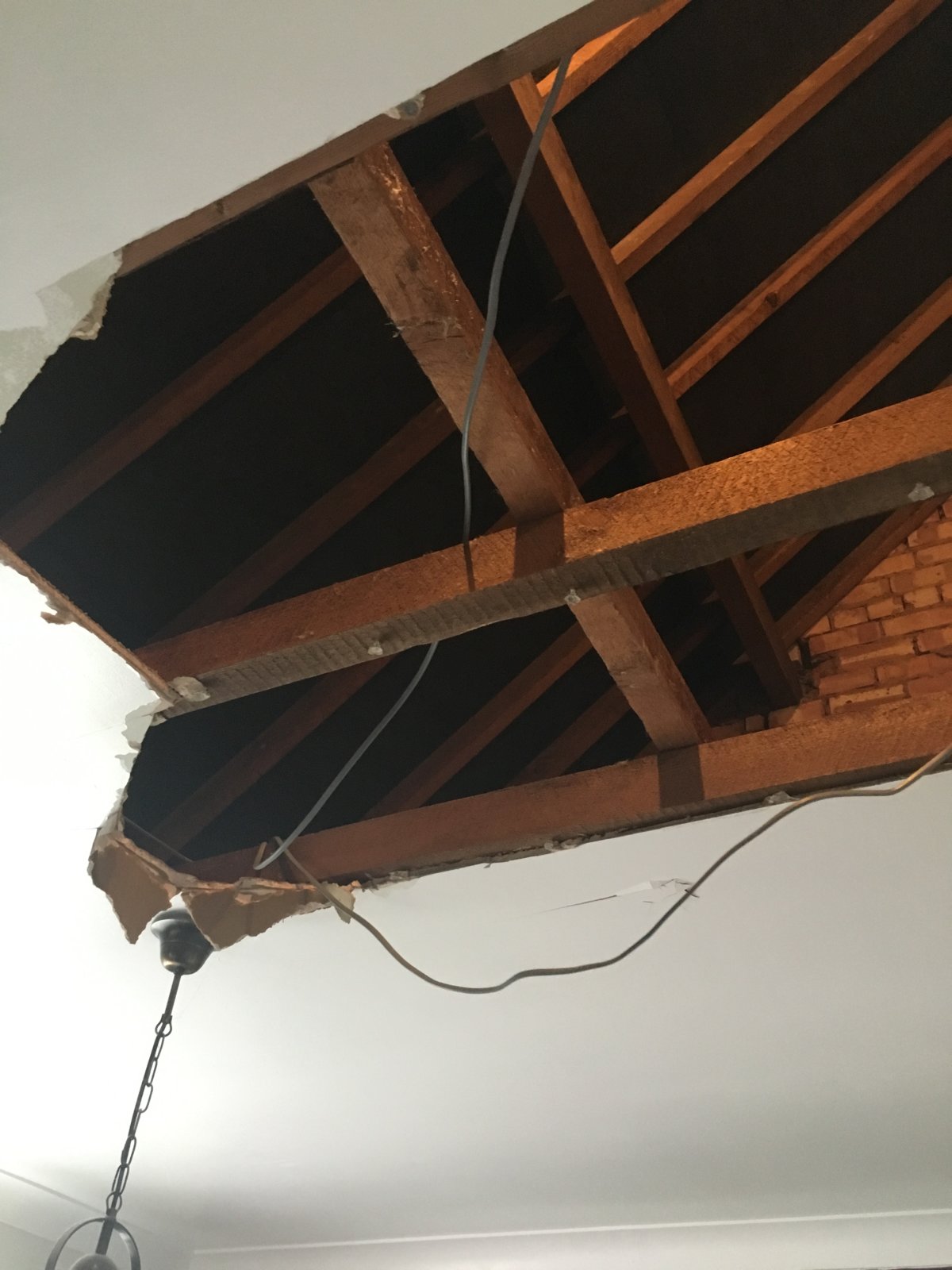

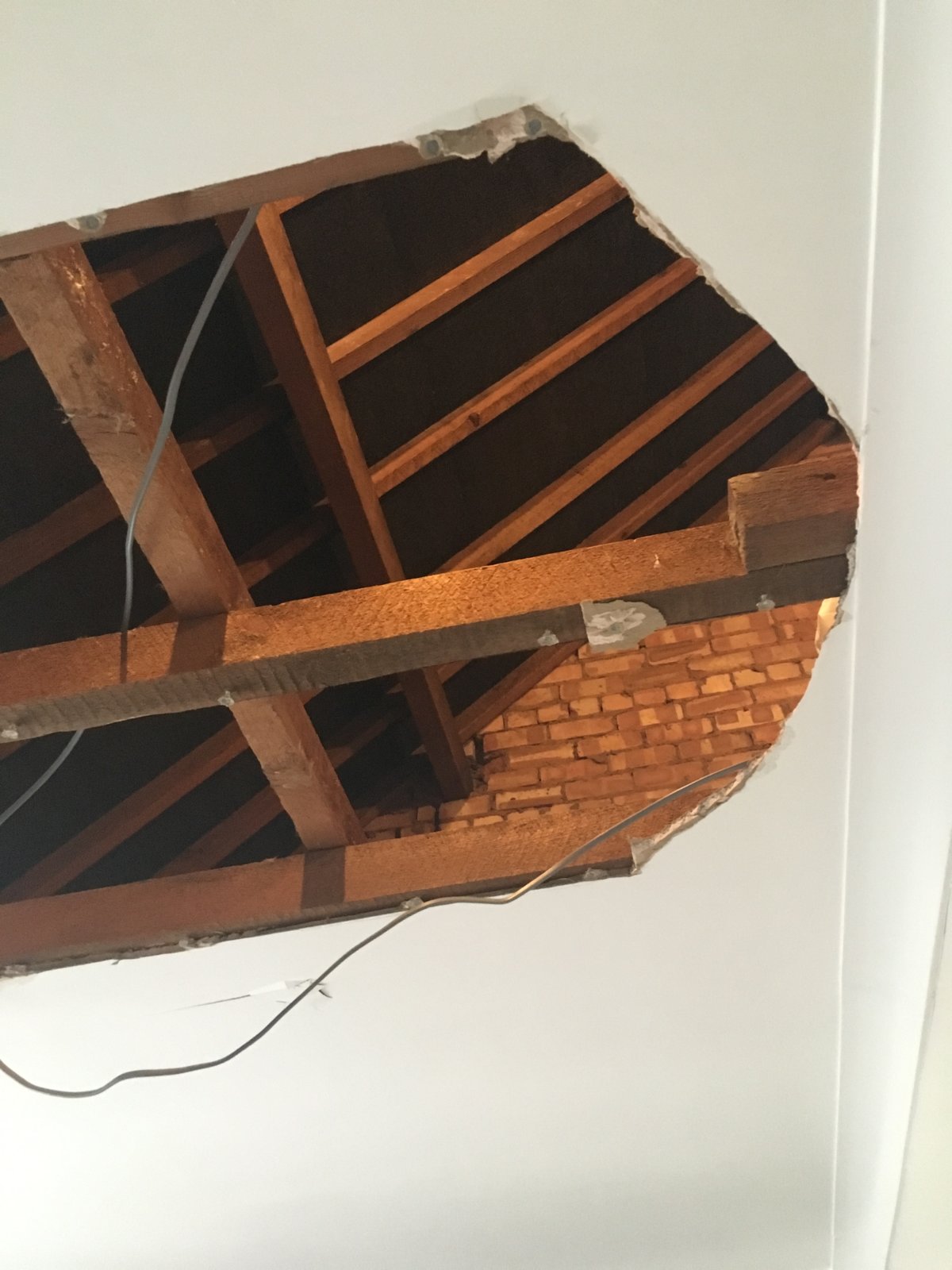

Yup it finally happened. Despite me being careful, using boards across the joists to move around, I stepped on a board too close to the edge, I slipped and fell through the ceiling. Managed to use the joists to stop me falling through completely.
Swmbo was up in the loft with me, she saw me fall and tried to grab me and unwittingly also stepping onto the plasterboard.
Feel free to laugh.
What's the best way forwards? Cut out and refit new plasterboard?
Reckon I would strip back to the edges of untouched boards and put a new section in.
Depends how good your plastering is as far as skimming goes.
I would fell inclined to tidy up the edges then get a plasterer in to patch and skim.

if it broke in a few large pieces, it's possible to put them back, like a jigsaw, using builders adhesive or nails, and rub filler into the cracks.
this will work better if the ceiling is not flat or smooth (e.g. artex)

I've got someone who can come in to do the plastering. I was going to square off the hole, fix some extra batons to where the new piece would go, measure and cit and fit the new plasterboard to the joists and batons with plasterboard screws and leave the rest up to the plasterer.
Sounds fair or silly?
Lots of big and small pieces. It was bad enough when I put my foot through but worse when the missus did the same - she took some plasterboard off the was next to the coving.
The whole thing was papered s over and then painted by the looks of things.
