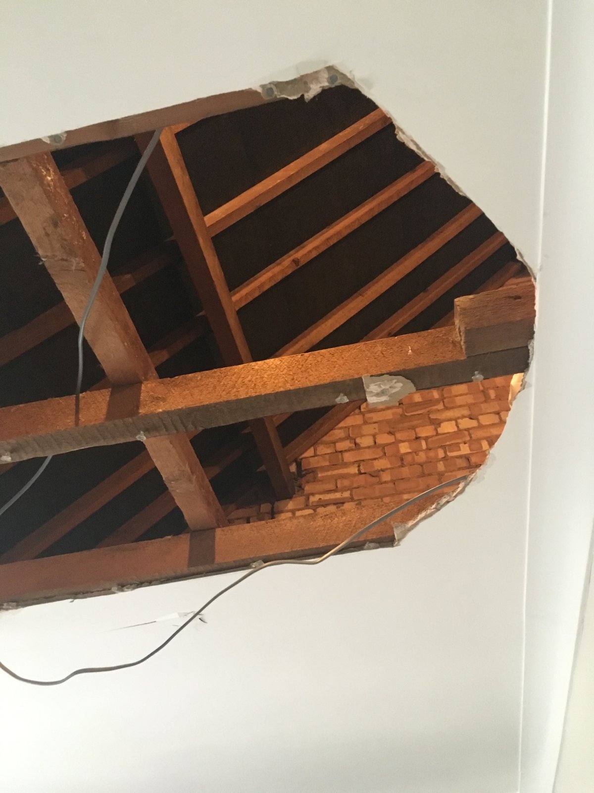

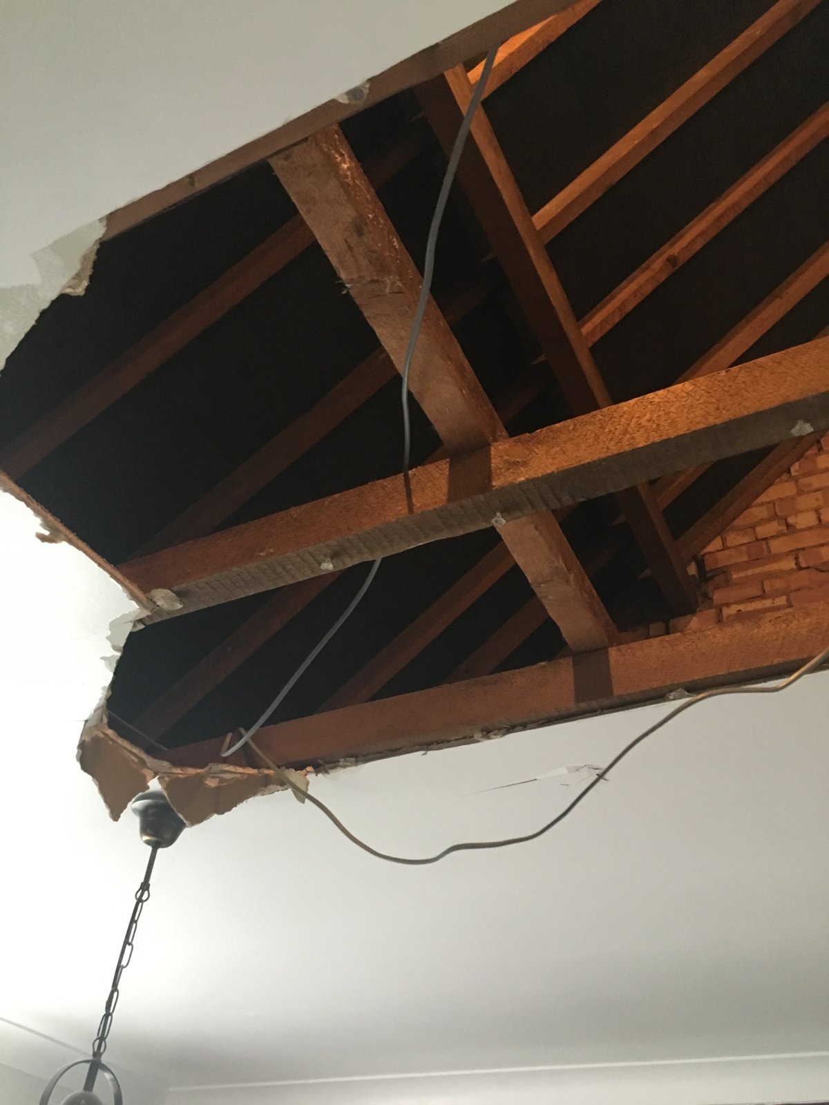

With the above poster - new loft hatches! Otherwise cut to mid joist / remove boards. New boards in / part boards in. Tape seams/joins and then with a new ceiling intact - although not pretty you can hunt for an elusive small job plasterer... Or wait until you have more plastering that needs doing?
I would also wait until you've done whatever you were doing in the loft above other rooms before calling them...
