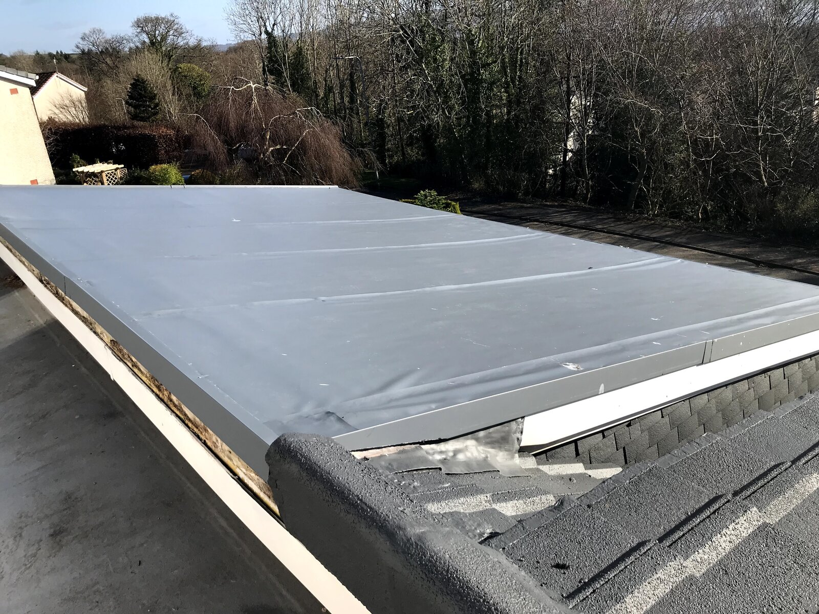

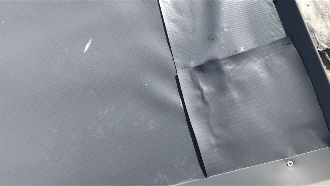

Hello. Hoping for some advice with our recent roof woes. Have 2 low pitched roofs, 1 of which started letting in water and at the advice of the roofer we got, we allowed him to remove all the concrete tiles and replace with Fatra rubber.
Initially he says he has just aimed to get us water tight, which he has, but the job looks really shoddy.... trims not mitered, seals not finished, screws exposed, trims cut too short, rubber not extending right up and over the edges etc....
There is even a patch in one corner and it all just looks amateur....
Its been 3 weeks now since it was done and he hasnt been back as is "really busy" so now I am getting to the stage that I want to get someone else to fix / finish it....
It was not adhered to the 18mm ply under it either so is just resting on the white felt stuff and sealed down round the edges to the trims.... he says the roof needs to breath so not sticking it down....
Anyone that knows this roofing system offer a view? I've watch the install vids and nothing looks right about our job so far :(

Nope and if he does that the original layer will still not be fully adhered to the surface. Tell him you want the layer removed and installed properly
So does that difference mean it doesnt 100% have to be fully adhesed down onto the surface below all over?
it should be in this case..
The seams should be hot air welded. maybe they are planning on a strip over the joints ..

It seems more like a single ply membrane than EPDM.
It says it's done with licensed contractors - if so, I'd ring fatra and ask their opinion - they will take a dim view of cowboys using their gear.
if its fatra there are several different systems some are fully adhered some are mechanically fixed but all external trims work on a trap and strap system ie the trim fixes the main fabric down then a strip of material goes over the the joint i personally use the mech fixed system as i prefer it i agree that it looks a bit rough but is it leaking ? he said it was temp till he could come back and its not finished give the guy a chance
